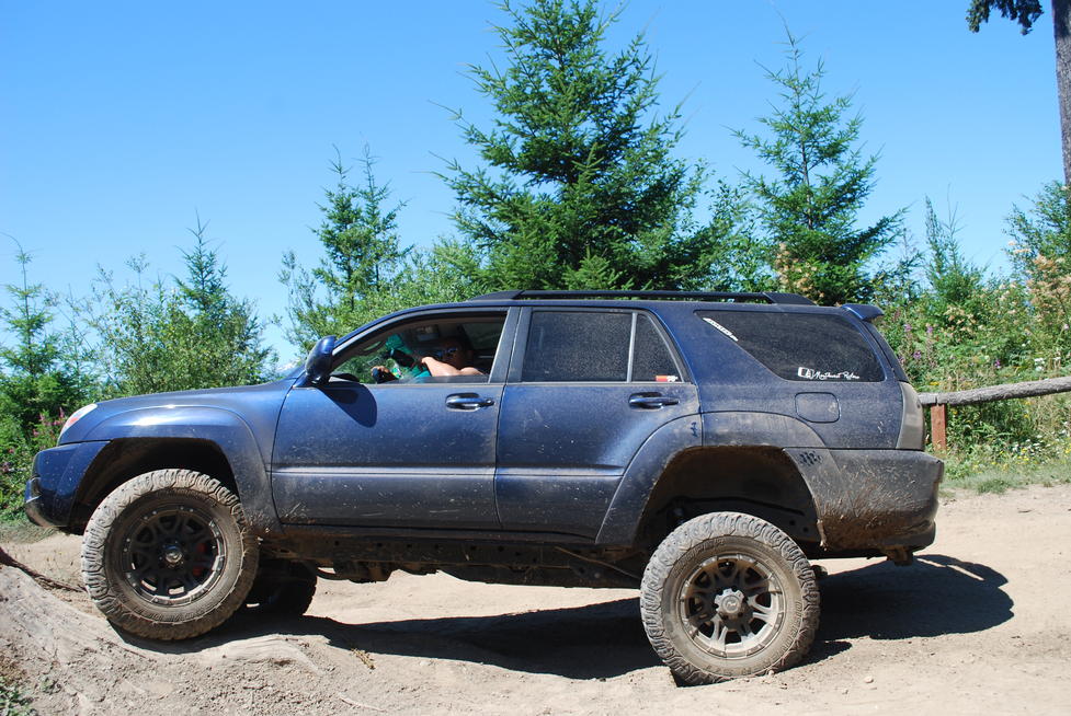

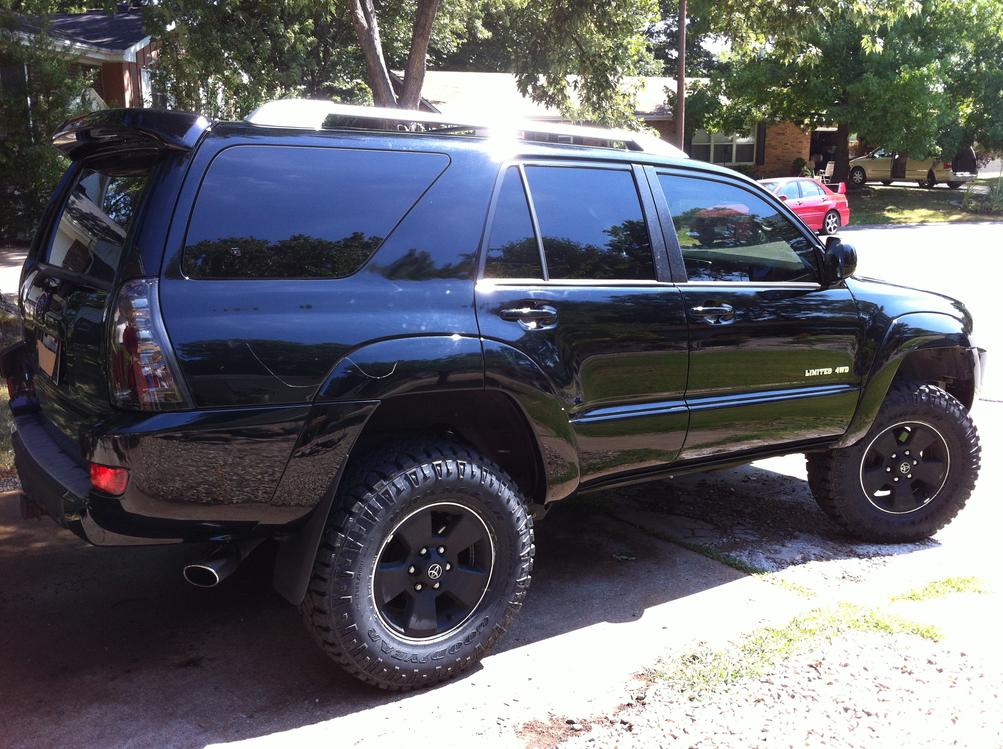

Back when I had 285/70/17's No BL, No body mount chop, minimal trimming approx 3.5 " lift at the time

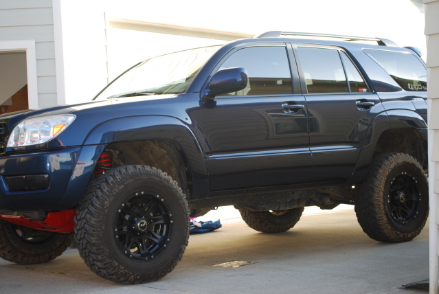

Same ToyTec lift as what you have. Zstampe helped me with my tire size! 285/70/r17
