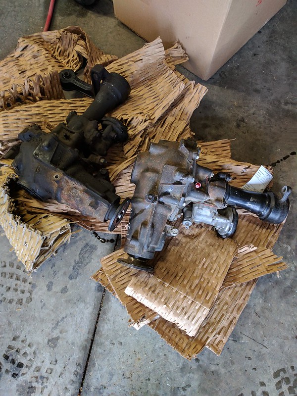

Front Differential
We got an excellent deal on the 4Runner, and it soon became apparent why. The front differential was almost completely seized when 4WD was engaged. This explains the bald front tires I suppose? The previous owner(s) had installed a factory e-locker rear end in it, putting the gear ratio in the rear at 4.30. I never had a chance to verify, but I'm certain that the front differential was probably never swapped to match the rear. I picked up a used front differential with 4.30 gears out of a limited 4Runner and swapped it out shortly after purchasing. Look at how freaking burned the old diff is!! It's like there was zero oil in it!
Passenger wheel bearing/seals

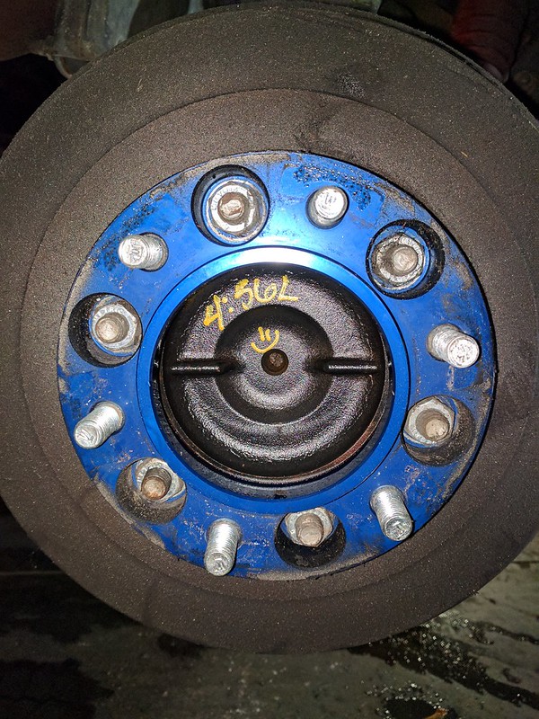

After the front differential was replaced, it became apparent that the passenger rear axle wheel bearing was destroyed. There was clunking and grinding coming from the axle. After I pulled the brakes off, I found this lovely note scribbled on the rear axle hub. Remember how I said that I had figured out the rear's gear ratio was 4.30, so that's the front diff ratio that I ordered and installed? I about had a heart attack when I saw this:
I did yet another spin test to be sure I hadn't screwed up. The front and rear aren't mismatched! The junkyard just mislabeled the rear axle. Lol.

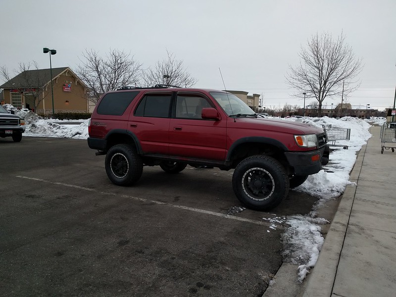

Tacoma front bumper
The truck was in a minor front-end accident before we bought it, causing the front bumper and core support to bend inward. We replaced the front bumper with my buddy's old Tacoma bumper that he wasn't using. It doesn't fit perfectly, but you can't beat free-ninety-nine!

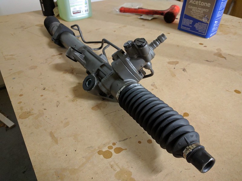

Steering Rack
After installing the tires, Point S told us that the steering rack was shot and they weren't able to do an alignment. I promptly ordered a remanufactured rack with inner/outer tie rod ends from Amazon and was really pleased with them. The truck aligned just fine after that.

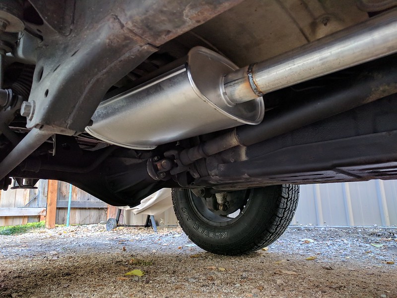

Muffler
Replaced the old buzzy muffler at a local exhaust shop.

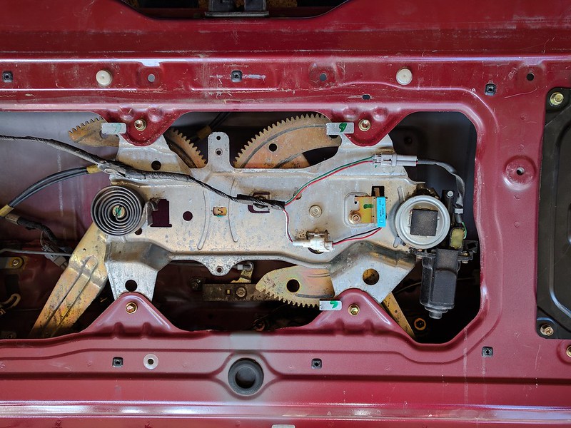

The rear hatch on this truck was definitely replaced before we had it. The rear window, wiper, and defroster didn't work. When I tore the rear door apart, I found that a 99+ control box was in it, and the grounding plug for all the wires was missing! After some research, I found that I needed an older-style window relay/computer for my model of Runner. I ordered one from eBay and found a grounding plug from a junkyard. All rear window functionality was restored!

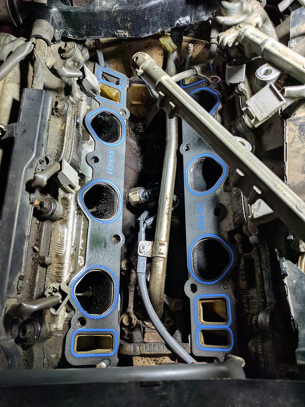

Knock Sensors and Valve Cover Gaskets
We got a check engine light for bad knock sensors. Ordered the OEM replacements from Toyota, got some Fel-Pro valve cover and intake gaskets, and swapped everything out.

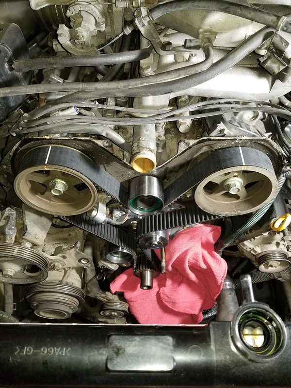

In an effort to keep ahead on maintenance, I went ahead and replaced the timing belt, water pump, thermostat, and pulleys. We had no idea if this had been done by the previous owner, so it was good to get this out of the way.

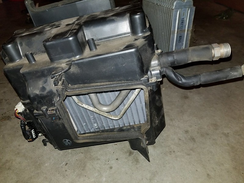

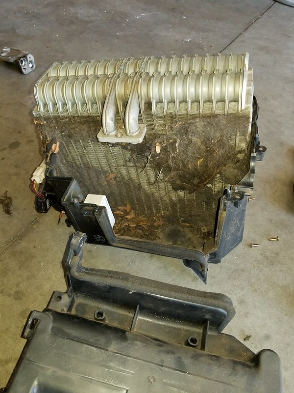

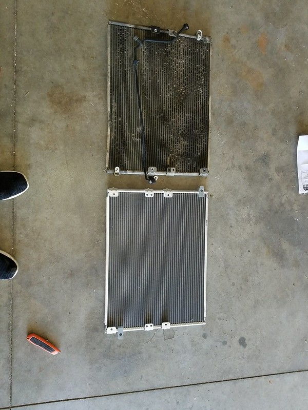

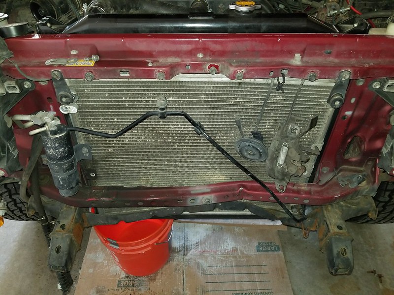

A/C System

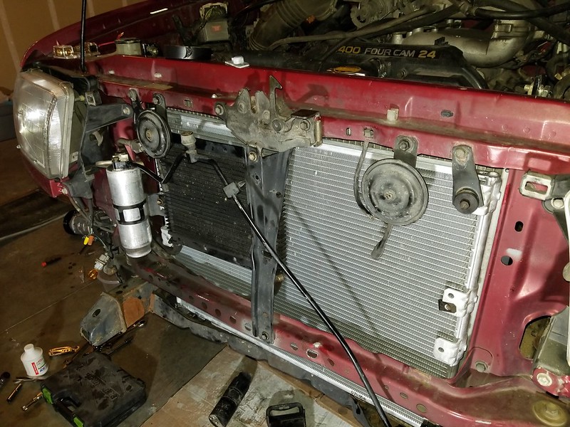

During the timing belt job, I discovered that the A/C pulley has been flopping around. This past weekend I was finally able to replace the compressor, condenser, drier, evaporator core, and expansion valve. I had a local shop do the initial evacuation/reclamation of refrigerant (there were no leaks, just a noisy compressor.) I recharged the system myself. Vacuum pumps are life-savers!
I used this as an opportunity to try and straighten out the core support. I rented a slide hammer from the parts store and was able to pull the core support slightly. The frame crossbar is still pretty messed up. I think I'll end up having a pro body shop address this in the future.

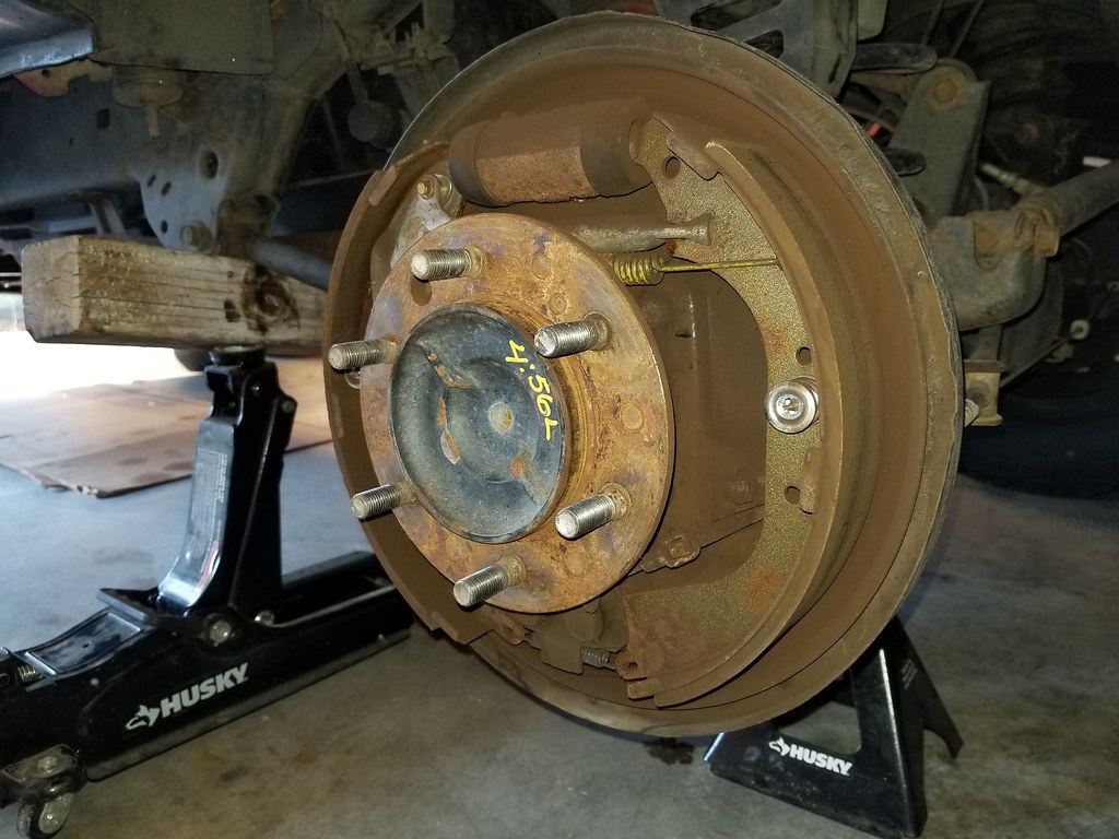

Hi all,
I've suspected for awhile that my rear driver wheel bearing is on its way out. I can hear a clunking noise coming from that corner of the car while driving at about 40mph. I finally took the wheel and hub off last night to remove the axle.
I decided to put the truck up in the air and spin the axle again. The tire has a slight wobble to it. I can definitely hear with my stethoscope that the clunking noise is coming from the wheel bearing area at the axle housing.
My question is this: looking at the video below, do you think this is enough bend to warrant replacing with a new axle shaft? If I do replace, I'll probably upgrade to the Yukon cut-to-fit shafts that support ABS.
Video:
https://www.youtube.com/watch?v=ULjD4eg3G84
can probably go to the junk yard and pick up and axle cheap. then buy new bearing and seal and have it pressed in...just a thought.
I thought that as well, but I've had a couple of friends that have gotten bent axle flanges from junk yards... apparently it can be really common if they're in a wreck. I'll do some checking around. I figured with how cheap the chromoly ones are it'd be a good upgrade to do.
Sent from my SM-G950U using Tapatalk
Update: I found that the rear axle wasn't bent. After throwing wheels from different corners on the driver's rear corner, I saw the tires spinning very straight. I think I have a bent wheel. Here is a video of another wheel on the same corner from the previous post.
https://www.youtube.com/watch?v=UQbPEIX4BjI
In the spirit of saving time, I had my local machine shop remove and reinstall the wheel bearing, retaining clips, and oil seal. I was pleasantly surprised as they only charged me $80! They were thankful that I removed the axle and brought it to them, that brought down the price considerably.
I installed a new set of brake shoes on both rear hubs and speed bleeders on all 4 corners while I was at it. Speed bleeders are incredible! I will never not have these on a car again. After flushing all the old brake fluid out and adjusting the rear brakes properly, this thing stops on a dime!

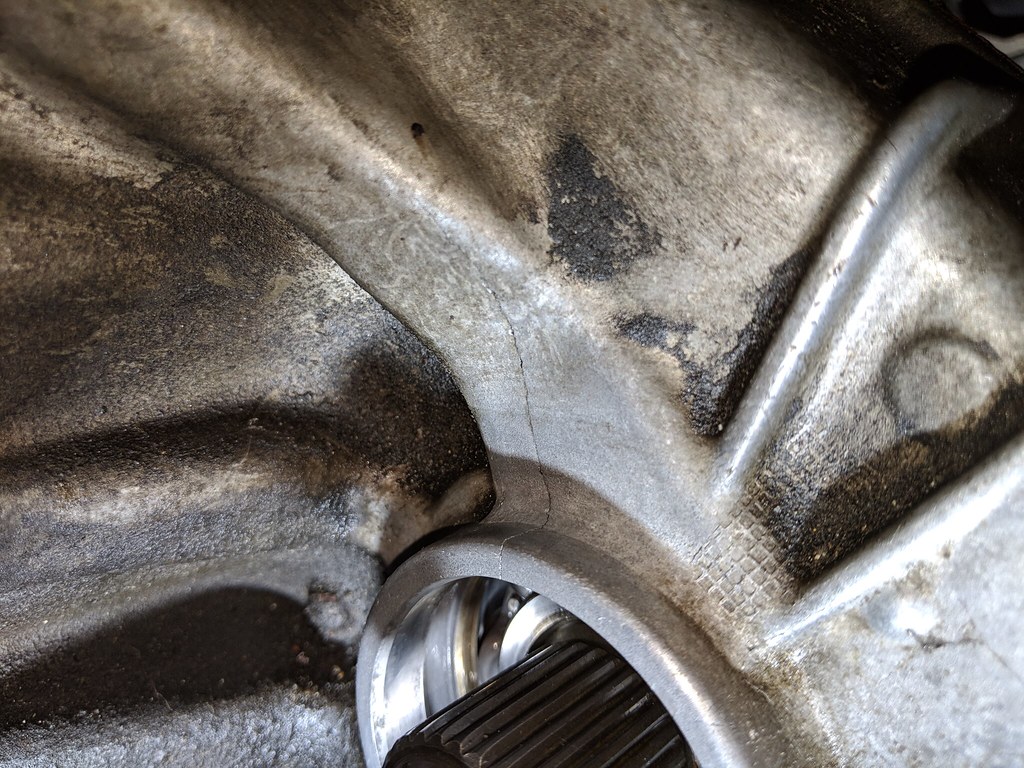

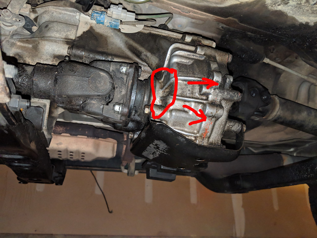

I'm in the process of stopping a transfer case seal leak. Can't seem to figure out what the issue is. Here is where the leak is appearing:
(please ignore the greasy mess by the driveshaft, it's residual from greasing u-joints)
I've replaced the front output shaft seal two times. Once with an O'Reilly's seal, the second with an OEM Toyota seal (with the longer flange.)
Each time I replace the seal, I rinse off the transfer case with brake cleaner. It appears to stay dry for about 8-10 miles. After that, the leak reappears in the red area I circled in the picture above.
I have checked the top of the transfer case for leaks coming from the oil deflector, and it's totally dry up there. Am I just pressing in the seal wrong? Has anyone else ran into this issue? Thanks in advance, guys.

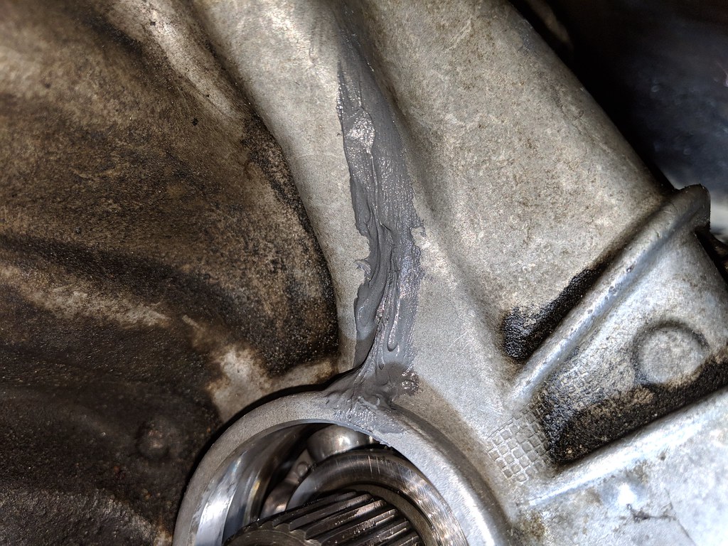

TL;DR, my transfer case is cracked. What the hell.

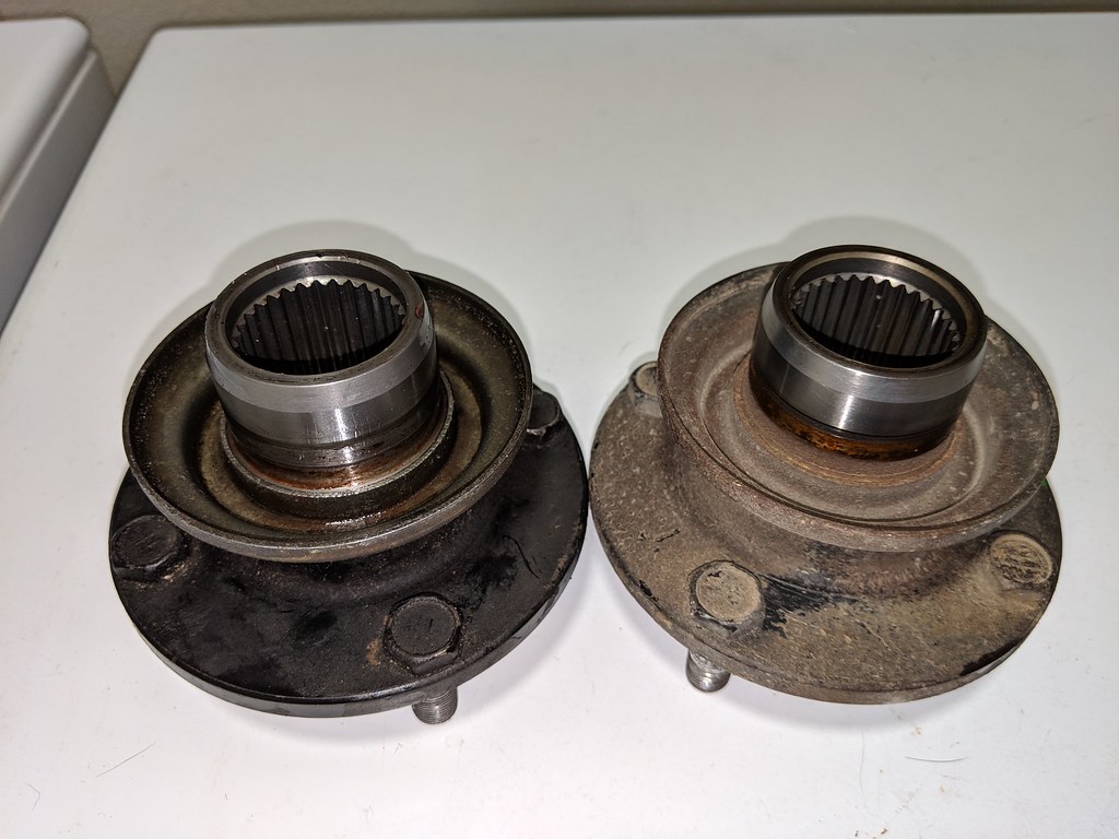

I thought that my companion flange's seal surface could be damaged. It looked like there was some rust growing on it and that was causing it to leak intermittently.
Got a different one from a junk yard. Old one (left), new one (right)
Went to install it, and set my light underneath the truck and see THIS BS!
My damn transfer case has a HUGE crack in it. I have zero clue how it got there. This is most certainly why it's been leaking this whole time.
I threw some JB weld on top of it in hopes that it'll slow the leak down. I'm going through car-part.com right now trying to source a new transfer case. This is so annoying. Sometimes I wonder if this POS is worth the trouble :) /rant
that sucks.
somebody whacked that poor thing on a rock pretty hard. they are cheap and plentiful at the junk yards and ebay. also not hard to swap them out.
