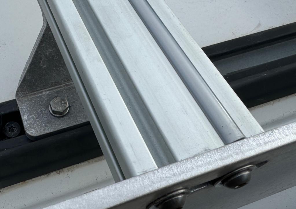

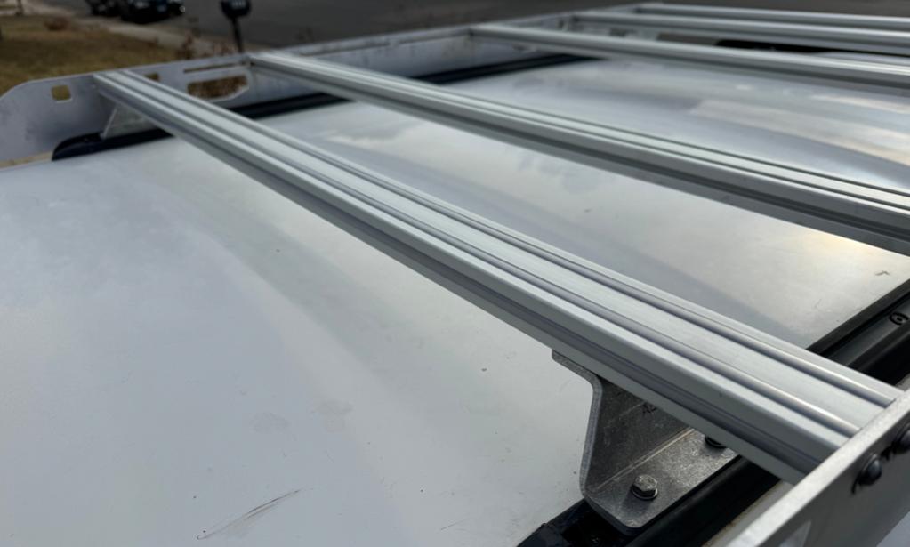

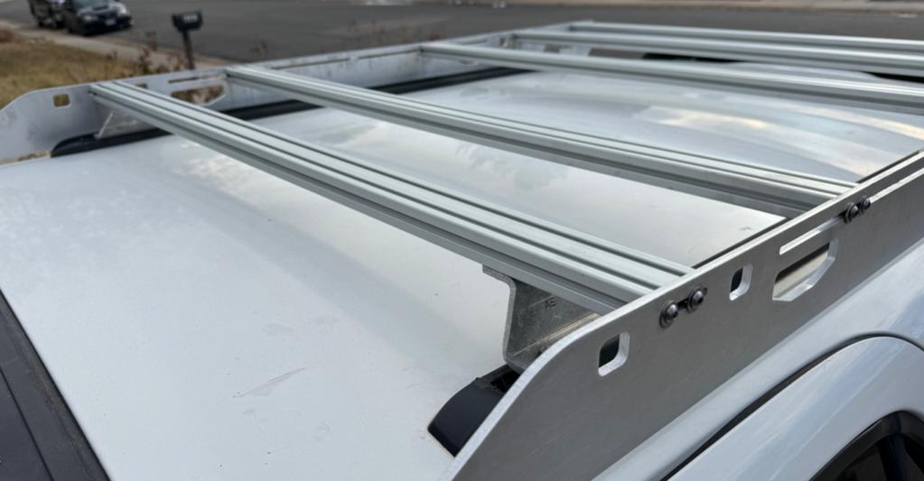

Installed the extrusion slot covers into the 1st/front cross bar of the Antero rack this morning.
Here is the crossbar without covers...they are open to collecting dirt & ice as well as making noise -
and here is the cross bar with all of the slots filled (even the bottom two) -
One package in the Amazon link is enough to do one cross bar on the Antero rack.
They are easy to install and remove and it's my hope that they will reduce air noise.
There are a lot of colors available - I chose silver to have them blend in.
I'm not sure how well they will manage the sun & weather so time will tell. I ordered enough to do all of the cross bars on my rack.

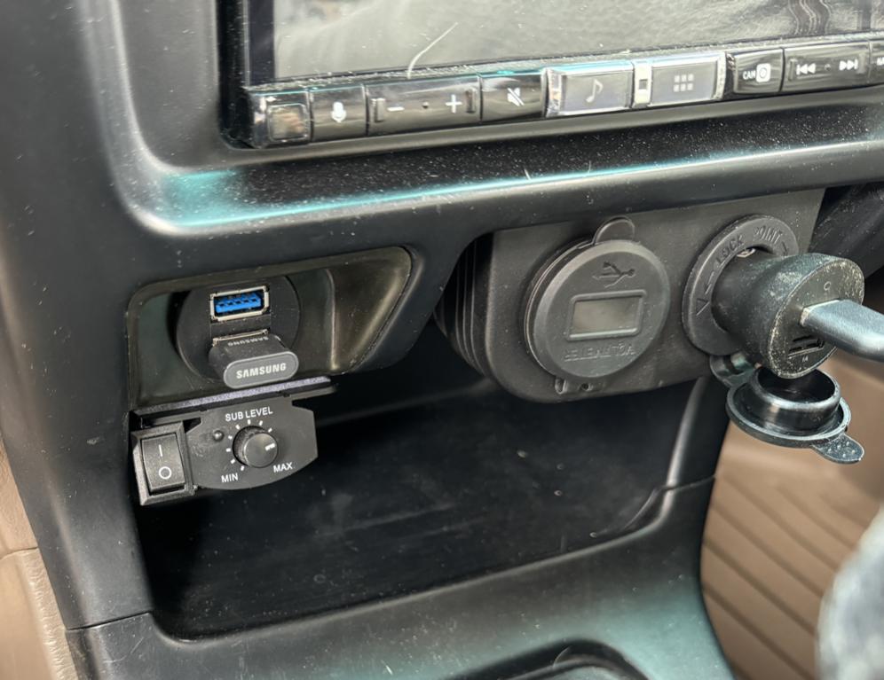

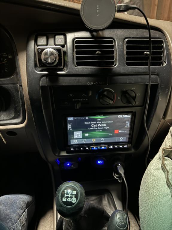

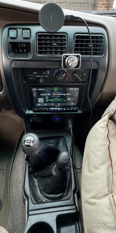

Also installed an Alpine RUX-H02 bluetooth volume/subwoofer control knob -
It's attached to the dash with velcro so I can easily move it if I want.

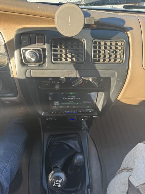

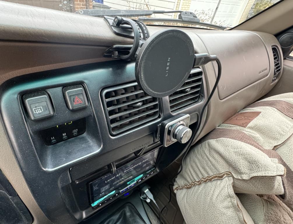

In the pic is my magnetic cell phone holder/charger -
The LISEN Magsafe Car Mount Charger works well and I mounted it to the dash using the adhesive tape on the mount -
I attached the switch for the alarm audio sensor to the side of the Bose subwoofer control knob using a big glob of hot glue -
I didn't like the remote volume knob where it was so I moved it over to the clock inset and it fits like a glove. The time is displayed on the iLX-507 screen -

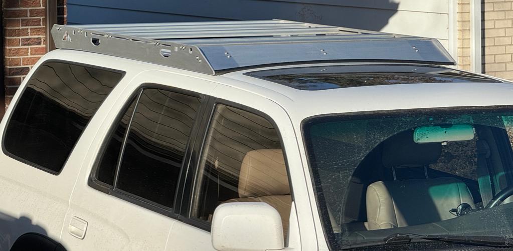

A few days ago I drove up the Sherpa Equipment main office in Berthod, Colorado and picked up a wind deflector from a Matterhorn rack and a scratch and dent cross bar to install on my Antero rack.
The Antero rack doesn't have this option but I wanted the deflector to reduce wind noise that I was getting from the rack.
I mounted the deflector to the cross bar with the supplied hardware and then sat it in place between the outer side rails. Once I had it where I wanted it I marked the sides of the cross bar with a sharpie and removed the assembly.
I transferred the hole locations from the end of the cross bar using masking tape that was trimmed to the size of the bar and then the screw holes punched in the tape. The tape was then aligned with the marks on the side rails and holes were drilled.
Here it is mounted - no trimming was necessary and on the test drive it sounded like the air noise was reduced -
