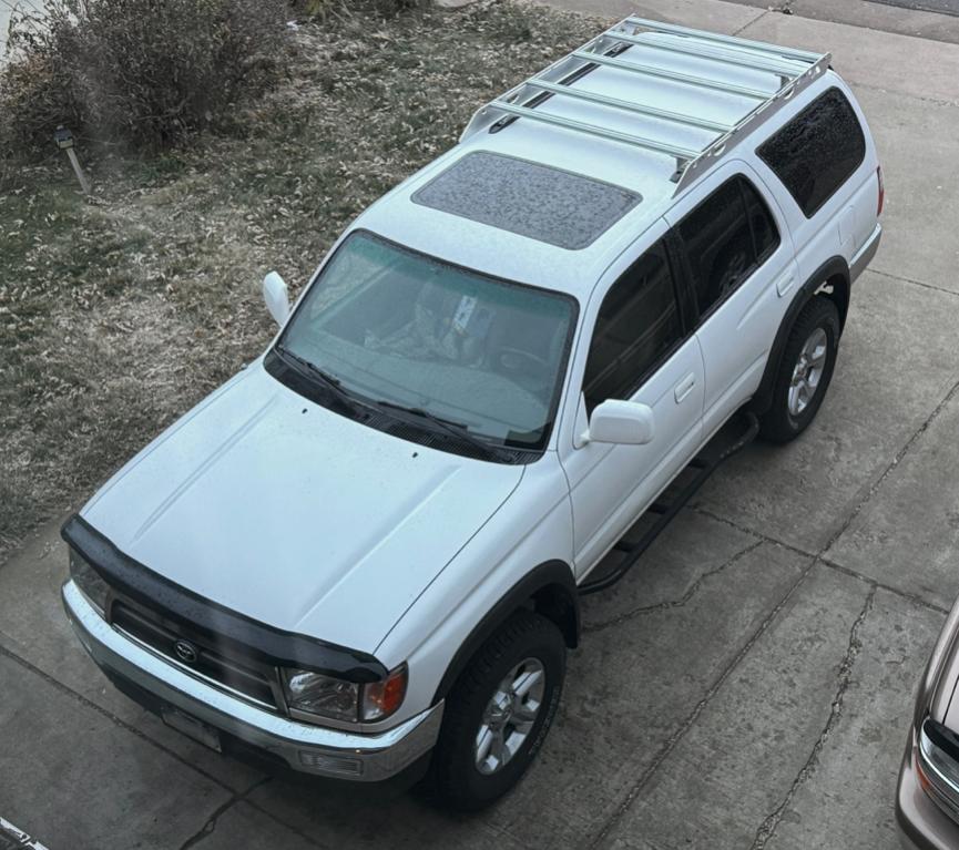

Drove up to Sherpa Equipment in Berthod, Colorado yesterday and picked up the silver Antero rack. While I was there one item caught my eye - 3RD GEN 4RUNNER WINDOW PANEL - very cool.
I bought a set of Roof Track Anchor Plates since the only thing I had were smaller plates on the old Yakima mounts.

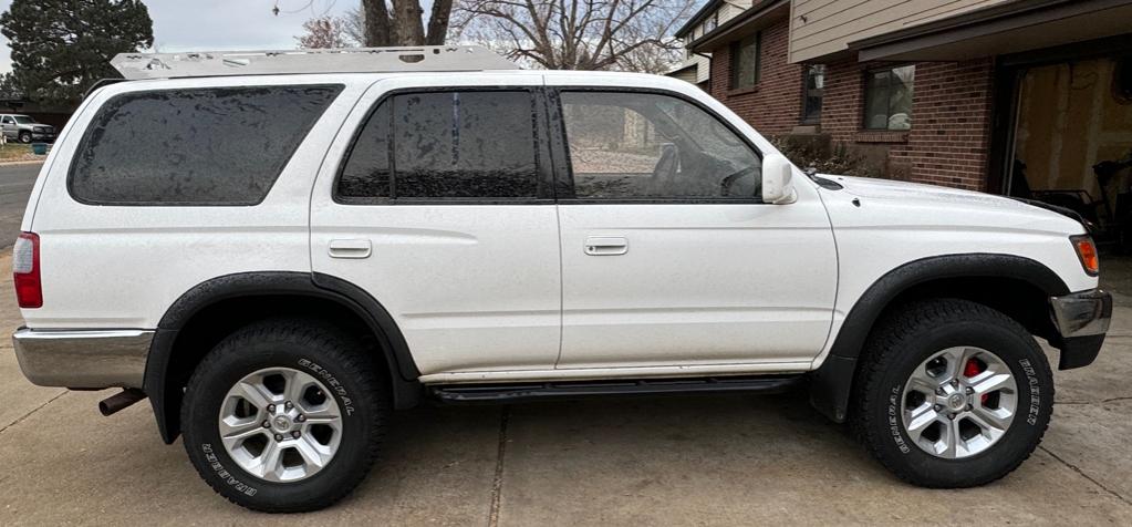

When I got home I installed the rack and it wasn't difficult by any means.
The rack is really stout and should hold the big storage box or most anything else that I need up there.

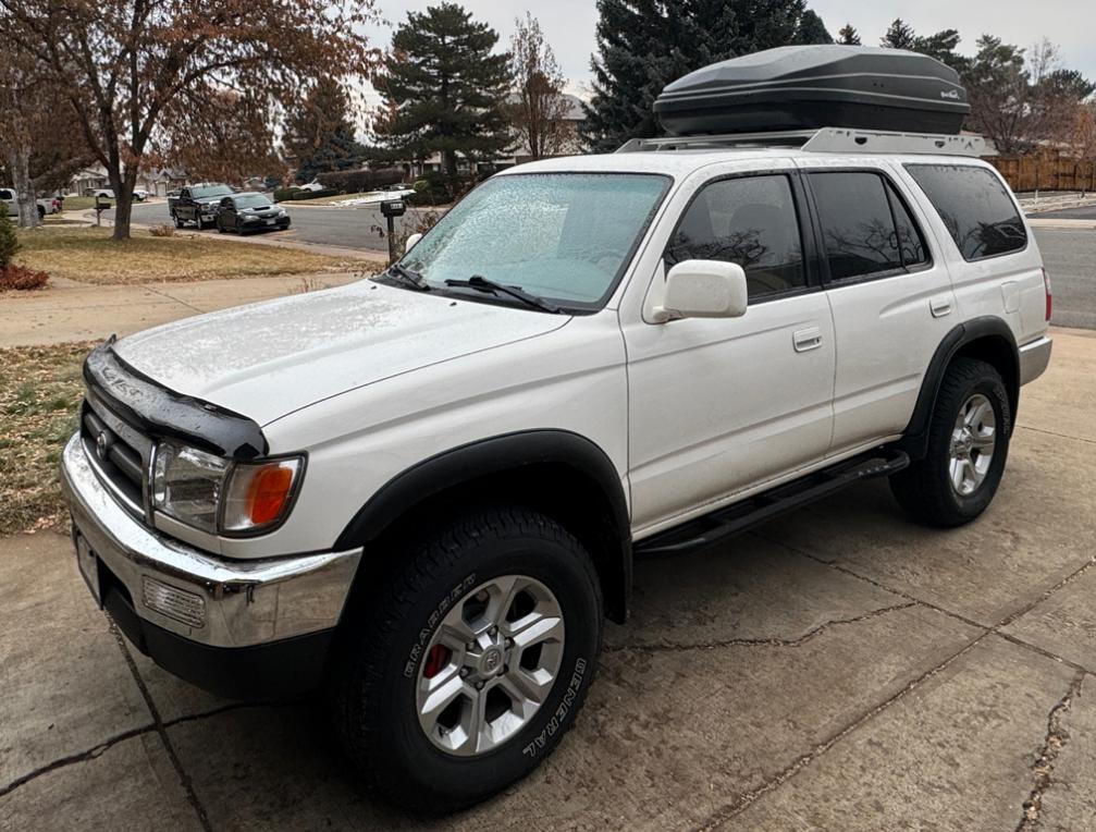

quick pic

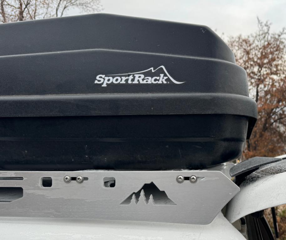

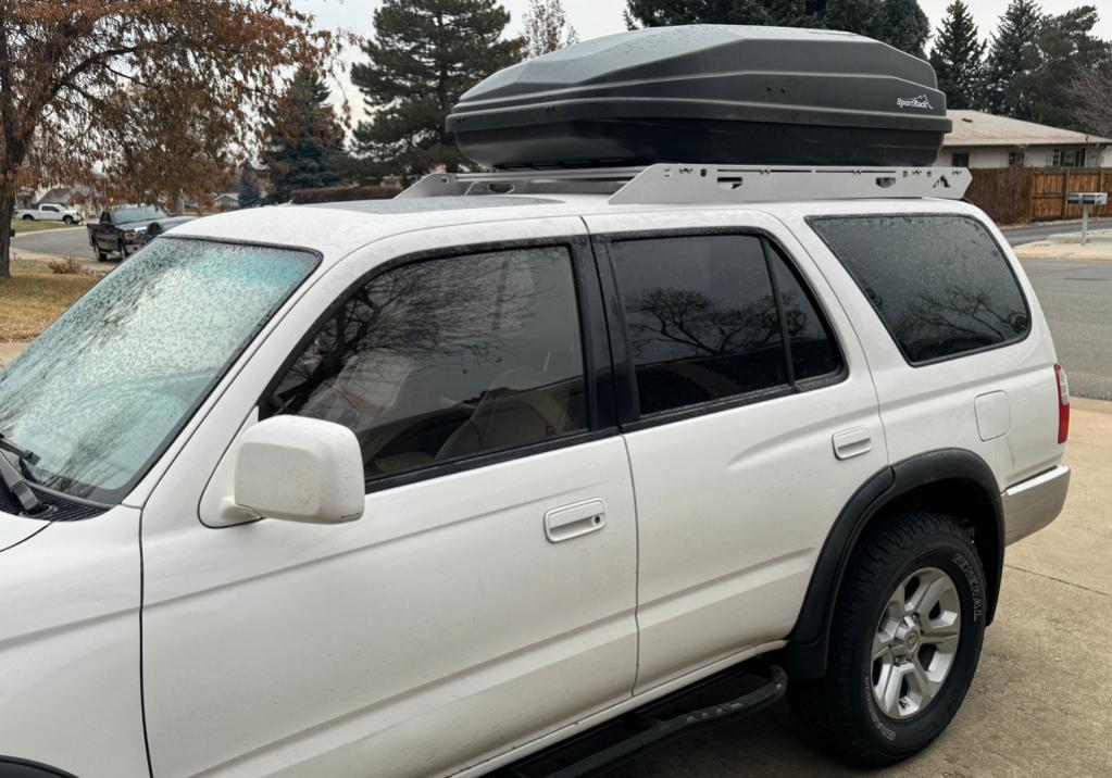

I put the SportRack box on the Antero rack and it looks right at home -
It looks like the U bolts that came with the box will work with the rack - they are rounded though so I may look for U bolts with a square shape.
Looking good! McMaster has a nice selection of square u-bolts, FYI.

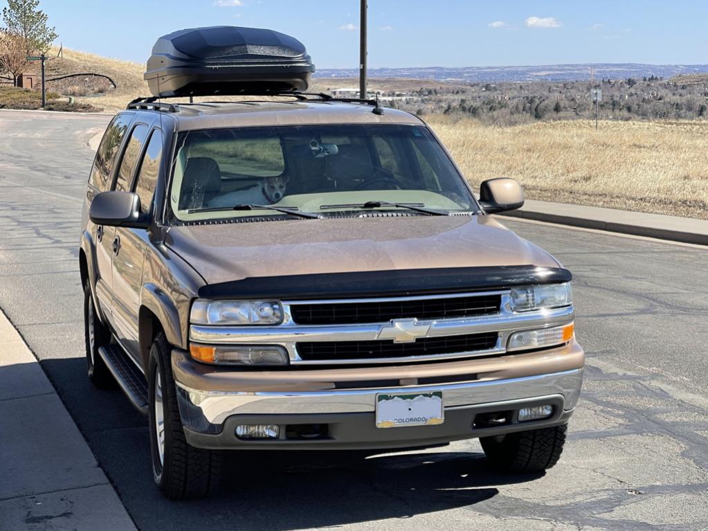

Do you get any wind noise on the highway with that box?
I didn't even know it was there on my 2003 Suburban...then again it's a lot bigger SUV.

Flat plate with square holes, carriage bolts and some nuts will keep all sharp hardware out of the box (carriage bolts pointing down). Only downside is that someone can steal the box without opening it first. McMaster might also have the u-bolts you are looking for.
The rack is stronger than the roof - I notice more flex in the roof than the rack if I push/pull on it (Matterhorn). I ran extra OEM track to the front and bolted the front feet down, and I'm considering getting an set of feet to add another between the back two supports to spread the load out over the roof more.
