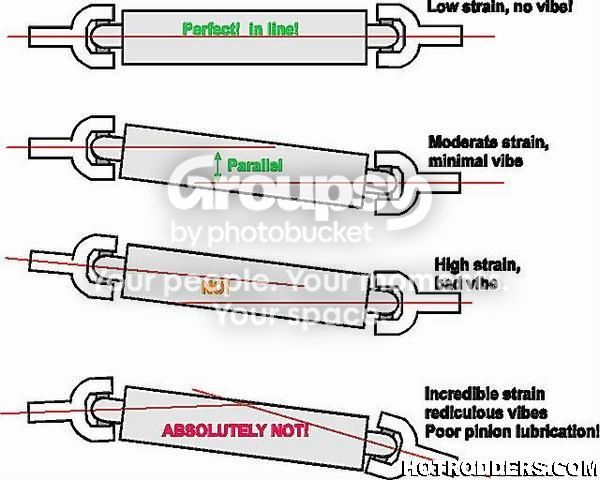

I'm thinking of getting the ToyTec adjustable lower control arms (or links) to hopefully fix the pinion angle that I suspect is causing some annoying driveline vibe. My question is this, how much longer should I extend them to get the correct angle? Right now I'm on the OME 891 springs with only a bumper so not much sag.
Also, thought the chart below did a good job at explaining correct driveline angles. Right now I think I fall into the third category, maybe the 4th, just not as exaggerated.
Normally you use the adjustable UCAs for locating... You shouldn't have to move them much I'd say go a 1/16" at a time? The factory arms should provide the correct geometry... You sure your issues aren't elsewhere?
Keep in mind, that chart is for single carden type driveshafts. 3rd gens use a double carden shaft which typically do not have the vibration issues that single carden shafts do. Pointing the pinion up and not being parallel with the T case output will reduce vibrations in my experience on these trucks even though that chart says not to.

Technically the correct set-up for double cardan is keeping the rear pinion and drive shaft in a straight line. You can allow a slight degree on angle on the pinion side u-joint for flex and settling reasons. This picture shows the correct set-up for a double cardan. I ran this exact set-up on the rear of many jeeps with no drive line vibrations, and 4runners rear shafts are about 2x longer.
Awesome pic, had no idea about the different types of joints. Learn something everyday. Thanks!
