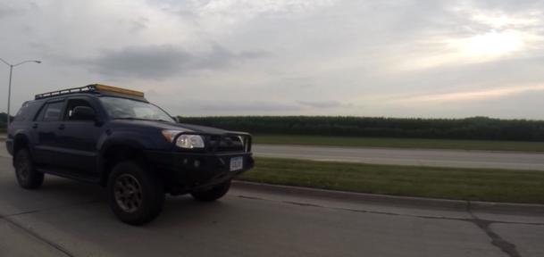

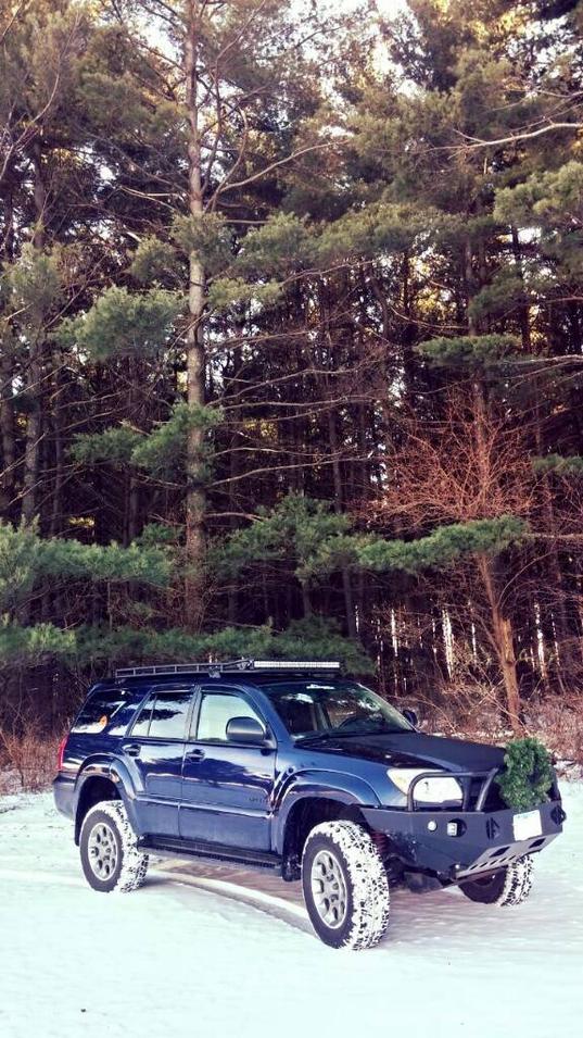

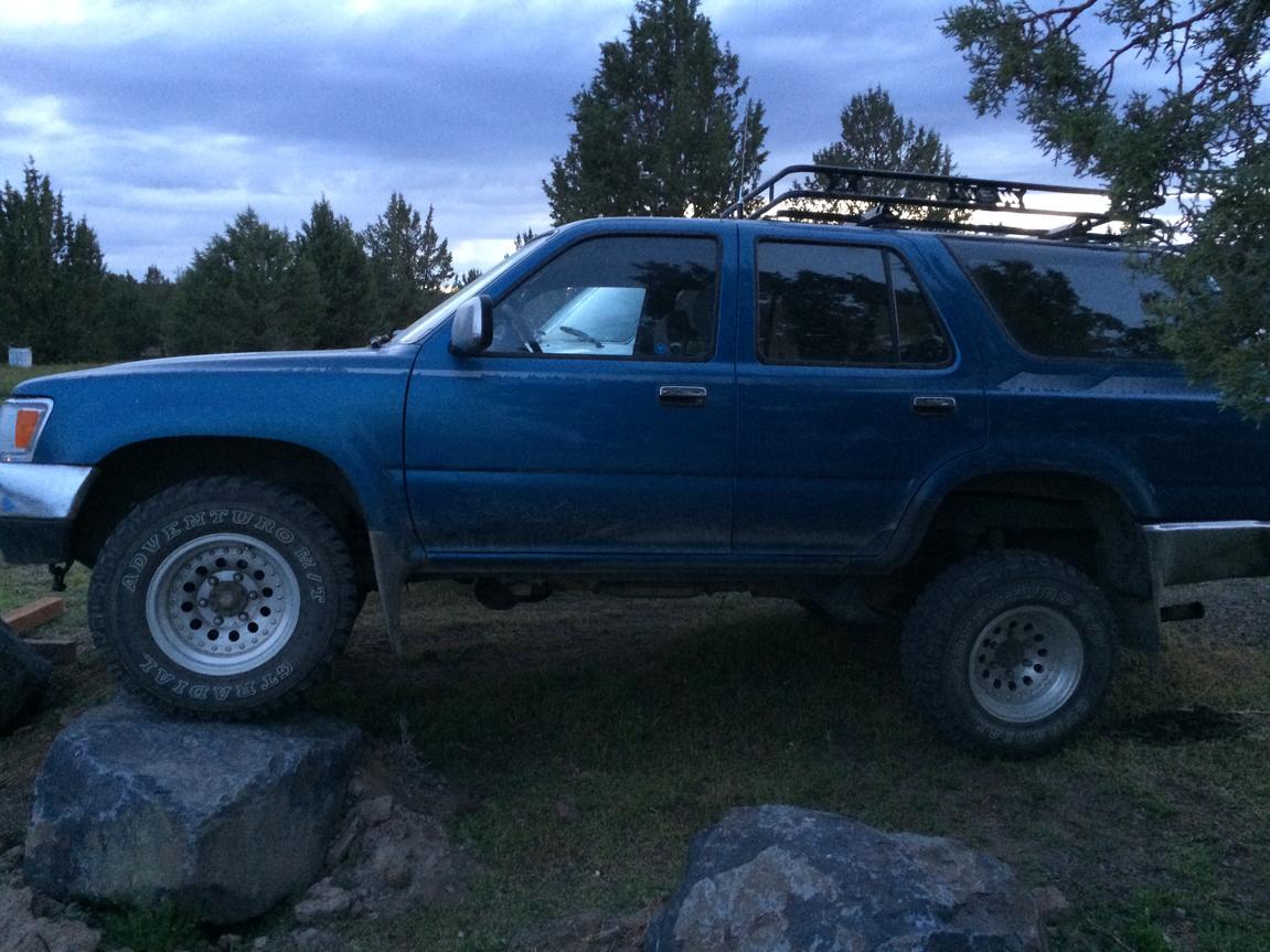

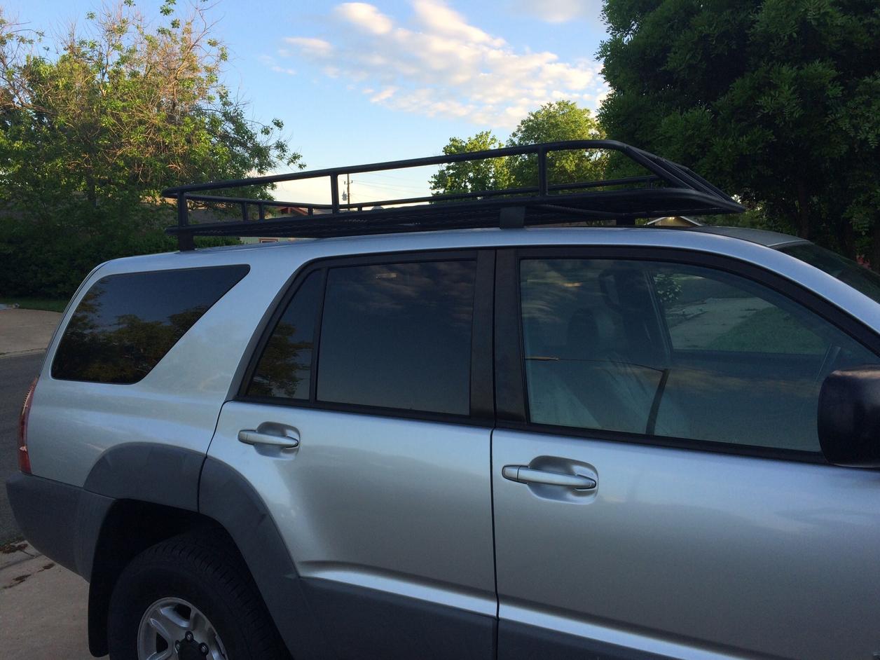

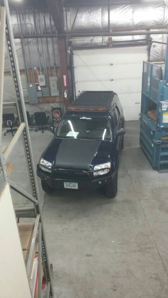

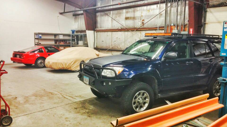

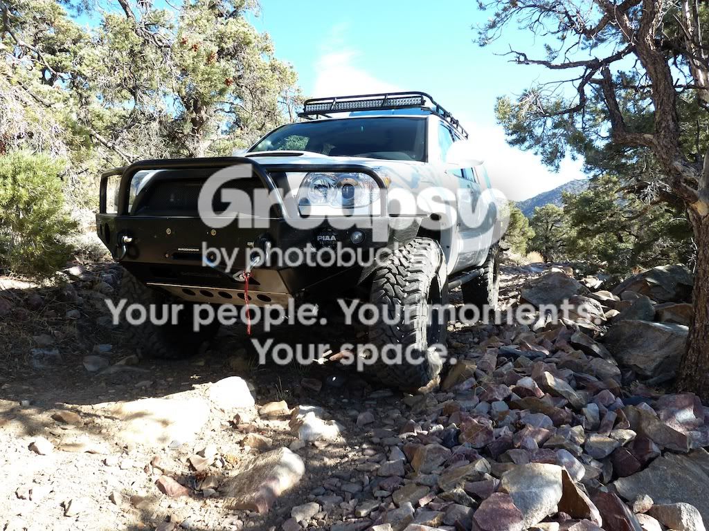

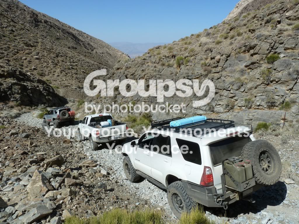

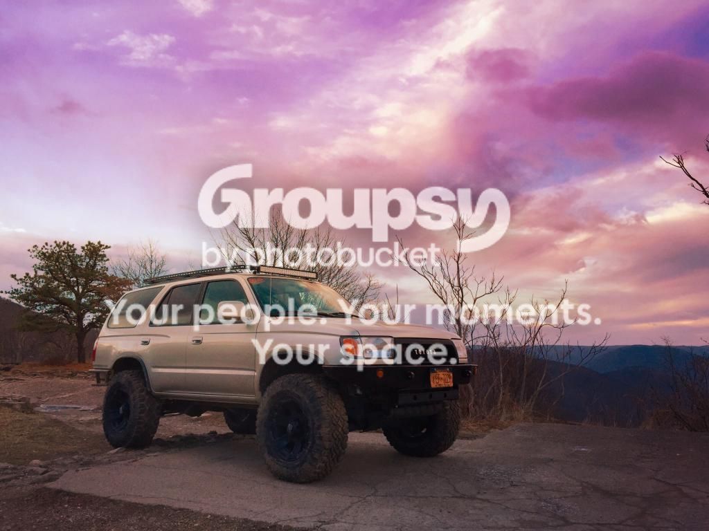

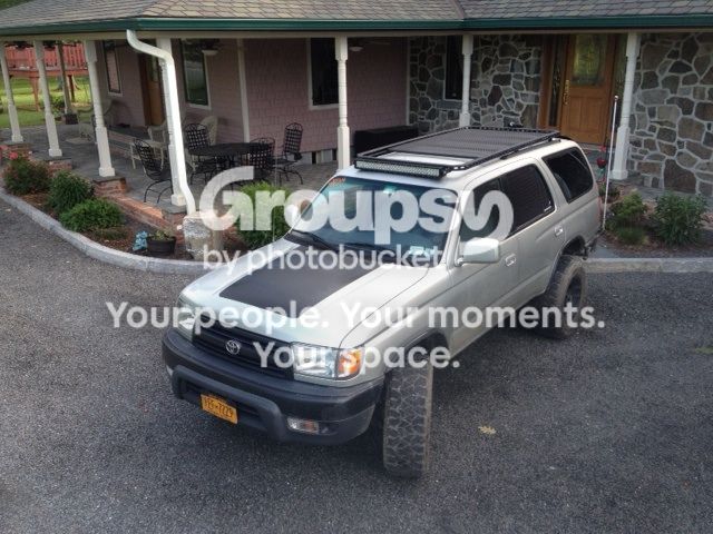

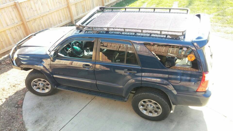

x2 on Perkin Performance's quality. Like SeattleMike, I too considered the gobi but after talking with Jason and seeing his work I decided to have him build me one to fit my needs.
X3 on Perkin's Performance...and also credit to darkie3495 for designing it.

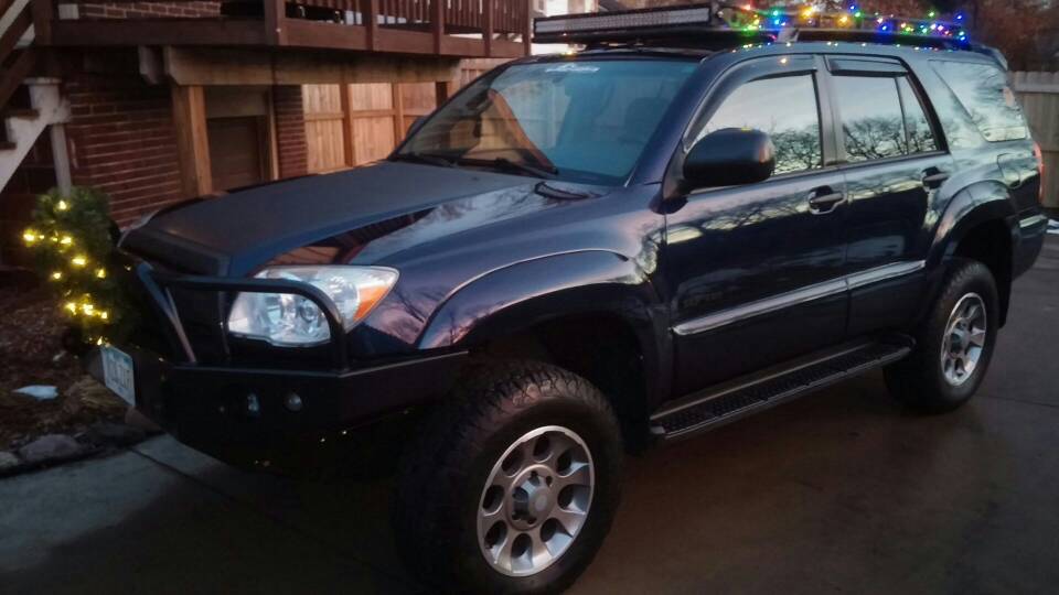

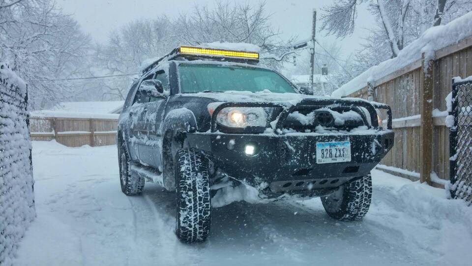

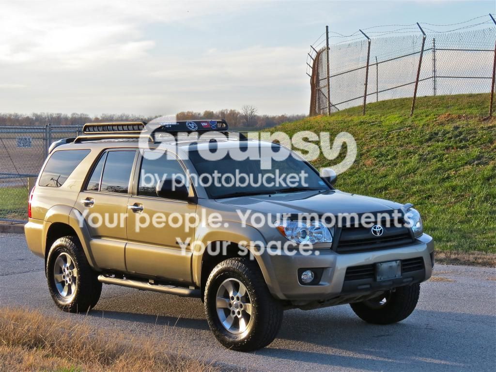

Perkins Performance roof rack with a Rigid Industries 40" E-Series LED light bar and adjustable cross bars.

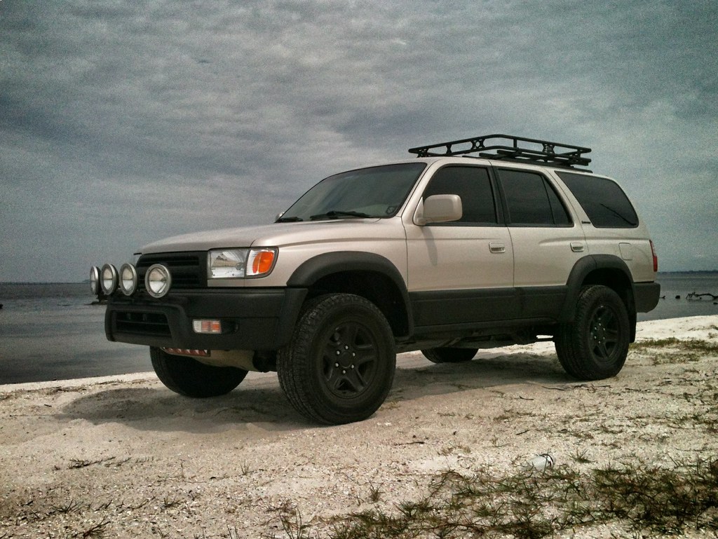

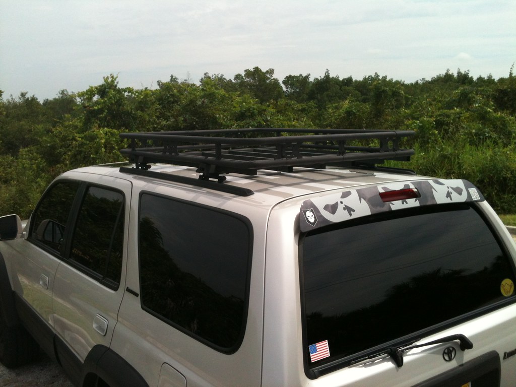

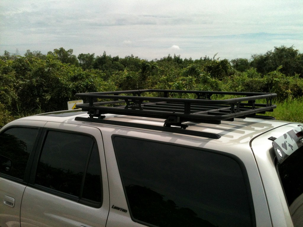

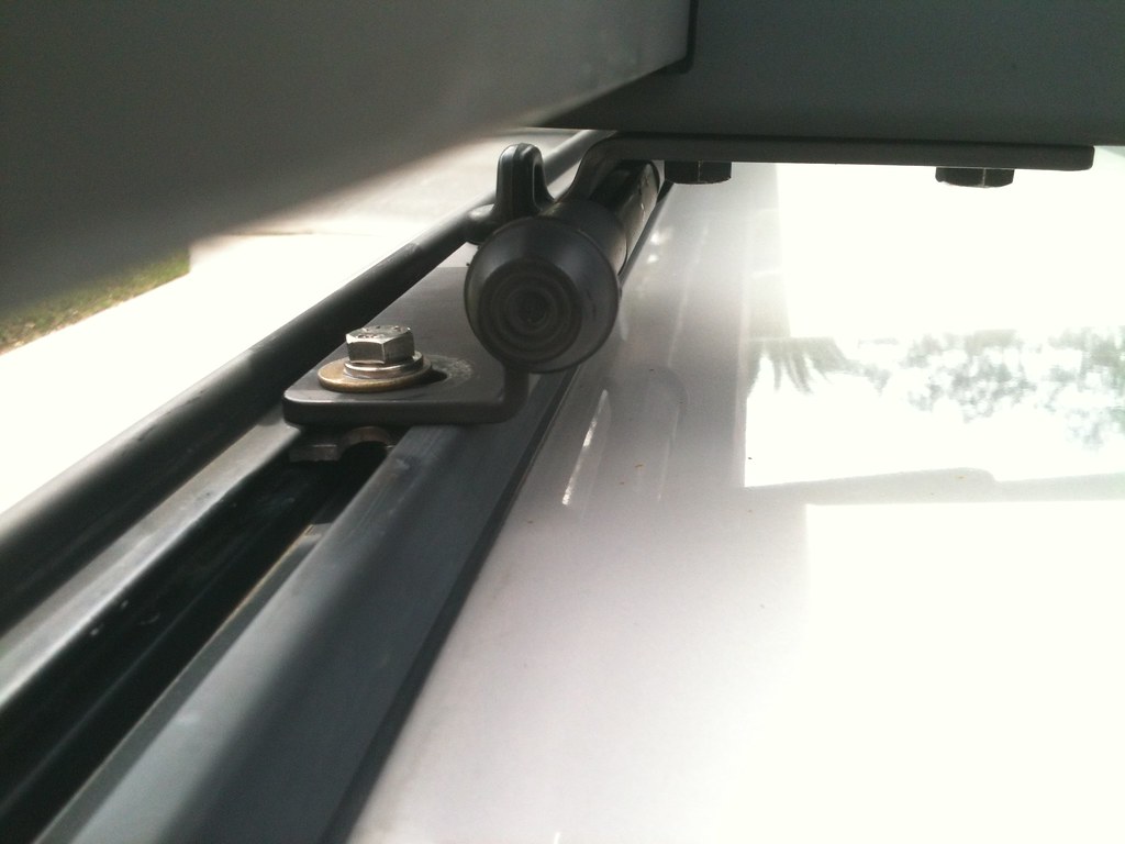

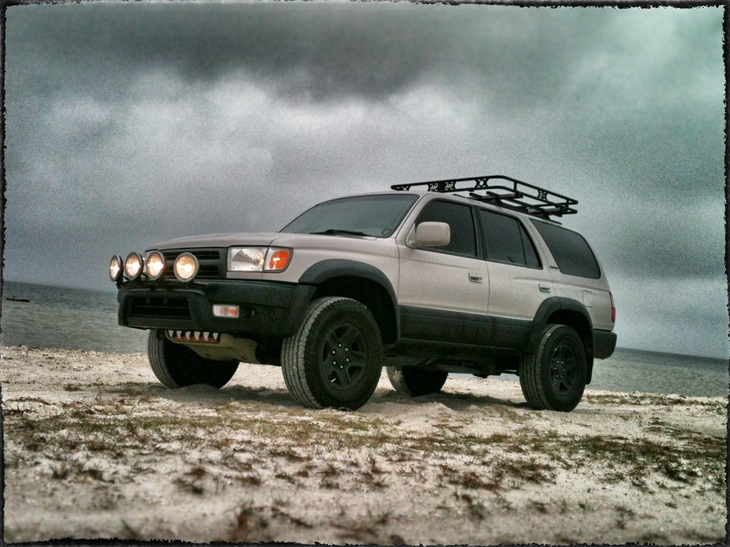

I cut down my Kargo Master "Safari" rack to fit better. It was too wide and just didn't look right even after I flipped the top cage around. They are made for a Jeep and are 52" W x 60" L, which doesn't fit the 3rd Gen at all.

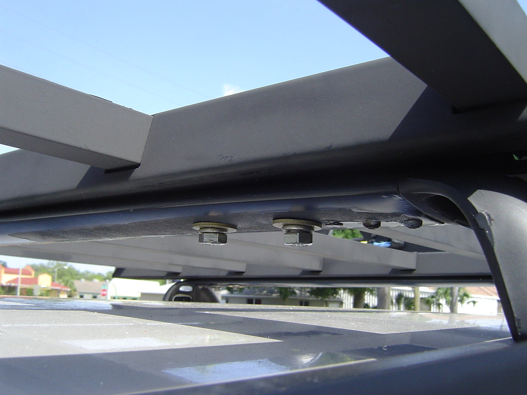

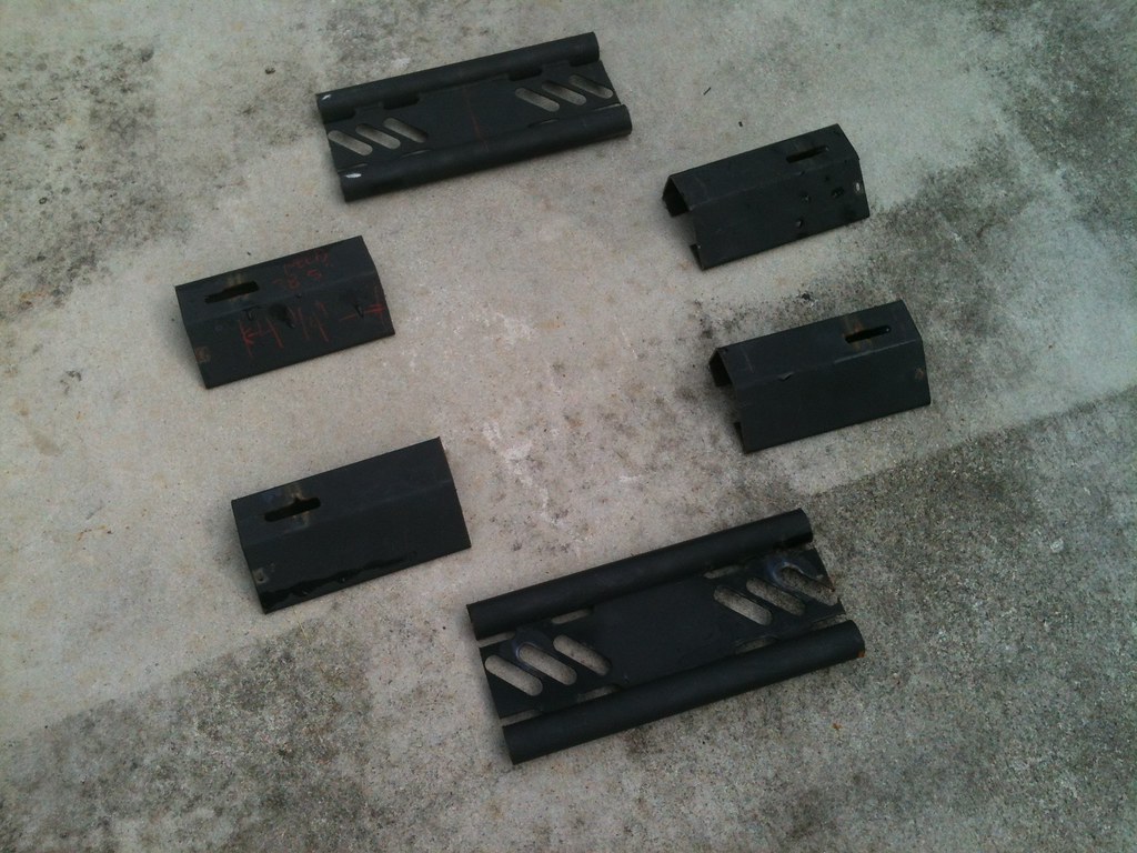

I also remounted it using the mounts that came with it, by reusing the factory rail "nuts". Way better than mounting it to the factory cross bars which didn't look good at all.

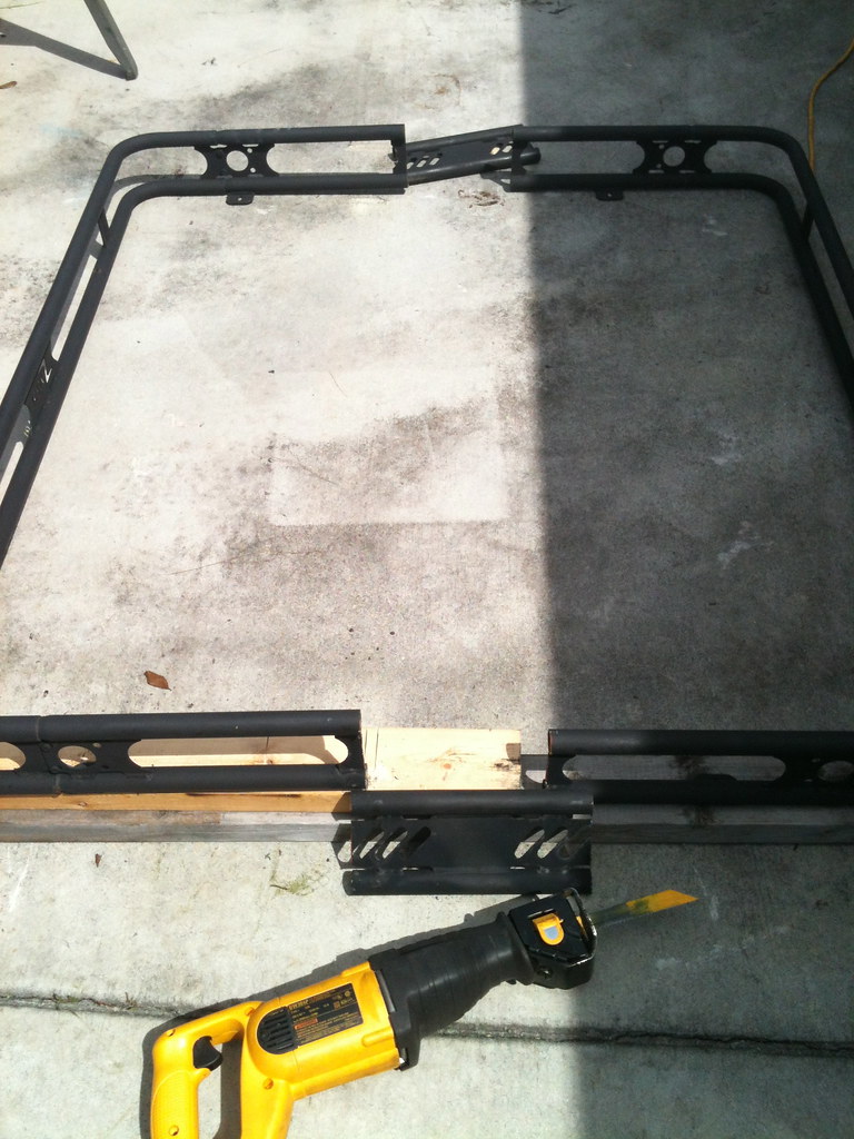

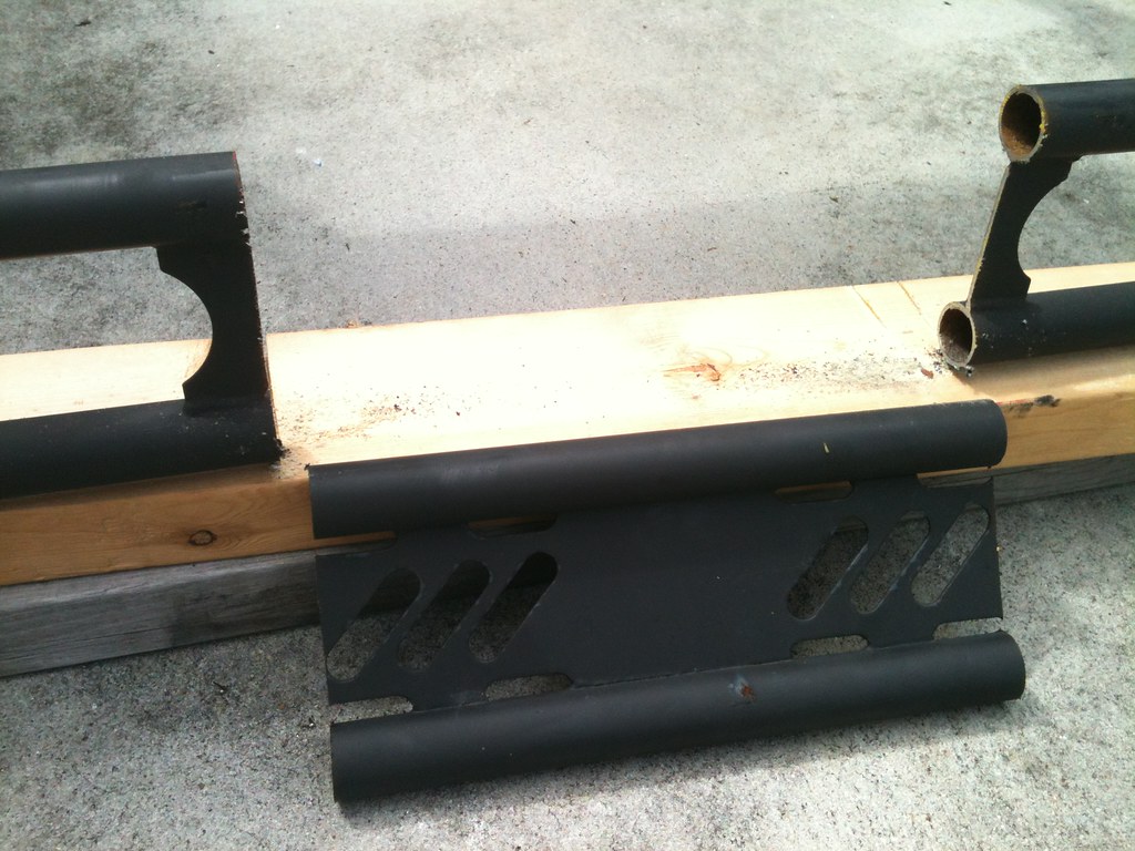

I cut the base down 6" on each side and cut 10" out of the center. I bolted the top cage back together and now it fits just right.
Stock size:
Dreary day at the beach by CENTCOM_Survivor, on Flickr
Rear view of rack by CENTCOM_Survivor, on Flickr
Old mounting:
Old rack mounting by CENTCOM_Survivor, on Flickr
Cut down:
Cutting the rack by CENTCOM_Survivor, on Flickr
10" out of the centers by CENTCOM_Survivor, on Flickr
Rack cuts by CENTCOM_Survivor, on Flickr
Beach by CENTCOM_Survivor, on Flickr
Rack close up by CENTCOM_Survivor, on Flickr
New mounts:
Rack mounting by CENTCOM_Survivor, on Flickr
Safari rack Cut down and welded to mounts and then rivnuted the roof and installed the rack. Paid 125 after materials to install and help welding it together.

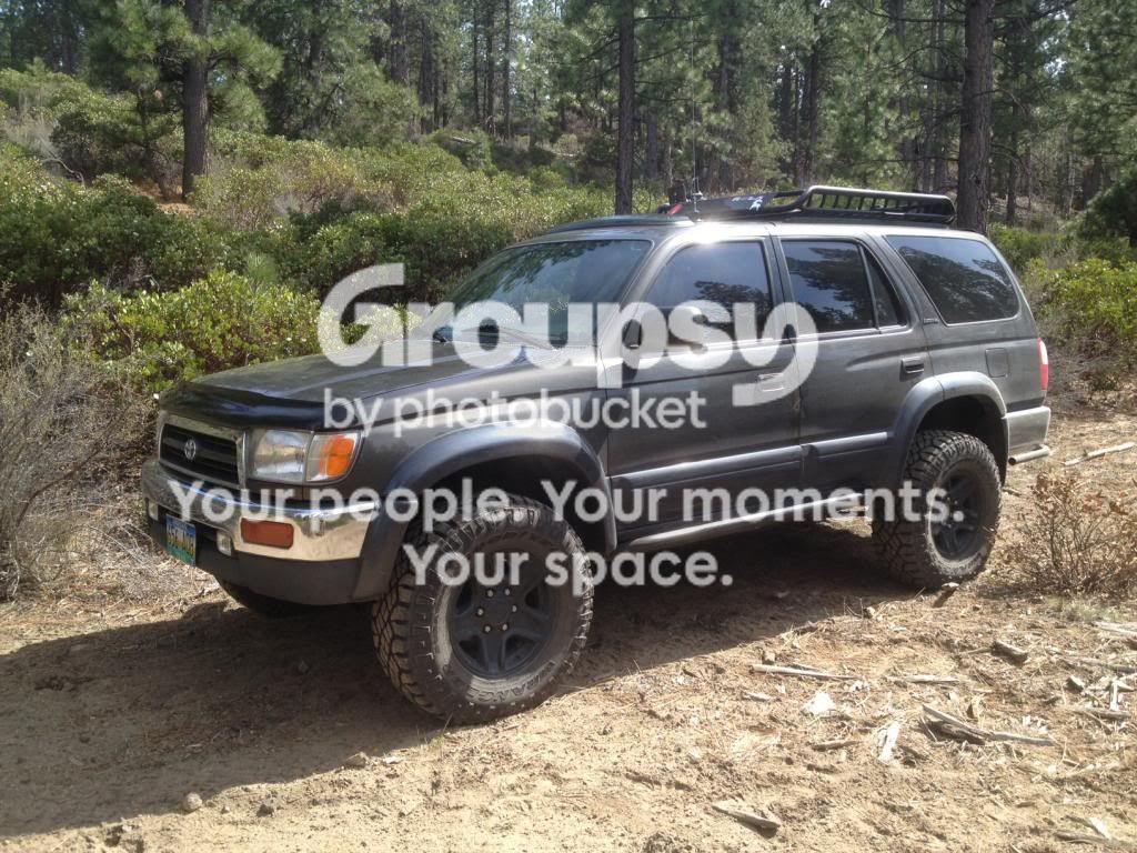

Whitson all the way
Rocking the now elusive and rare Whitson Metalworks full length rack. . .thanks a lot Gobi.

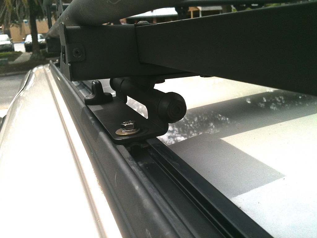

Yakima Megawarrior with extension
Mounted a Yakima Megawarrior with extension this weekend. I tweaked the included mounting hardware and bolted it to my rails, bypassing the weak factory crossbars.
