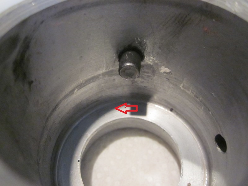

I changed another part, I'll call it the shift tower, after determining that it was badly worn. It may escape the attention of someone doing a clutch repair. It's easy to replace, though a bit costly, about $60. Here are two photographs.
attachment.php
http://www.toyota-4runner.org/attachment.php?attachmentid=144882&stc=1&d=1423026792
I think the previous owner had leaned on the shift lever with such force and so many times - it was very hard to shift, even with the clutch pushed well into the carpet - that the left pin in the shift tower worked loose. In the 2nd photo you can see that it's slightly askew. I can turn the pin with my fingers and feel the wiggle.
Now, a slightly sloppy pin may sound like no big deal, but the pin of course is the fulcrum for the shift lever, and down inside the gearbox that small wiggle is multiplied to a big wiggle. I won't make size estimates because I took no measurements.
Furthermore, being loose there was a significant gear oil weepage at that spot.
So, something else to check on a clutch job.
That tower, which Toyota calls "RETAINER SUB-ASSY, C" has a part number of 33506-35140. (R151 gearbox only) To my surprise, it came with a new - and greased! - rubber seat. The breather tube must be extracted from the old tower and installed into the new tower.
