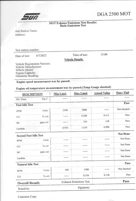

I saw a link to the 'original' TCW3 thread on ls1.com while looking into ethanol in fuel (We now have E10 here, it used to be E5 maximum)
Out of curiosity I thought I would try it as it made sense. I have no problems with the idea, as TCW3 is ashless and designed to be burned. My previous Suzuki chewed through engine oil due to bad valve seals and the plugs were black and it never had any catalyst or sensor problems.
Anyway here are official emissions figures on a 1:500 mix. It passed, easily.
I also think it could be good for the fuel pump etc to add a little lubricity.
