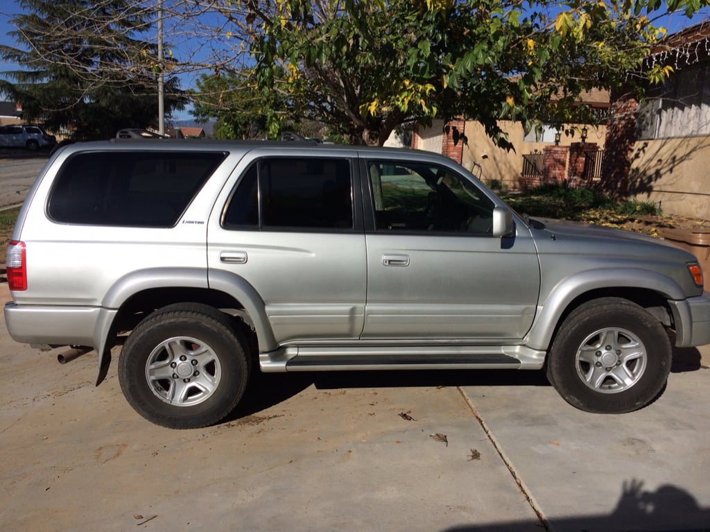

When I first bought it...
End of 2015 when I first started modifying it

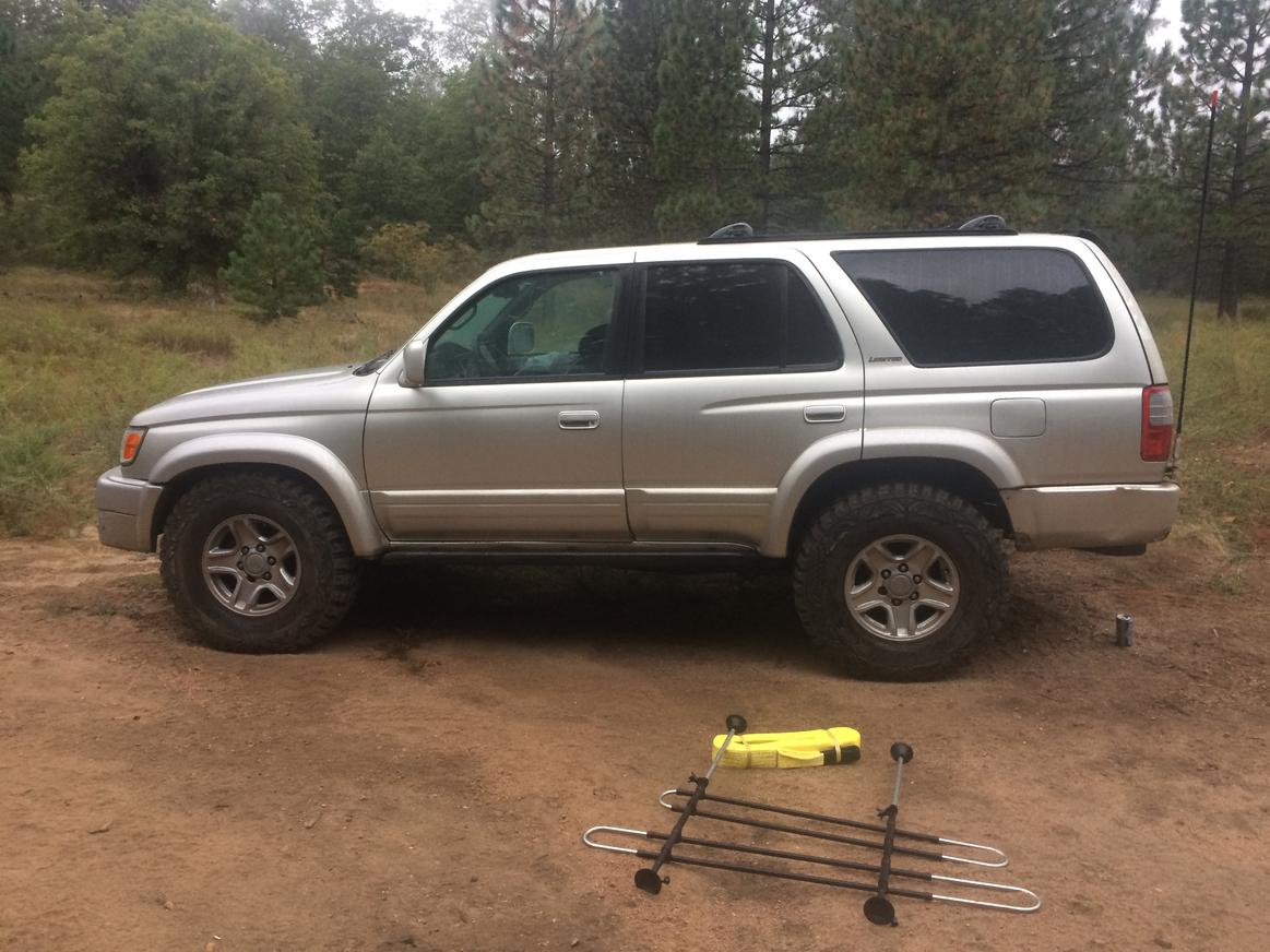

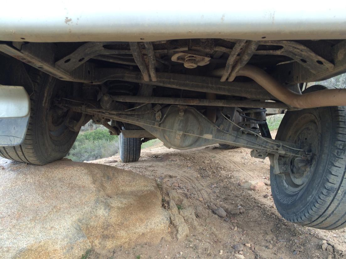

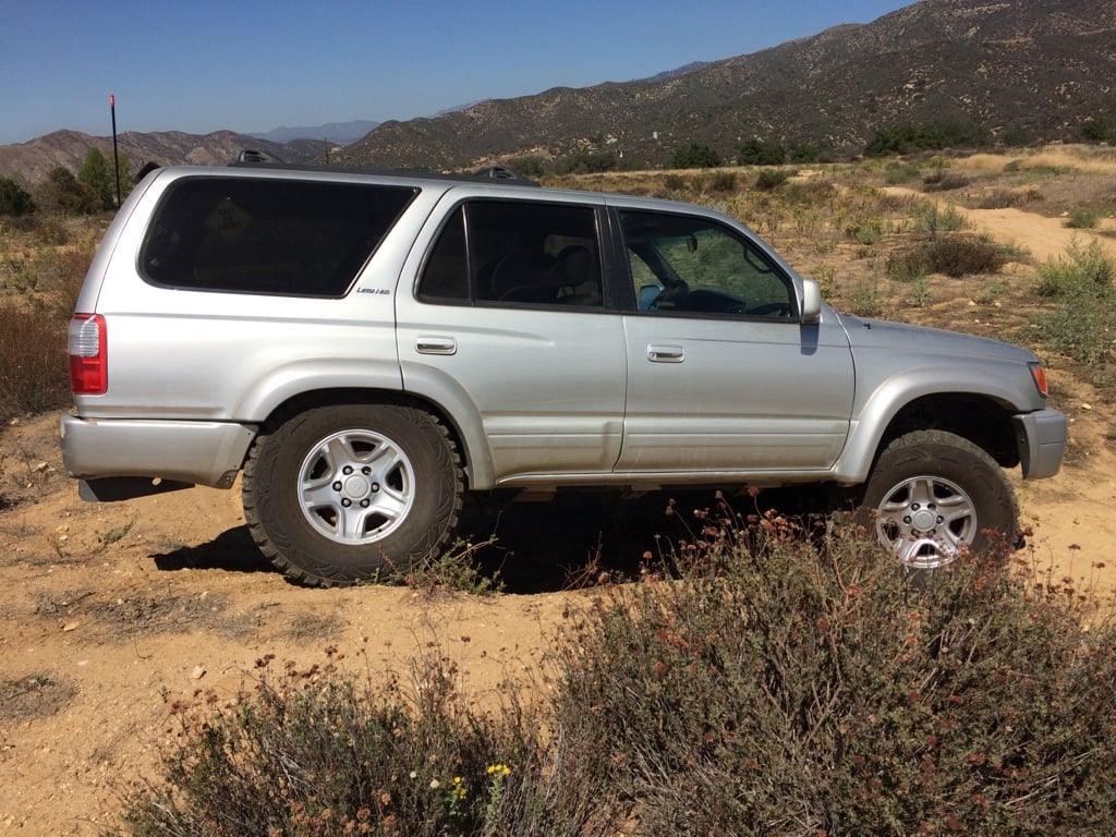

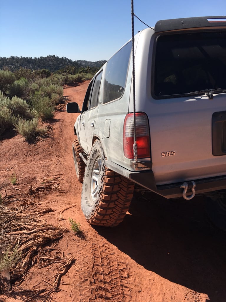

Checking out if the sway bars made any difference and it helps flex a little bit both in the front and rear. Leaving the rear off was just too sloppy on the road so I keep the rear on and just disconnect the links and hang them up when I go offroading. I never put the front back on after I removed it. It doesn't make that big of a difference on the roads.
No sway bars
No way bars
Rear sway bar still attached

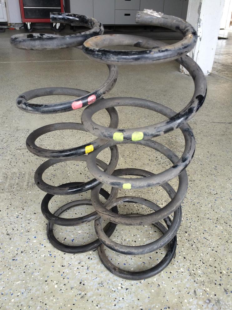

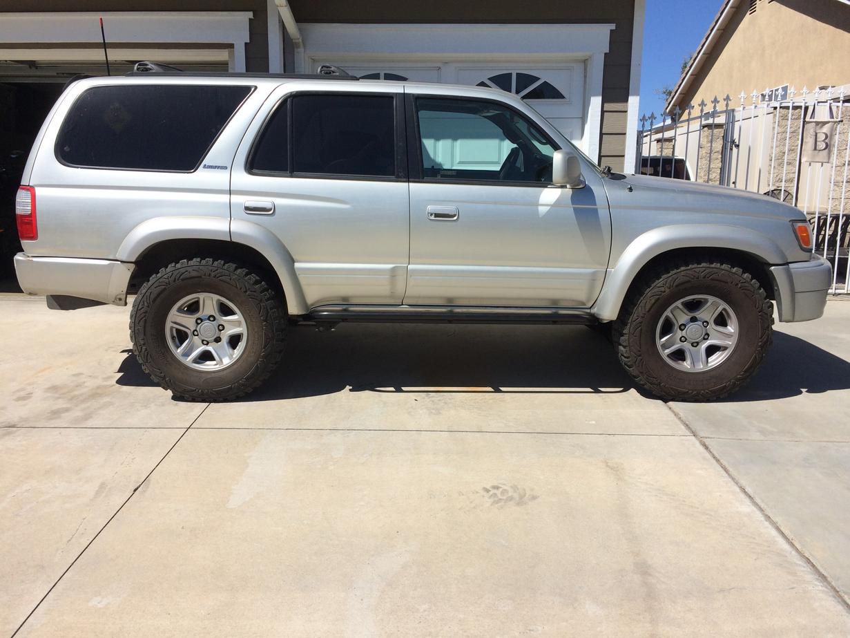

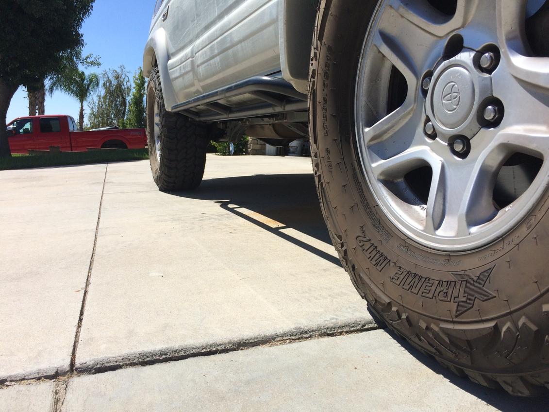

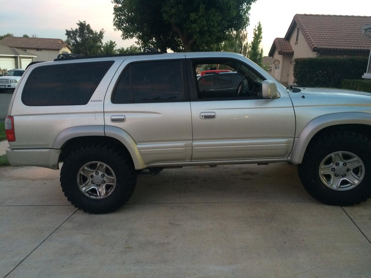

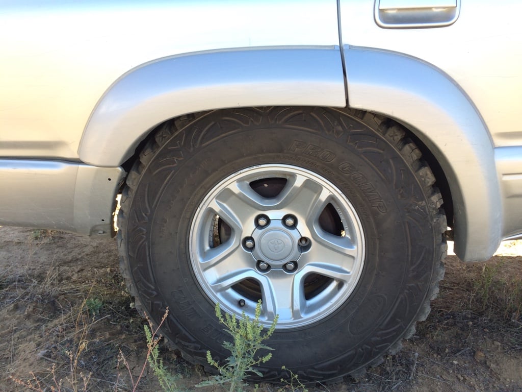

Finally got new tires. They are 285/75R16 Pro Comp Xtreme MT2's. They barely fit with stock suspension. A little bit of turning or just backing out of the driveway rubbed the shit out of the pinch weld but an angle grinder and a BFH solved that. Had to cut the pinch weld and the wheel well a bit then hammer the shit out of everything else. Now the only thing that rubs is the frame at full lock or when the suspension is fully flexed offroading but very minimal. Plan on lifting and cutting some more soon but I've been lazy.
Also got the rear coils off an FJ80 for $40 so there is a start to my lift. Planning on Bilstein 5100's for a Tundra, Toytec/Eibach Front Coils and no body lift.

Looks good! Just be careful with your bigger tires and disconnected rear sway bar. If you flex too much you could ruin your body or maybe bottom out your shock haha.

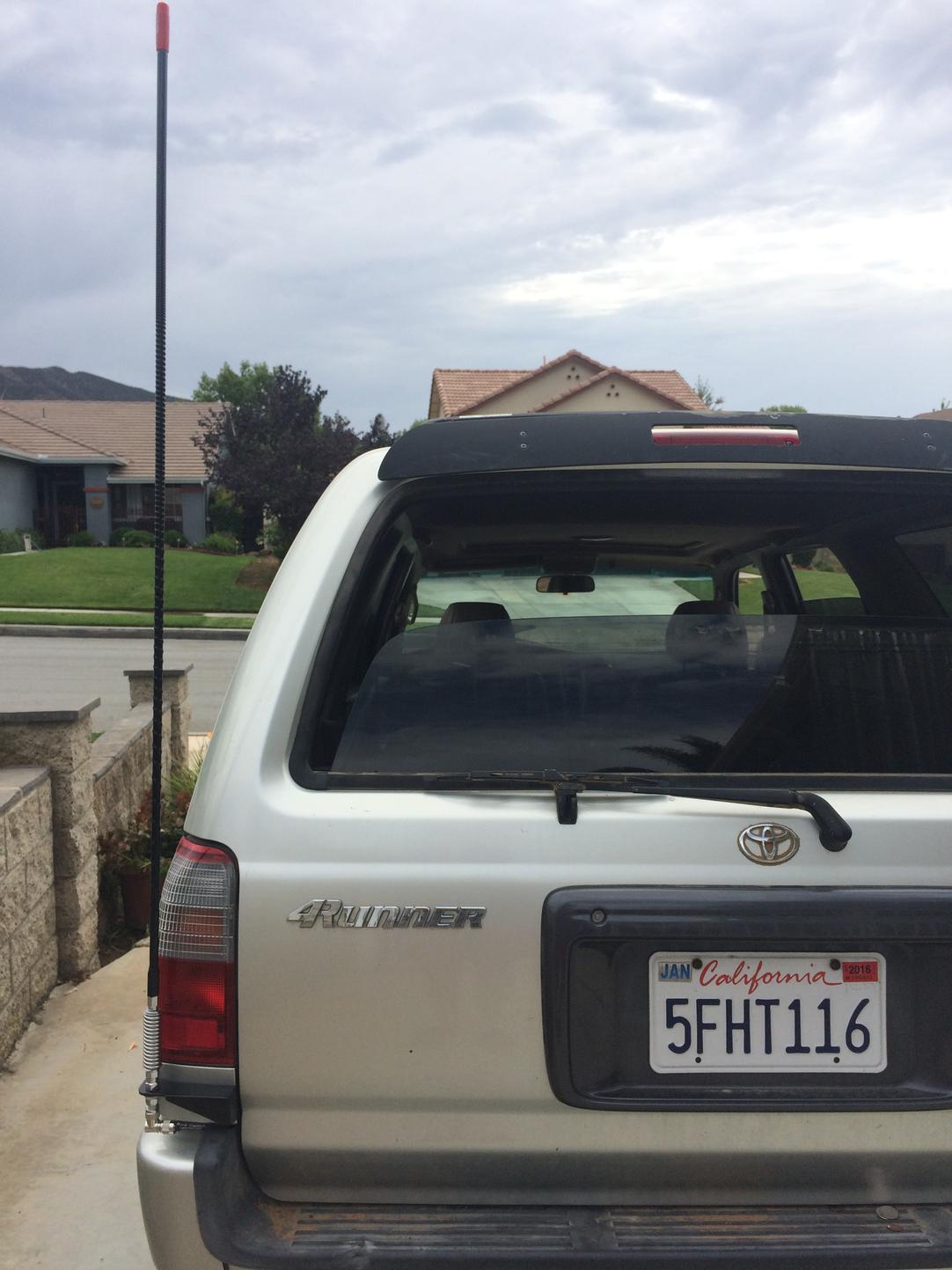

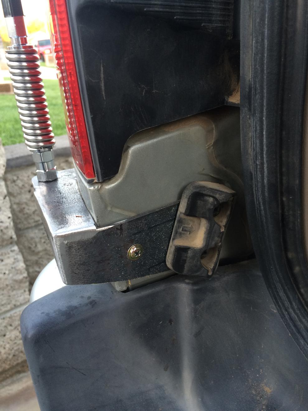

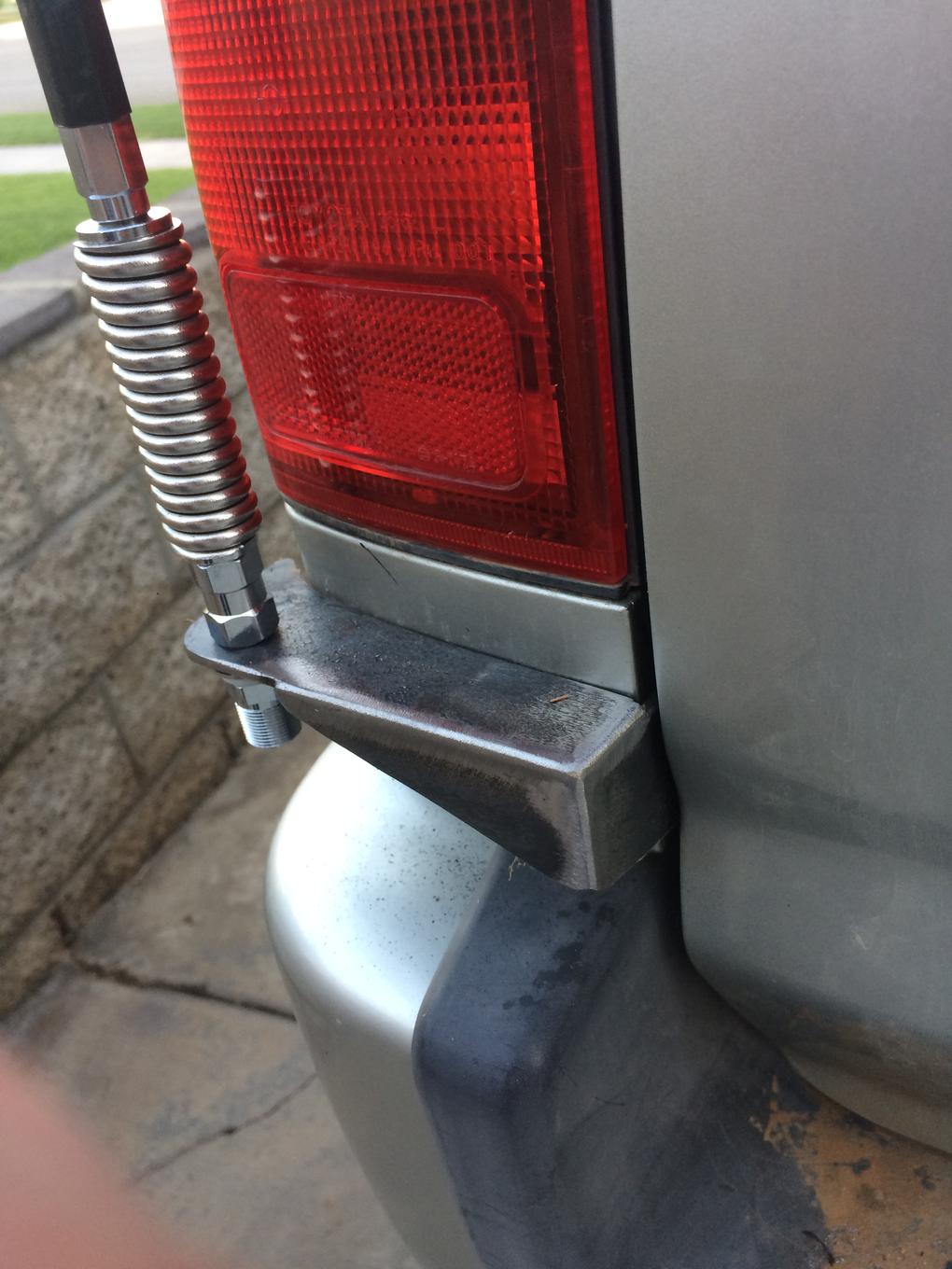

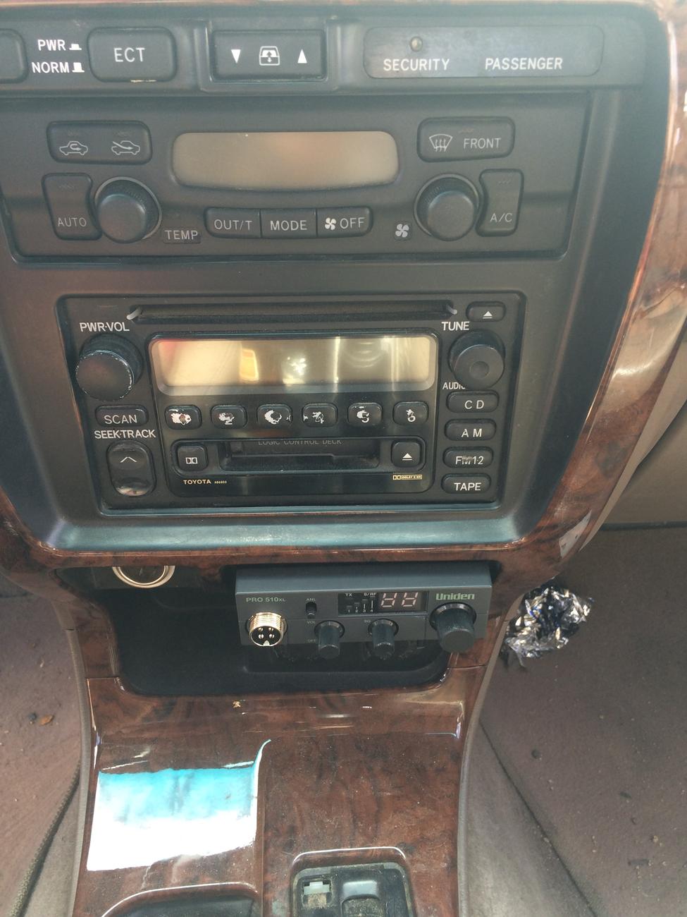

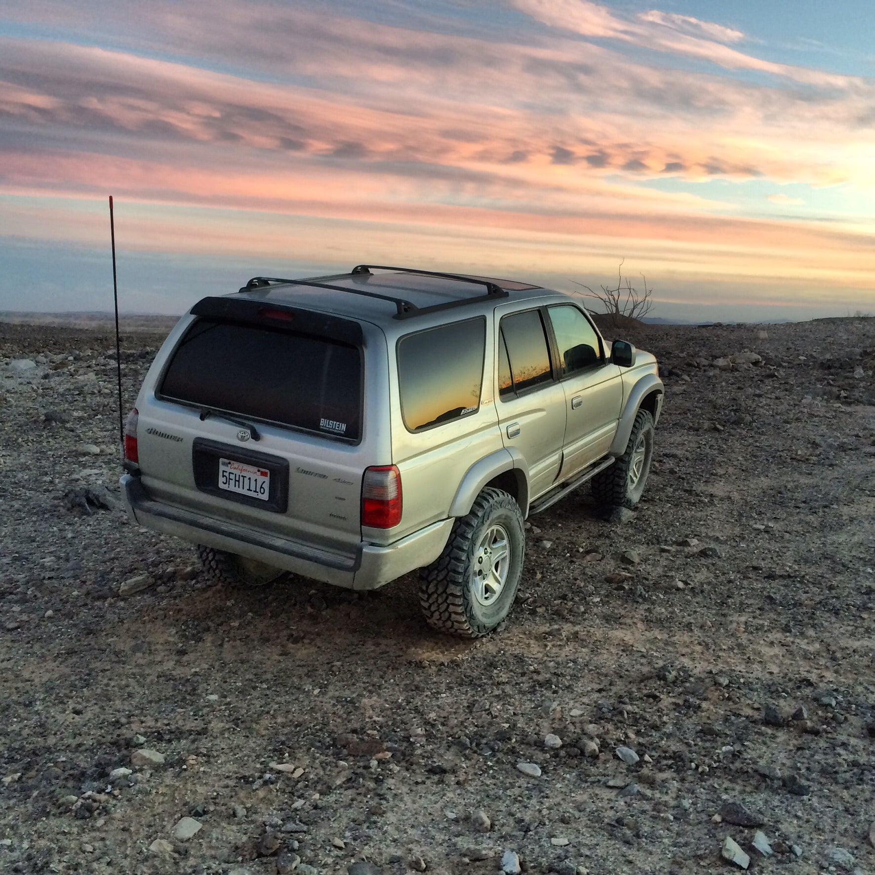

My family got me a CB radio for my birthday and I got it installed over the weekend. I got a Uniden 510xl CB radio, 4ft Firestik, 18ft Coax cable, antenna mount and spring, and two 90 degree adapters for the cable. I built an antenna mount and mounted the radio in the ashtray slot in my dash. It all turned out pretty well. I'm still waiting on the second 90 degree adapter and a SWR Meter to come in so I can get it tuned and finished.

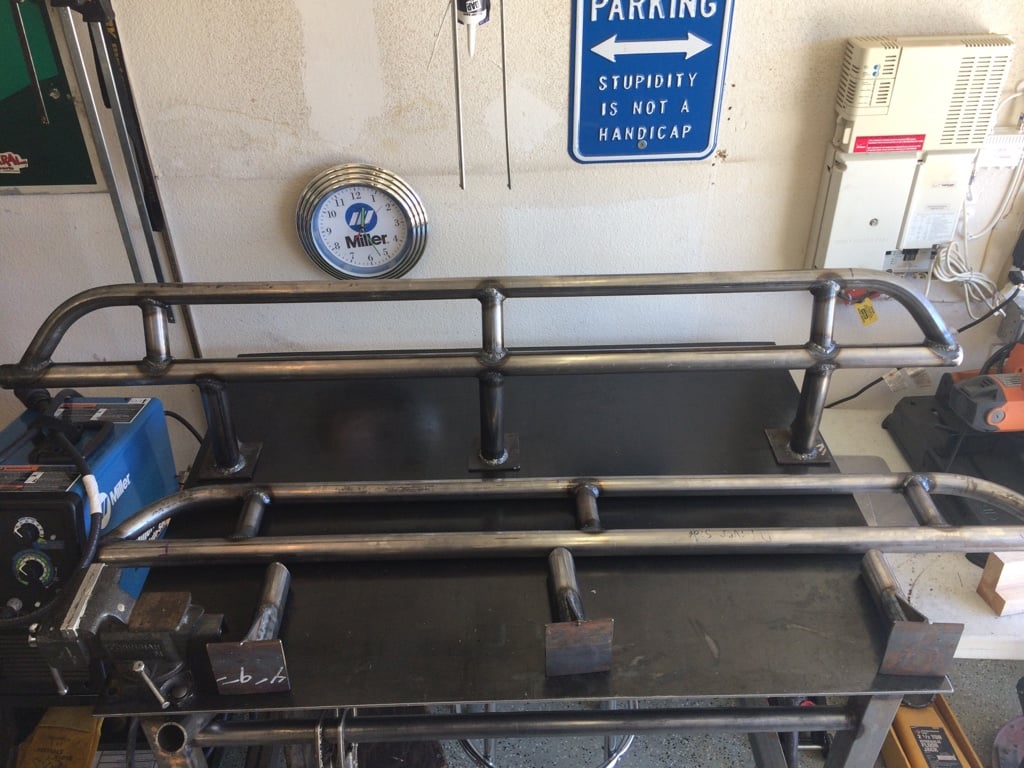

I plan on building some rock sliders this weekend. I will try to take some pictures and post them when they are done. (if they get done)

That mount looks great! Nice job
Thanks SRQ-Runner! I tried to make it match the lines the best I could so it took a while to get it lined up perfectly

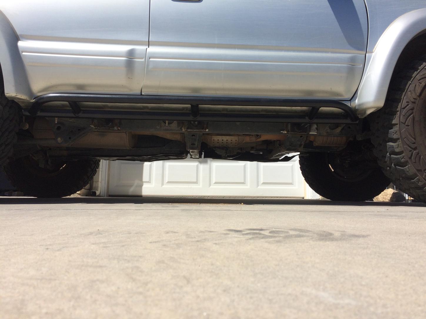

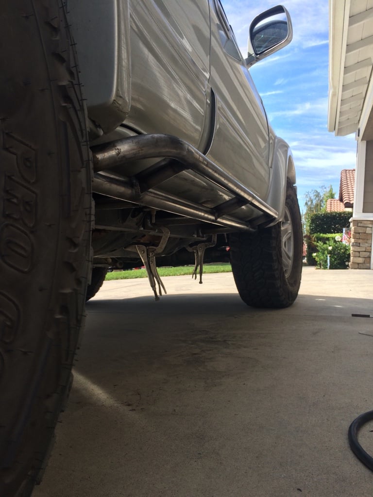

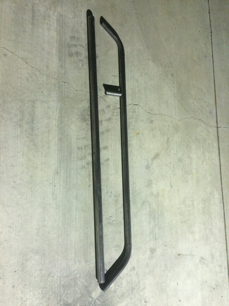

Started my rock sliders over the weekend and almost have them ready for paint. I haven't decided if I want to paint them a gloss black or a silver or gray color yet. What do you guys think?

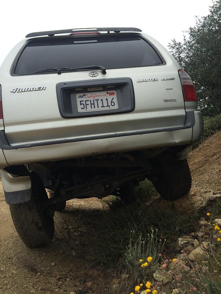

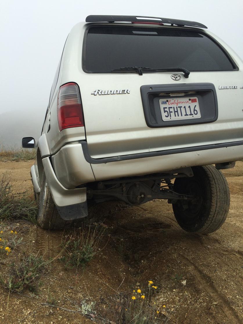

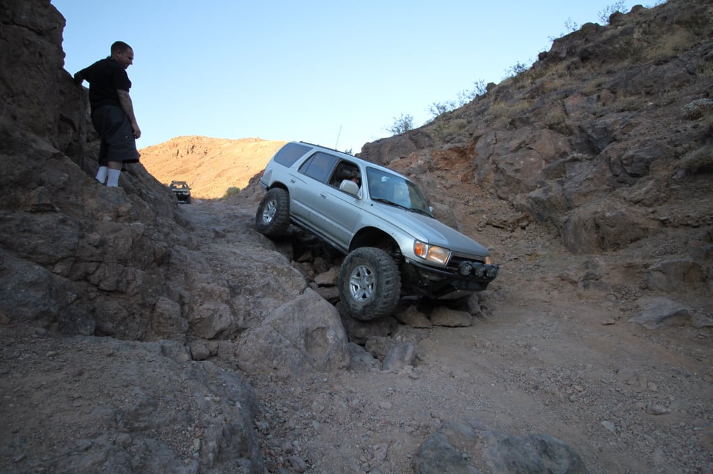

Rock Sliders are done being welded and have the first few coats of paint on them. I'm hoping to get them welding on the truck tomorrow morning. Also just got my SWR meter today and went to tune my CB and it was way over 3:1. I'm pretty sure it's my ground but I'll check that out tomorrow morning. While I was out I got a couple flex shots
Stuffed

Finally got my sliders all finished up and mounted. I was a little worried about the sliders flexing with the vehicle weight on them so, I decided to use a hi-lift and jack it up by the sliders. I didn't notice any flex in the sliders with all that weight.
Also got my CB radio tuned. I had a bad ground because I painted my antenna mount and there was no metal on metal contact. I just cleaned up the holes for the bolts and the antenna. I got it down the about 1.3:1 and it seems like it picks up everything

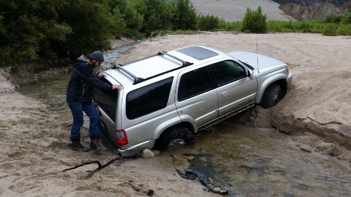

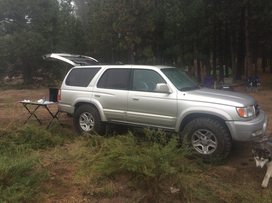

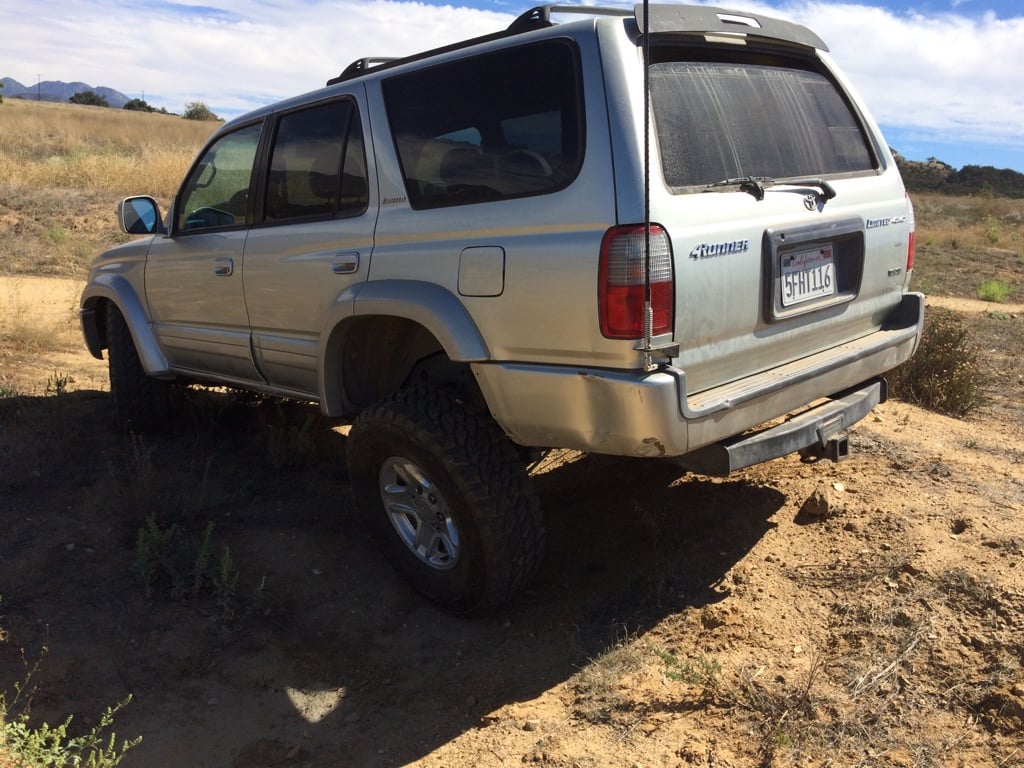

We went to the Offroad Expo yesterday and I just got some tire deflators, a tow strap and some d-rings. After the expo we went camping at Thomas Hunting Grounds near Angelus Oaks with the family and some friends. I did a little bit of wheeling on the way back home and ended up getting stuck pretty bad. I got to use my new strap and d-rings unfortunately I went through a water crossing behind Seven Oaks Dam and it was really sandy. My tow package got hung up and I lost all traction in the rear so my front just dug right in. We tried to dig ourselves out with no luck. My dumbass went by myself and to a place with no cellular service. I had to walk back up the dirt road about a mile in the rain just to call my brother to come save me. It took him about 2 hours to get there. We had no food, water or beer to pass the time so I just took a nap.
Sad thing is my brother and my dad both have XJ's so they had to talk all kinds of crap about Toyotas after I got pulled out.

Yeah all my wheels were spinning at idle even with the locker on. It was like quicksand. I was immediately stuck as soon as my tow package hit
you need the front coils of an 80 actually. although they may fit haha.
