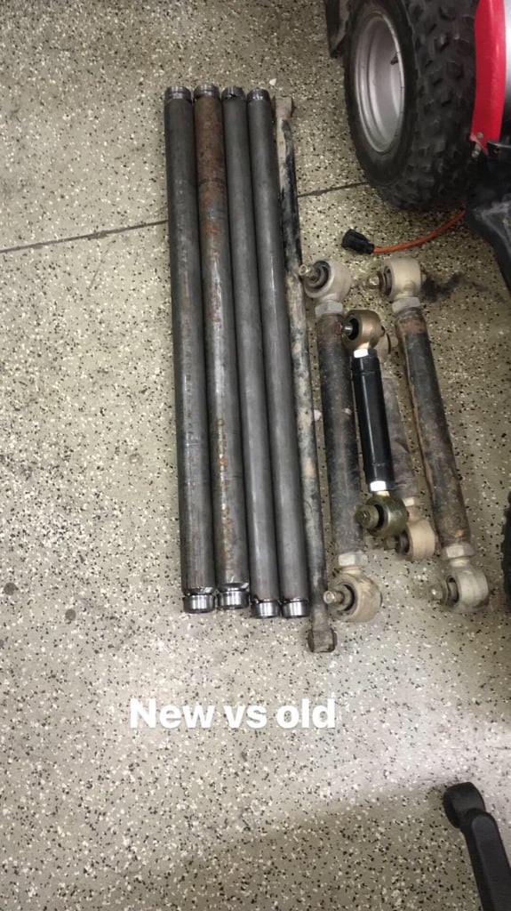

Stock links are 20” and 11” long
New links are about 42” and 42.5” long
I will post more pics as I get further into things. If anyone wants any specific pictures or measurements, let me know.

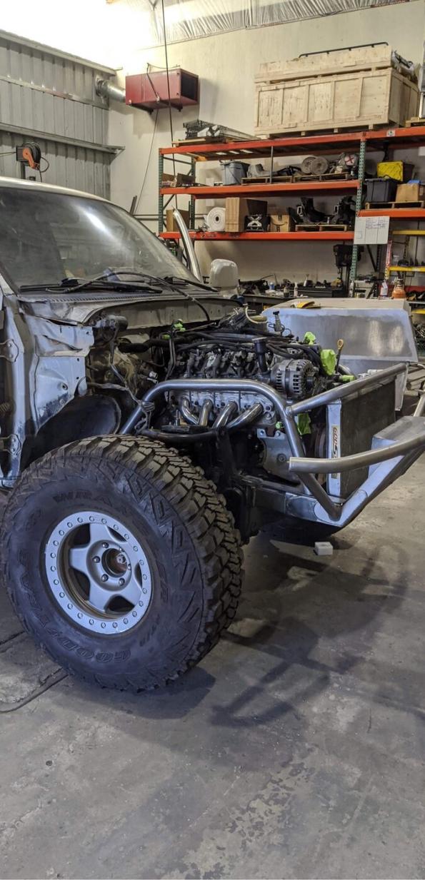

Slowly making some more progress on things. [MENTION=100687]Konkordmusk[/MENTION] is doing the motor swap for me. Once he buttons that whole thing up, I'll be picking it up and working on the cage, and front/rear long travel.
Also been working on Roberts 3rd gen the last couple months. Here's some progress of what we have going on.
