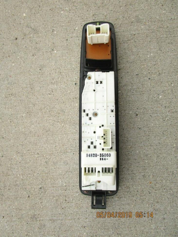

Also, where is that P7 connector?

Quote:
I think you can see it here it is on the lower part of the second picture...98 - 02 TOYOTA 4RUNNER LIMITED FRONT LEFT SIDE MASTER POWER WINDOW SWITCH BLACK | eBay

Thanks Pavel! I see that these wires leave the fuse block thingy via connector 1C. Since I want to wire the switch near the clutch start cancel button I'll try to tap into them there.

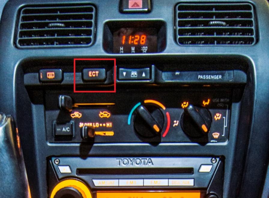

Quote:
Originally Posted by TheDurk View Post
Yeah, that'll work. Sunroof should be live, too.
Since I drive a manual, I found the center dash board switches above the ac/heater controls in a junkyard and replaced the original and used the ECT button to make the same type of switch but it turns on all the accessories, without the key in the ignition. It's nice to turn on the radio or charge something for a few minutes, but it will drain the battery if forgotten.
Power window  modification-ect-switch-jpg
I suggest if you want to prevent battery depletion from forgetting manual override switches like these ones ON, use a small circuit board that breaks the circuit once the voltage drops below a preset one, that you can set yourself with a small potentiometer on the board. They are available on ebay and are a few bucks and they themselves use very little current, like an alarm LED.
