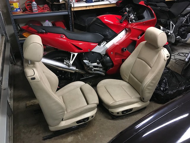

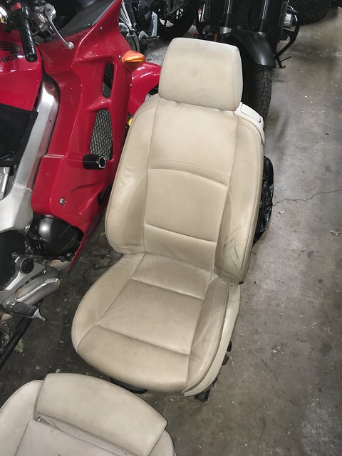

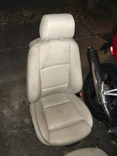

Looked simple enough. However, F30 seats are still expensive and hard to find in most junkyards; these are the 2014-present BMW 3-series. His initial thought that they were E90 seats was interesting and there's a lot more E90 seats available in good condition at reasonable cost at junkyards as of this writing - these are the 05-13 3-series and being older though recent are very common to find crashed in yards; the earlier E90s can even be found in uncrashed condition with failed engines or expensive failed electronics that sent them to the scrappers. As my front seats are trashed and not all that compatible with my back, I decided to look around and see if I could find some decent E90 seats; I scored this set of 2009 E92 (BMW 3 Series E90 Coupe) seats for cheap. These are the best seats available in the E90s, the power Sport seats with four way lumbar and seat heating; E90 seats are available in manual or power, regular or Sport (with additional bolstering and slide out thigh support), with or without seat heating and/or lumbar. These power Sport seats have adjustable bolsters, where you can adjust the width of the bolsters.
IMG_7793
IMG_7781
IMG_7782
They do need some cleaning but that should be simple enough.
More to come as I put these together with my truck; I'll try to do better documentation so others can follow along. :)

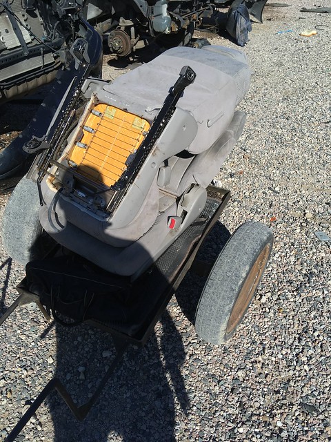

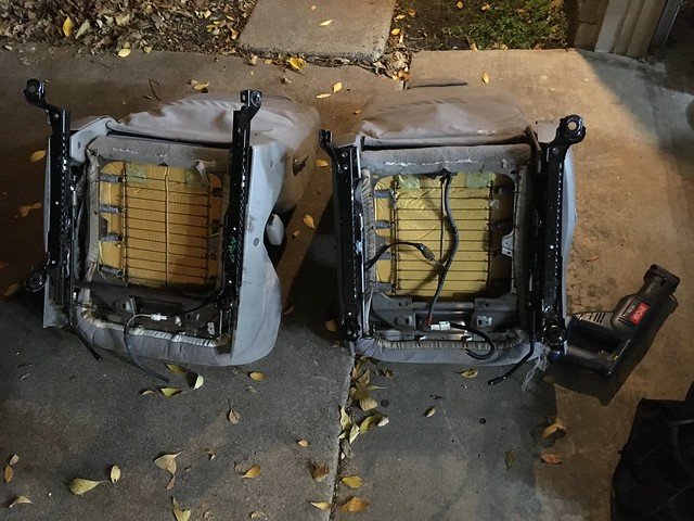

After some thought and noticing I had some Pick-N-Pull credits/coupons that would be expiring soon, I decided I didn't want to chop up my original seats in case the E90 conversion didn't go well. Instead, I went to Pick-N-Pull and ripped some cloth manual SR5 seats out of a dead 4Runner to serve as bracket donors.

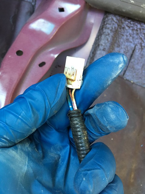

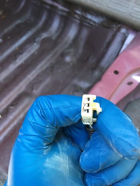

Wiring information I found, supplemented by my reply, on another thread:
The EWDs show that both '98 and '99 go through a three-pin connector under the seat, but not the same one. The power for the seats is a blue wire on Pin 1 and a ground is a white-black on Pin 3. Since the seat is the one with the extra wire just disregard it. I can't find what it goes to but it is not the power seat circuit. So the power seat circuit doesn't need it. Just connect blue to blue and white-black to white-black and ditch the connectors, or use any mating set of two-wire connectors you can find.

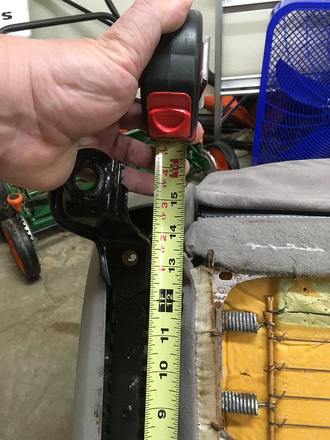

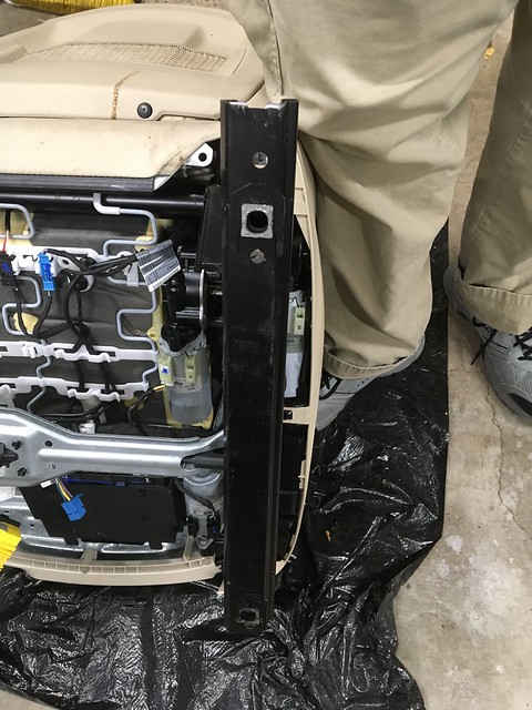

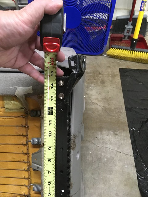

Its looking more like the E90 seats aren't quite so much of a bolt-in as the F30s were. May still be doable with just drilling a couple new holes in the rails, but I'm starting to lean more towards welding the brackets onto the rail. That said, it would likely be a simple task for a welder and therefore not terribly expensive.
One reason I'm thinking the above is that the E90 seats have ~1/2" (more likely 13mm) holes for bolts to hold the seats to the floors. The Toyota bracket holes are 5/16" or smaller once you've drilled out the rivets and spot welds - yes, I can confirm that the brackets are not only riveted but spot welded to the rails.
IMG_8009

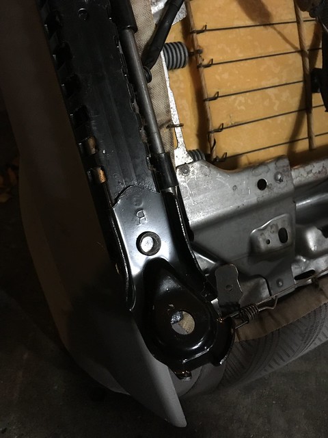

One spot weld is visible as a circle above the reverse-stamped R on this bracket, above the partially drilled rivet.
IMG_7971
Another issue is that the 1/2" holes have a reinforcing surround as part of the rail that makes it a bit problematic on one side. It makes it a bit difficult to mount up the outside rear corner leg because the holes are inconveniently placed. This isn't helped by the fact that the brackets aren't mounted the same distance apart on the Toyota rails. The outside brackets are riveted on 13.25" hole centers and the inside brackets are on 14.25" hole centers:

The 14.25" hole spacing is roughly the same as on the BMW rails, but the 13.25" spacing could be an issue as that puts it right in the middle of the BMW seat rail rack.

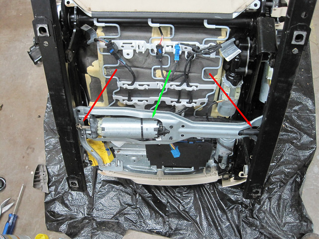

Turns out E90 seats aren't direct bolt ups. As feared, the shorter bracket distance on one side of the Toyota's seat turned out to be incompatible with bolting up the brackets to the E90 rails. However, that doesn't mean they can't be used in the 4R, just that it takes a little more work.
The reason: As mentioned above, one side has brackets mounted on holes centered 14.25" apart, and that matches up well with the factory BMW mounting holes. Unfortunately, on the other side, the hole centers are 13.25" apart and that basically is incompatible with the BMW rails without making adapter brackets that would raise the seat up beyond where I want it. Here's why that's an issue.

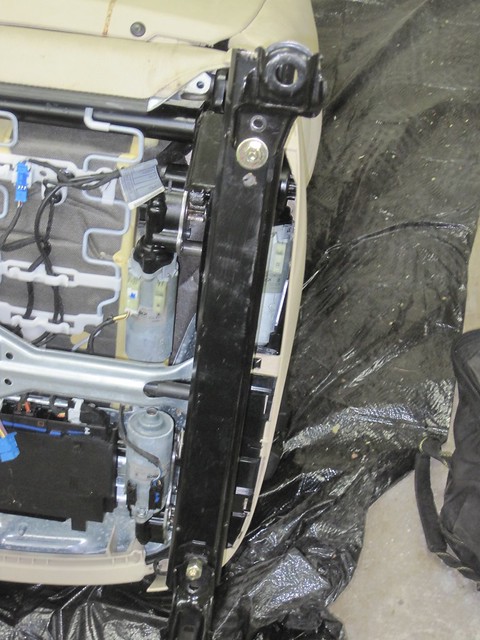

IMG_2477

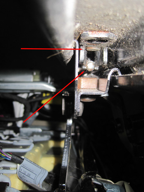

In the above picture, you can see the four shiny squares on the rails where the BMW seat is bolted into the car at the factory. These are reinforced with additional layers of sheet metal; the holes in those reinforcements/the rail are a nominal 12mm wide and 9.5mm deep. The green arrow points to the motor that moves the seat fore and aft on the rails, the red arrows are where the motor's output shafts (Bowden cables, actually) enter the rack and pinion drive on each rail. This means that there's a threaded shaft over the rail that is riveted to the rail near those mounting holes and blocking access to the rail from above in the area the shaft runs. You can see a detail of the riveted point in the below picture.

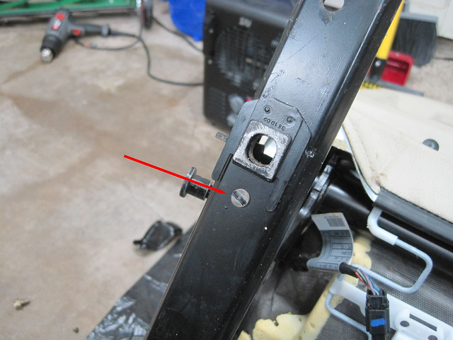

IMG_2487

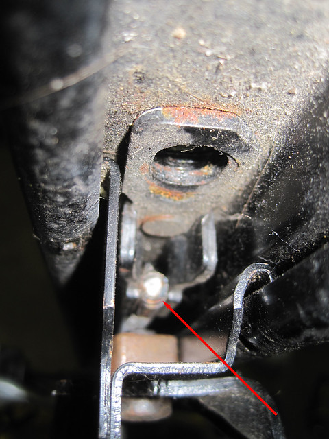

Here's what's on the other side - the top red arrow points at the rivet and the bottom at the threaded shaft.
IMG_2481
The arrow here points at the threaded shaft.

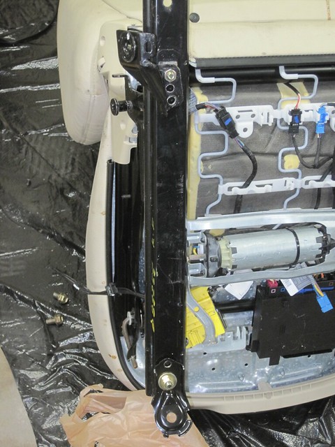

IMG_2480
On the outside rail of the seat, the brackets bolt to the factory BMW holes just fine and will be in the correct position to mount into the truck.
IMG_2500
On the inside rail, it just isn't happening. Even if you bolt the brackets in using the holes that produce the shortest distance between the brackets, you are still over half an inch too far apart to get the thing to mount in the truck.
IMG_2499
And, because of that rivet on each end plus the rack it's holding on, there's no way to drill a hole to mount the brackets closer together and still bolt everything down. So, it looks like if you're looking for an easy pure bolt-in solution with some hole wallowing you're going to have to use F30-series seats.
However, not all is lost. The rail spacing is fine, the rails themselves are nice and flat and the seat is self contained, still making them otherwise ideal swap candidates. I'll just have the Toyota brackets welded to the BMW rails. This project will be proceeding.
