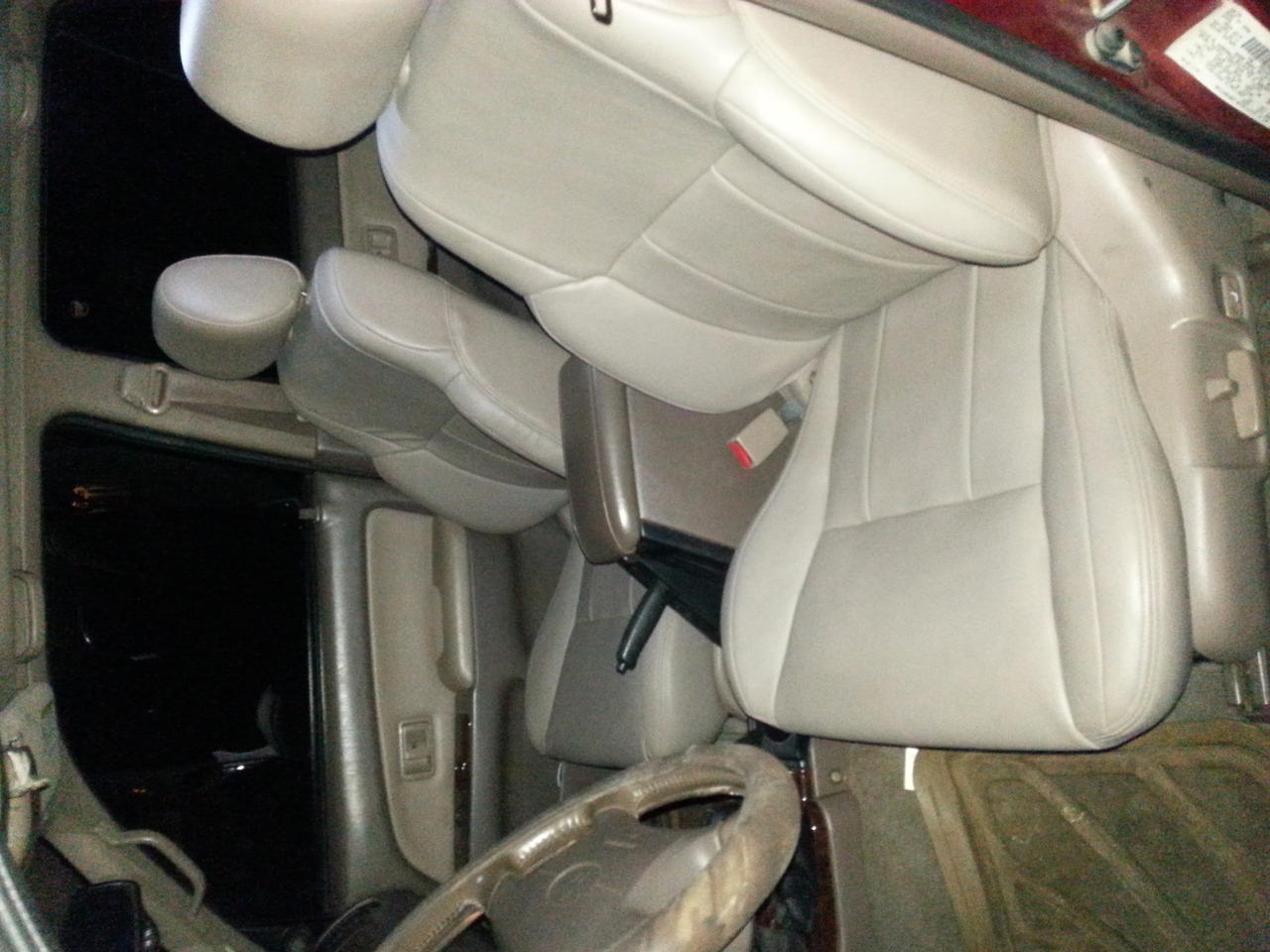

Or get ya' some of this. I had the leather and foam replaced on both my front seats, tops and bottoms for about $757.\
For those looking for smoother shocks and a smoother ride THIS is the way to go, unbelievable comfort now. The new foam is awesome, it "steps" from soft pillow to firmer and firmer as you push on and it never bottoms. I am So happy with the results, I was only after new leather but the guy said lets do new foam even though I though it was ok, glad he talked me into it!
Pic is at night but shows the results. :cowboy:

That came out great! $757 for new leather, foam and labor is pretty damn good. I actually haven't reached out to any local shops yet.
