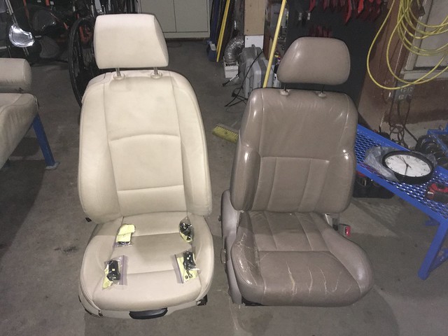

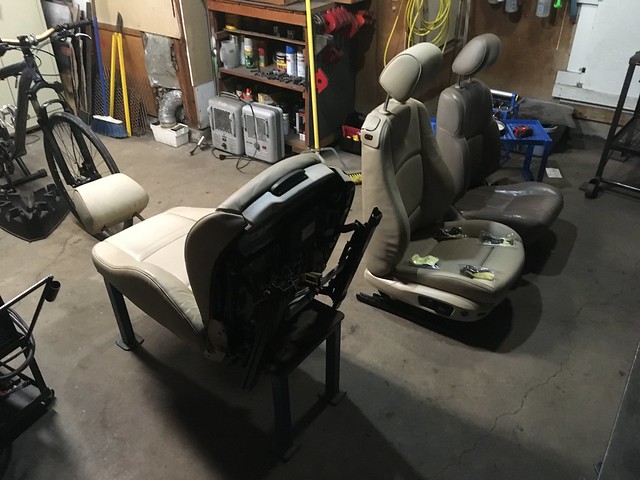

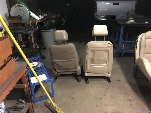

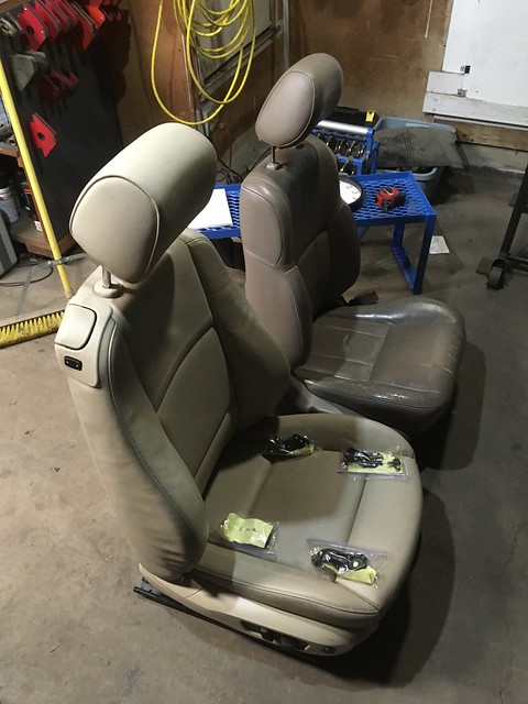

Dropped the BMW seats off at the welder's last night and left my passenger seat with them as a direct example so they didn't just have to work off my measurements. Some direct comparison shots - keep in mind that the BMW seat has flat rails but with the stock brackets on the Toyota seat cannot sit level on a floor.
IMG_8072
IMG_8070
IMG_8068
IMG_8065
I now have a final price list for the conversion.
2009 BMW E92 (coupe) seats with part of the BMW's wiring harness included as a pigtail (yes, I will do the electrical stuff in the thread soon): $150 for the pair
1999 4Runner Limited power seat wiring connectors: $5
2001 4Runner SR5 cloth manual seats for bracket donors: $50
Welding charges: $70
Miscellaneous leather cleaning products and wiring supplies: $50
Total price: $325
By way of comparison: Leather seat back cover for driver's seat, which is ruined on my truck: $446.56 from Camelback Toyota.
I did get a deal on these seats - average retail on them in my area seems to be about $200 each or $400 the pair if you want top of the line seats from an E90 coupe (AKA E92). The sedan seats are more or less the same except they don't have the shoulder mounted manual seatback flip release or the shoulder mounted fore and aft traverse seats; those go for $100-150 each. If you want the non-sport seats without the adjustable bolsters and such, they are usually about $25-50 less and manual versions are often cheaper still. That said, most BMW owners don't like the standard non-sport seats. Both Sport and non-sport seats are offered with or without heaters and lumbar.

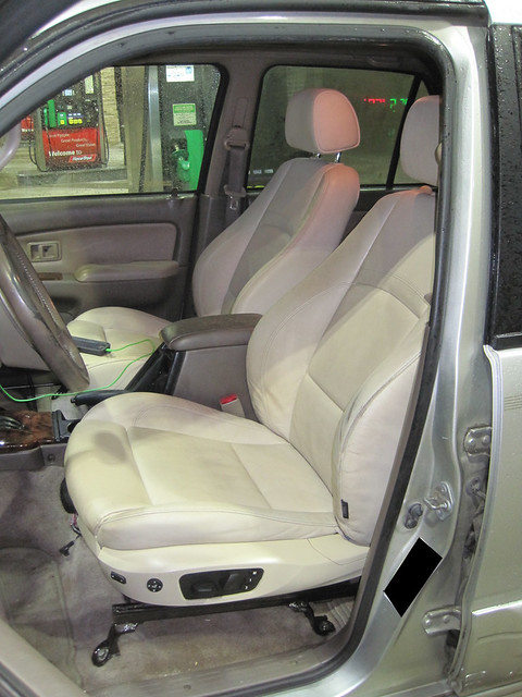

Looks awesome! So, sounds like a momentary NC switch could be used as a "wake" button, if mid-drive seat adjustments were needed.
I wonder what it would take with something like this to fool the seats to stay awake...
https://www.sparkfun.com/products/13262
That's a bit of overkill - apparently you only need to provide +5V and ground to a couple wires on each seat to keep the seat computers awake. A simple 12V to 5V converter will suffice and I'll order one in next week.
That said, I'm not entirely sanguine about the original Toyota 30A power wire when connected to the BMW seats - but I'll post more about that later after I recover from the all-nighter I pulled putting the seats in.
Ah - I figured it was waiting for specific CAN messages when I was glancing through. Converter - just use the guts of an old phone charger or the likes - most are 5v for USB
I wouldn’t be too worried about the power wire. It will be used infrequently, and only in short bursts. Wire ratings are for continuous current handling anyway.
You'd think it would be looking for CAN messages, but apparently it doesn't - just wants to see a carrier, as it were. -shrug- Others have found this out previously.
As for the power wire, I've looked at a couple of dead 3rd gen 4Rs in the junkyard in the last couple of days and they show evidence of scorching on their power seat wire too, even with I guess sporadic use. Since I'd like to get the seat heaters working on this thing long term, I don't think I can use the original Toyota power wire for that.
