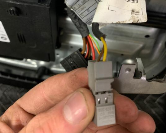

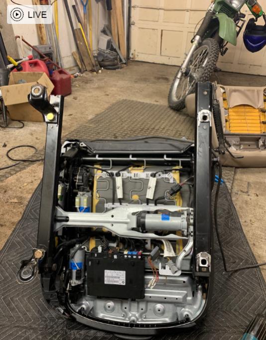

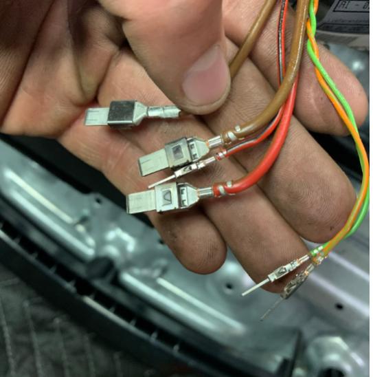

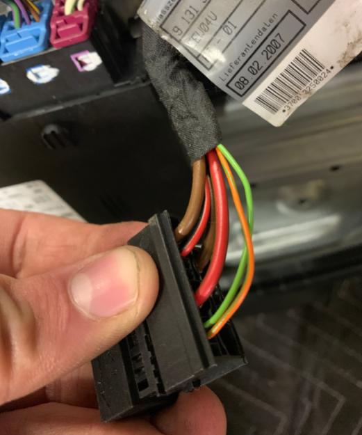

So I got the seats and I bolted the outside legs on. For inner leg placement, I’m going to bolt the inner legs down in my parts truck, then bolt the seat in and tack weld the feet in place. Then I’ll remove it from the truck and finish the weld. My question lies in the wiring. I’ve attached a photo of the two plugs on the BMW seat. Would you be able to tell me which wire to supply 12v and ground to? Also which one needs the 5v feed? I’m guessing the orange and green are 5v feed/ground, but as you mentioned, I don’t want to try the wrong wire and set off the airbag.

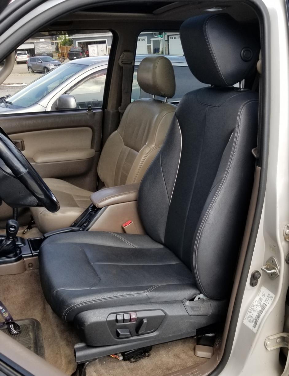

So I figured out the wiring today and got the driver's seat installed. I found out by searching the BMW part number on the wires that the plug with only two wires is for the airbags, so this gave me the confidence to play around with the other wires and figure it out. The seat heater wires are still a mystery but I'm not too torn if they don't work. I've ordered the voltage converter to try and stop the seats from going to sleep with a constant 5v feed. I'll update on how that works.
As for the fitment, I'd say there is nothing easy about this swap. It's just convenient that the BMW rails are flat. For me, only one bolt lined up and when I bolted it where OP said it would work, the mounting hole was like an inch off. I ended up having to weld the other 3 legs on. Not a big deal for me, but not really an easy swap to do. Also, the seats definitely sit higher then the 4-runner seats did. I can't tell if it's going to annoy me yet, but I'm 6'0" and my head is 2" from the ceiling in the lowest setting. the seats are mighty comfy though.
The passenger seat seems to have many more wires then the driver's seat... like 7 more... OP have you figured out what all these wires are for? That's tomorrows project!

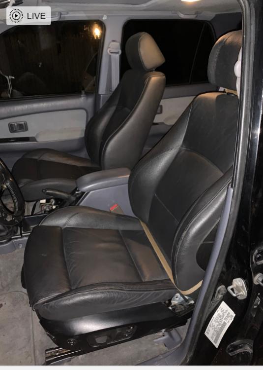

Got them in!
Finished the passenger seat today! it was a ton of work and it seems like nothing about this swap is bolt in. oh well, I'm pretty excited about the seats.
It seems as though my passenger seat didn't have the "sleep" issue. I ran a 5v converter to the driver's seat and that's working well.
I still have yet to figure out the heated seat components. I'm thinking of just finding the wires that go to the heaters themselves and wire up some sort of potentiometer to control the heat.
I'll be driving 800 miles this weekend so I'll get to really test them out!

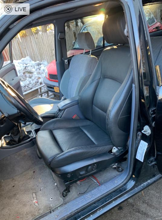

Well got my driver side installed and wired, works great. Gotta figure out how to stop them sleeping and the heated tho still.
