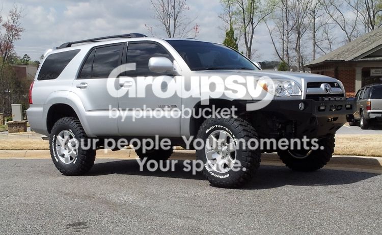

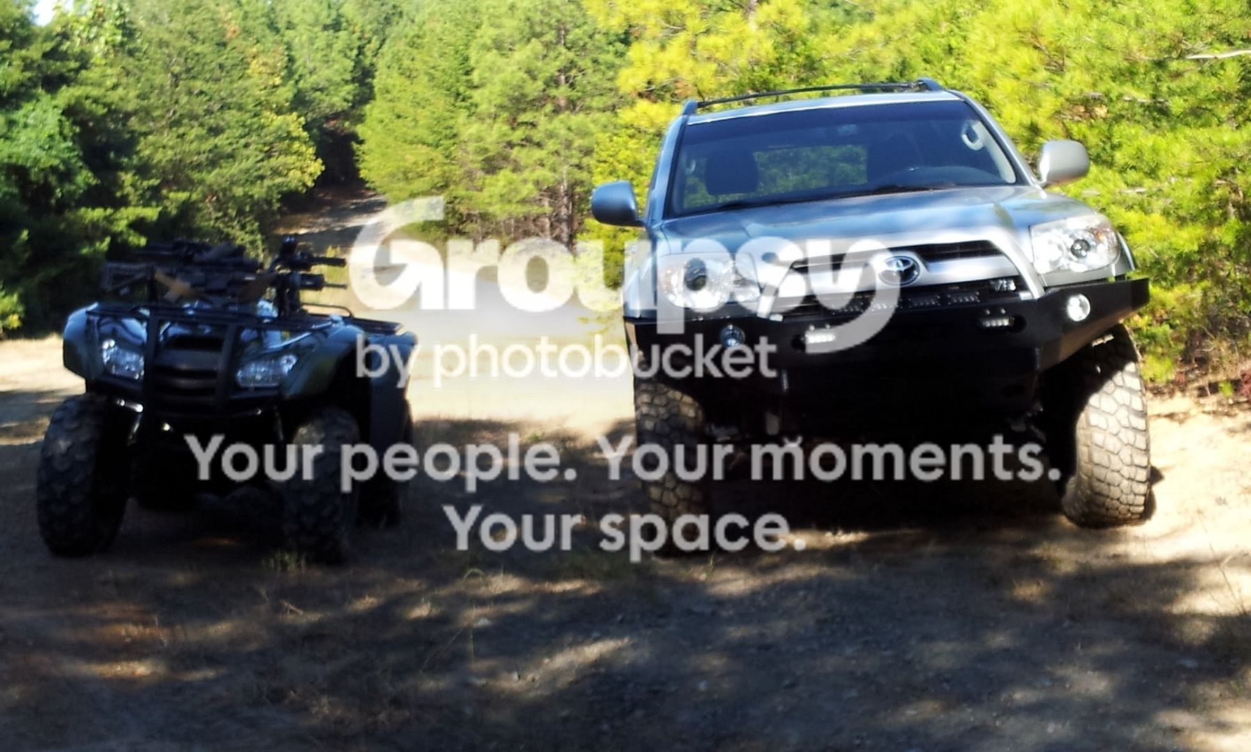

Ask me how I know, it not going to happen. I have 255/80/17 KM, it has the following.
Front :
1.5" BL, OME 3" #886/N9000, 1/4" top plate, TC Control Arms
Rear:
3.5" all-pro, 1.5" daystar spacer, bilstein #5160 w/ RR, AF Upper & Lower Control Arms.
IMAG1001_zps0fc19b9f.jpg~original
IMAG1000_zps9f4744ac.jpg~original
