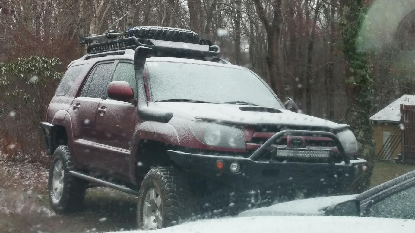

I run 255 80 17 KM2s on FJ wheels, i have more lift plus a body lift and i dont run at all (maybe a tad on the front body mount under extreme conditions) i really like the size and they kick ass offroad.
I agree. I can remember whose truck it was that I first seen the tall skinnys on but I fell in love. I will probably also go the fj wheel route to get some offset. Badass truck btw...
I have them on FJ wheels, no rub on the front anywhere even off road. I have an aftermarket bumper and UCAs which surely helps. I get some rub on the back at full stuff but it isn't a big deal. Toytec ultimate kit, front adjusted to about 2.75 in lift.
