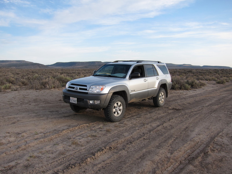

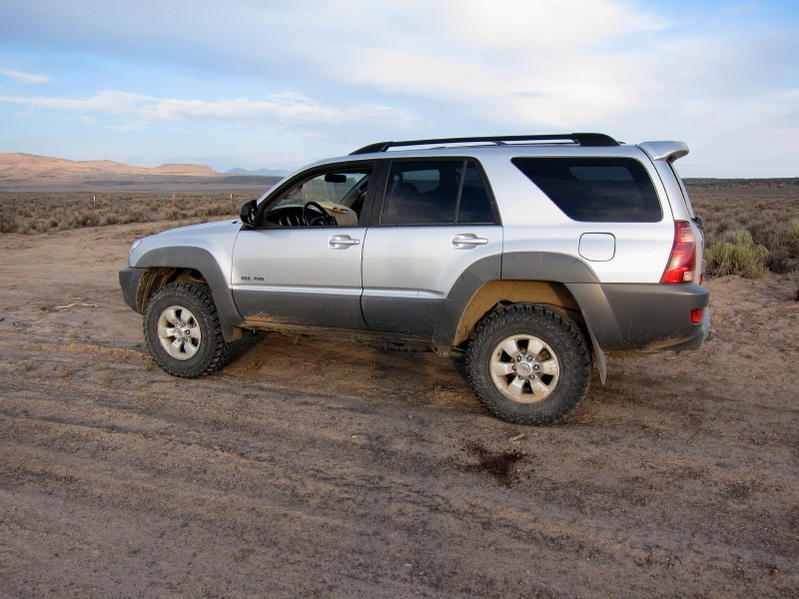

Since you are thinking Cooper S/T Maxx... I'm running 235/85/16s on mine They're a 32 inch tire, just 8/10th of an inch shorter than the size you are looking at. I have no issues at all with rubbing and the spare will fit under the rig. I'm very happy with them so far (about 6000 miles). I've got the 5100s all round with the front at 2.5 and the rear with 2" Toytec superflex coils and stock wheels.
