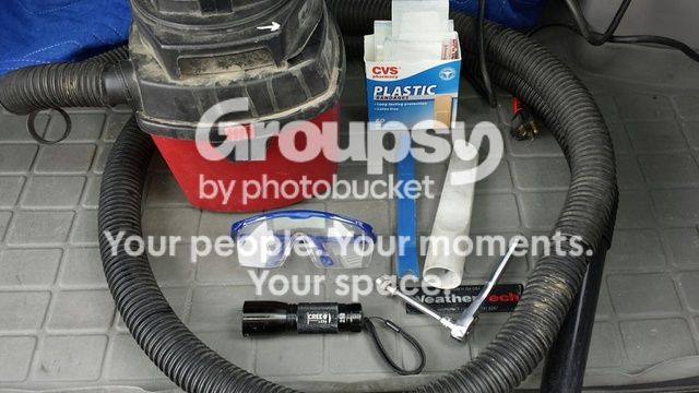

Here are the tools I used.

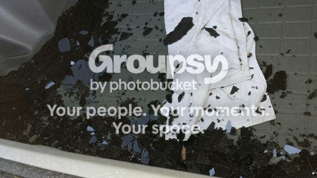

First I cleaned up the mess. This meant vacuuming up the glass from the weathertech mat and from the carpet, from all the plastic trim in the back (amazing where it goes), in the rubber seals, and also picking the glass out of the weather seal around the door where the glass fit before it broke. I used the shop-vac to suck the glass up as I picked it out of the seal.

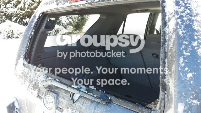

I removed the window seal and cut a piece of sheet plastic to keep the weather out. I replaced the seal and used some packing tape to pinch the plastic in place. Worked fine for a couple of days until the new glass arrived. Keep in mind that the vehicle is NOT SECURE with a sheet plastic window in the back so don’t leave your gold bullion and jewelry in the car until you get the window fixed.

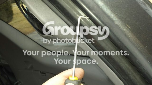

Remove the little cover plug and remove the 10mm bolt that holds the door pull strap to the door frame.

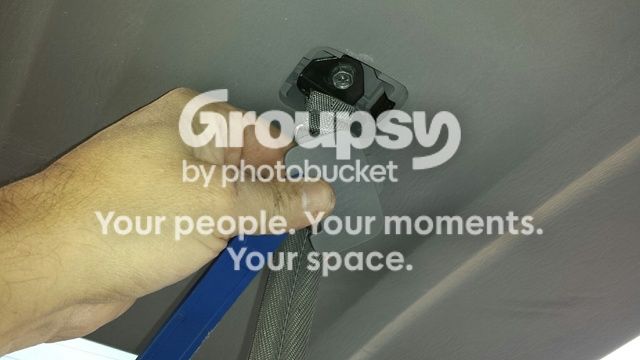

Pop the plastic door pins out with a trim tool. Then carefully pull the bottom edge of the card out and push it upward to remove it. Keep in mind there is a seal on the top edge of the door card that hooks into the top edge of the tailgate that you do not want to damage. BE SURE YOU’VE CLEANED THE GLASS OFF THE TOP EDGE OF THE DOOR CARD AND DOWN IN THE SEAL or you’ll get a face full of glass shards.

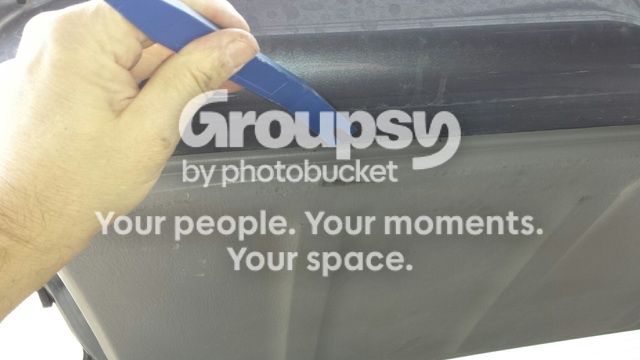

Once you have the door card off, carefully remove the sealing plastic from the door frame. Preserve the bead of adhesive stuck to the plastic so you can re-stick it later.

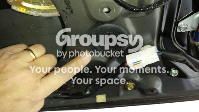

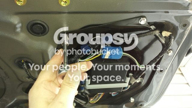

Remove the sheet metal screws that hold the controller box panel in place so you can get behind it. The control box is the little black 6x6 black box on the driver’s side with all the wires that’s attached to a piece of black stamped steel. The screws you remove hold the black panel to the door (not the box to the panel)
Remove the rubber plug for the access hole. Now you can get to the innards of the door.

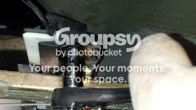

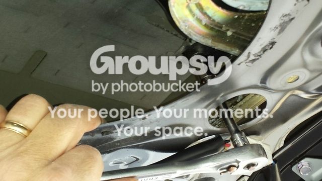

Once you have the mounts lined up, use a 10mm socket to break loose each of the 4 the mounting bolts and remove them. Be careful! They are held in with loc-tite so it takes a bit of force to get them to move. Best thing I found was to reach in with my other hand and hold the mount to keep it from twisting on the track. You do NOT want to be replacing the window regulator too because you break off one of the mounts or tracks.
You will find the passenger side bolts are easy to access. No problem there. The rightmost driver’s side bolt is accessible through the access port.
The hardest bolt to reach is the one behind the controller box panel. But if you gently move the black metal panel that the control box is attached to out of the way, you should be able to reach it with a shortie socket or box-end wrench.
Once you break all 4 mounting bolts loose, they will come out easily. Carefully remove little stub of window glass from each mount.

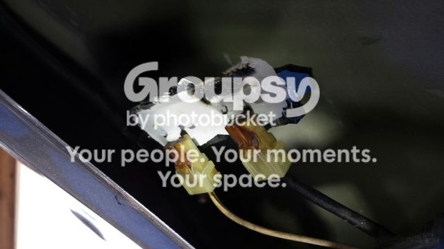

Lastly, remove the reason for all this carnage – the electrical connections for the defroster should be hanging from the passenger side mount. They’re simple bayonet connectors. Remove what’s left of the glass from the connectors. Wear your gloves as they may be stubborn and there is glass involved.

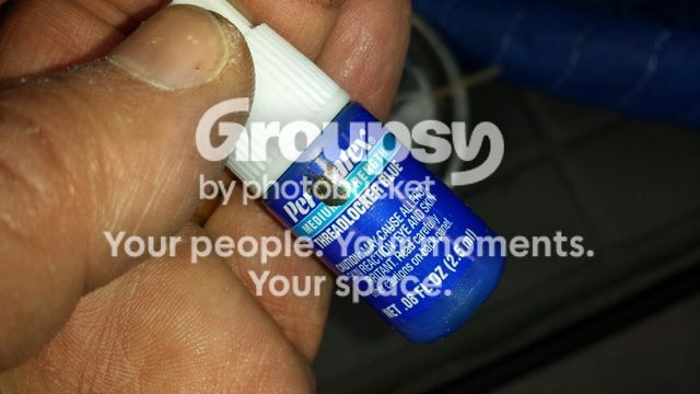

Reinstall the 4 10mm mounting bolts. Put a drop of lock-tite on the tip of the threads and start them into the mounts for the new glass. I don’t know the torque settings but you DO NOT HAVE TO KILL THEM to get them to properly hold the glass. That’s why you’re using lock-tite. Just reasonably “snug” should work fine.

Attach the defroster leads if you want. Note: I think my leads were attached to the glass upside-down. There seemed to be enough slack so I hooked them up anyway. Have to live on the edge sometimes I guess.

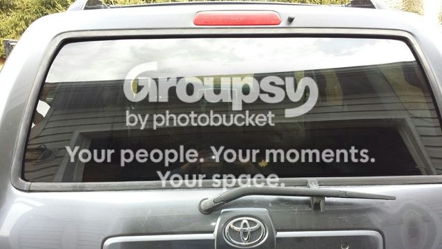

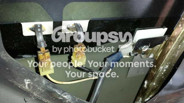

Just to add to this. Since I had the spoiler I couldn't just slide the window in like the author did. I had to remove the passenger-side guide rail inside to give me more angle room. By the way, those connectors look just like mine. Awesome write up though:cheers:
20150311_140856_resized.jpg~original

Is that new glass Genuine Toyota? Did you add the little extensions of the pads to the glass or is that how it came? I'm curious why it seems then new glass has the contacts close together like the original, but the silvered pad is split; where as on the original it seems to be one piece... Curious...
Great write-up none the less.
[MENTION=91346]emoore924[/MENTION]
I was wondering the same as mine is one piece as the original with no extension.

I too was curious about the connectors. They weren't the same as factory from what I could see. First, they should have been pointing down, not up. I could have desoldered and reoriented them but I didn't want to stress the glass with the heat from another (second) solder event. And as you mentioned they connected separately to the glass rather than the original which seemed to be connected to the **same** spot on the glass.

Maybe the failure mode is part of the conductive trace breaking where the connector is soldered on. Stress on the connector could pull on it, and part of the conductive area could break. If just a little is left, all the current going through a small area of metal will create a lot of heat. Looking at the picture of the new glass, it's unlikely that there could be a short between the two contacts. The old ones are a lot closer together, so maybe it's possible that they get shorted somehow?
Maybe someone with Toyota glass could pull their door apart and take a picture of how it looks?
