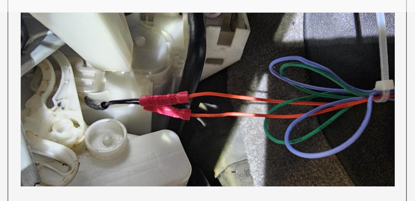

Quote:
Originally Posted by rpm5099 View Post
Based on your description that had to be the problem. I'm glad it worked out. Funny that you took out the resistor for the repair, you lacked faith!
I just used mine in the first hot weather and no question 20kohm is not enough. I'm going to install a variable resistor and adjust pedantically like a nut until I get the exact value for maximum cooling with no freezing. I've gone this far, might as well.
Onwon 20K Ohm Resistor 10 Turn Potentiometer 2W Wirewound Multi-Turn Adjustable Precision Potentiometer with 10 Turn Counting Dial Rotary Knob 6mm Shaft (20K Ohm) https://a.co/d/gh9Q00Q
I’m hoping you could provide some info on where exactly to install this resistor. Is it as simple as cutting one of the two wires and putting this in line?
A/C hot/cold - thermistor - read before replacing-img_7366-jpg
DawessCO is offline   Reply With QuoteReply With Quote

It sounds like the OP placed the resistor or the POT in parallel to the thermistor wires. I could be mistaken, however, so I'd like this clarification as well.

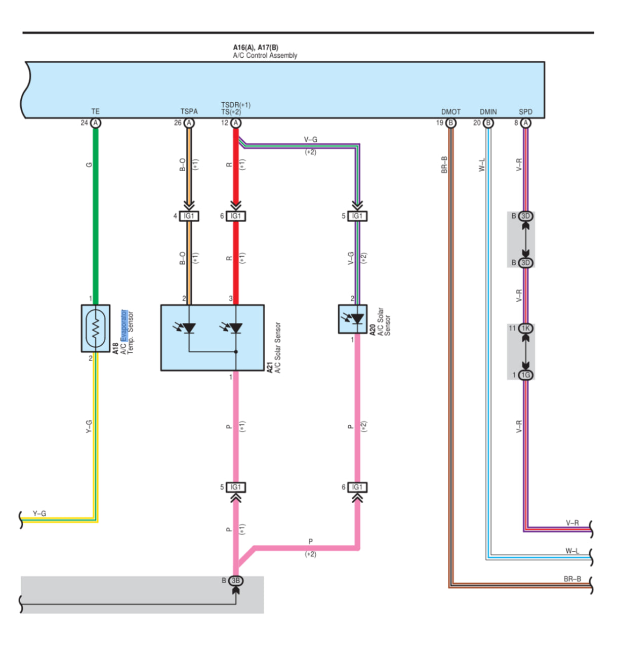

Got these items figured out:
- Why are there 3 connections on the variable resistor? Shouldn't there only be two?
There are multiple ways to wire a variable resistor depending on the performance desired, but you use wiper terminal + r1 to go from 0 to 20k and wiper terminal + r2 to go in reverse (20k to 0)
- Why is there no range listed for the variable resistor? It just says 20k ohm but shouldn't it be xxx - 20k ohm?
The range is 0 ohm to 20k ohm, or you could use r1 and r2 and get exactly 20k ohm with no effect from the knob
- And then, what knob settings map to what resistance settings? Or do you have to measure the pot with a multimeter to find out what setting it is at?
These are generally linear with some tolerance variation. Just check with a meter if you want to know exactly
- Do I need to solder the connections or is there a type of spade connector that fits the pot?
Still usure on this but I ordered the variable resistor so I'll figure it out when it arrives
- Which side of the thermistor do I wire the resistor to? (pretty sure it doesn't matter)
This apparently needs to be on the SIGNAL side which according to this diagram would be the GREEN wire. 80% sure on this, would love confirmation.

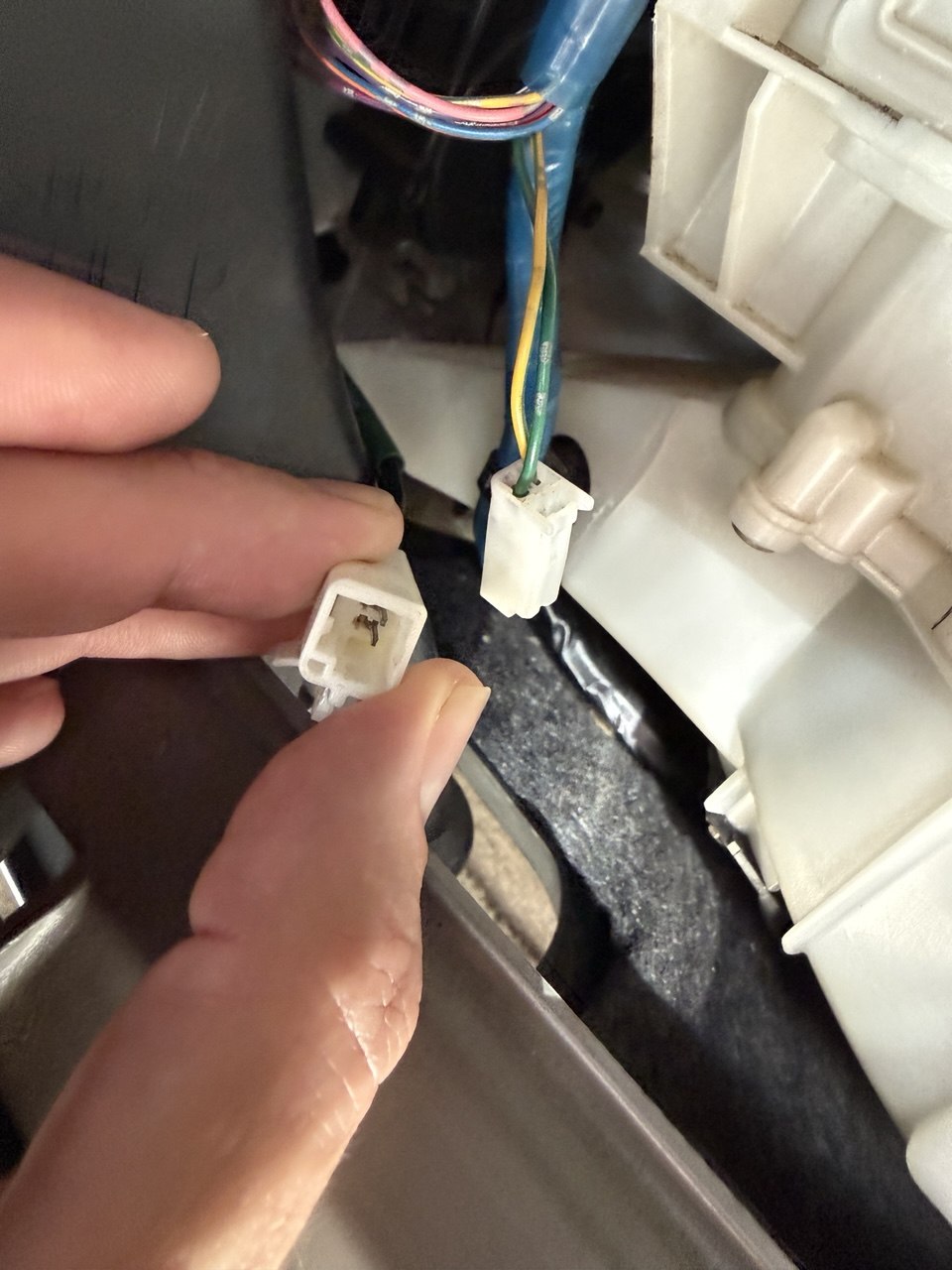

Pulled the glovebox and checked the wiring for the thermistor. The colors do match the diagram. There isn't a lot of room to work with the wiring and I don't want risk screwing it up trying to crimp it so I think I want to get a set of pigtails for both ends.
Anyone know where to find these:
