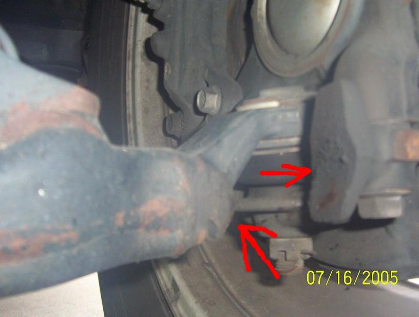

I took it to the dealer service dept and they looked at it and all they ended up doing was put a little grease on the steering stops on the lower control arms (A-Arms??) on both sides. Please excuse me if I am calling them the wrong thing. I believe the noise was caused by dry metal to metal contact at full steering lock and a small amount of slippage would occur due to the force of the turn. See the attacted picture.
The 2 points with the arrows make contact when you make a hard full lock turn. IE.. You pull in to a parking lot and make a quick turn around because you are going the wrong way. It is kind of a clunck noise.
I have almost 36k miles now and I have not noticed it since. I just wipe off the area and put a small amount of clean grease on it each time I change the oil.

I get the same noise on sharp turns and on occasion while going over steep speed bumps and the like. I haven't even bothered having the dealer check it out mainly because I didn't want to have it there all day only to have a tech tell me they couldn't find anything wrong or couldn't duplicate the noise. Plus, there are no leaks, so I figured no big deal.

More than likely there is no grease on there from the factory. That was the case with mine. But it should fix it for the most part. If you turn it hard enough fast enough you may still get it but not like it is currently. I think mine only did it in one direction also. I do not remember which since it was about a year ago. I just use the same grease I would use on steering joints if we had any to grease.

Have you tried applying grease to the areas in the photo yet??? If not give it a try and see if it goes away. Or just take it to the Dealer and have them look at it. Either way it seems like you have been putting it off for a while. Grease = 5 minutes in your driveway. Dealership = at least half a day without your vehicle.
From what you wrote it sounds like what mine was doing. Loud metal knock noise. It is metal to metal contact and then a small amount of slippage occurs and makes a knock or clunk. You can actually feel it in the steering wheel.

I used the same grease you would use to lube steering joints or U-Joints. It comes in a tube for about $2-3. Moly, wheel bearing grease or lithum grease attracts less dirt. Just wipe the areas clean with a rag each time the oil is changed and apply new grease. Like I state before you still might hear it but much less noticeable.

One thing to keep in mind, the steering stop is A LOT smaller than it appears in the above photo. It took me awhile to find it because I was looking for something much larger.

This is exactly the same place you get the nasty grating sound on 1980's Toyota 2wd/4wd trucks/4runners at full lock (well documented), and the solution is still the same...grease the steering stops.

I really couldn't picture the steering stops causing this noise either. It really is quite an awful and alarming sound. But I went down there with a rag and some lithium grease (took about 5 minutes) and lubed them up. Problem solved.
