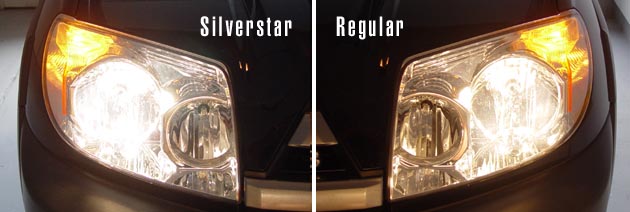

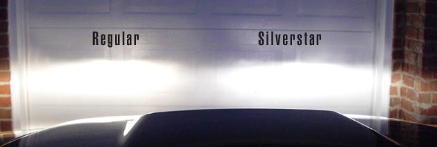

Here are a couple of comparison shots.

That was the bad part, they are about $19 a piece, and I bought 6. I didn't buy them all at once, but now that I have the set, I am very pleased.
They aren't hard to install at all. Just unplug the harness from the back of the bulb, twist it and then pull it out. When you are installing the new bulbs make sure you do not touch the bulb with your fingers. The oils in your skin can cause the bulb to explode. If you think you have touched them, just clean them with some alcohol.
How was Chris Rock?
To me it was just because they are different from the norm. I wouldn't say it is a night/day difference, but it is a cleaner brighter white. If you are over here at night you can check them out and I can check out your exhaust.
