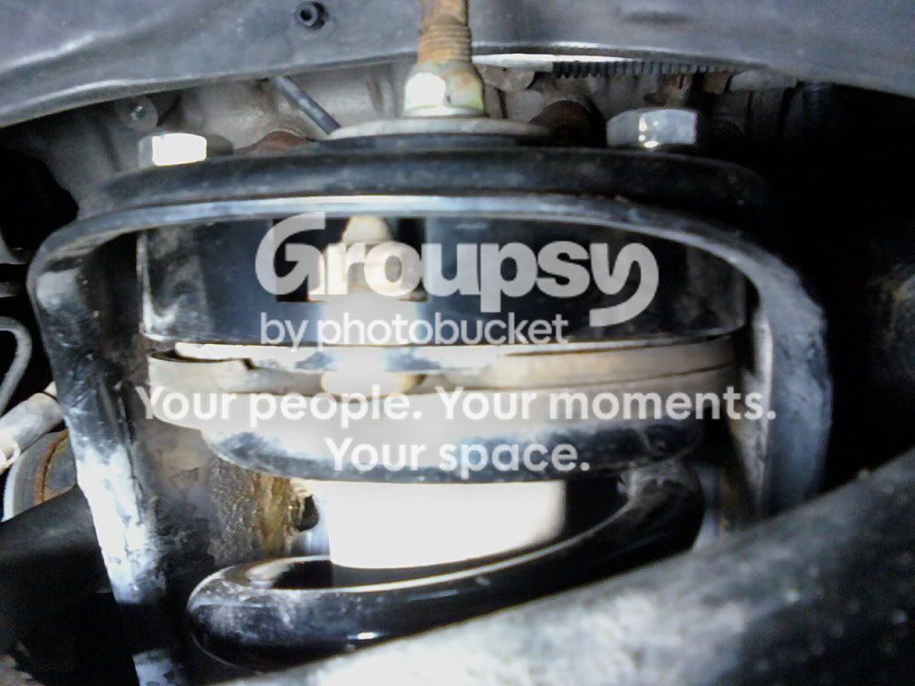

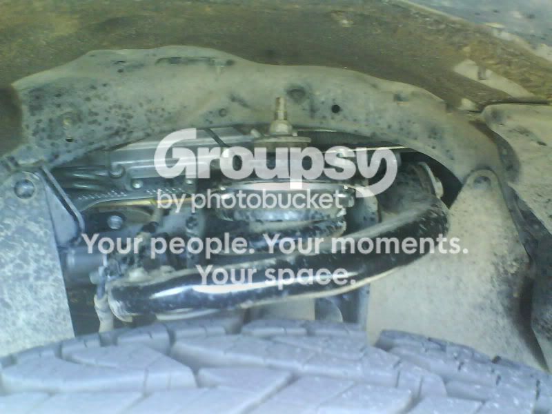

I had a Toytec 1" spacer lift installed on my 4R last month. I don't know the before and after measurements, but here is a pic with it installed....
DSC00270.jpg~original
DSC00271.jpg~original

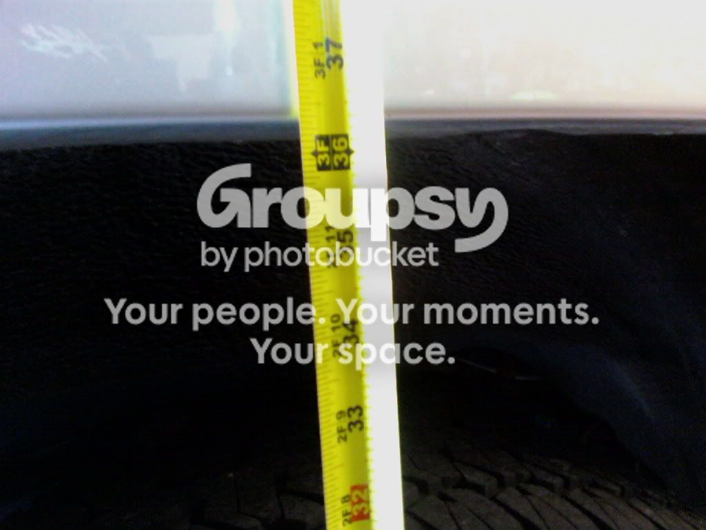

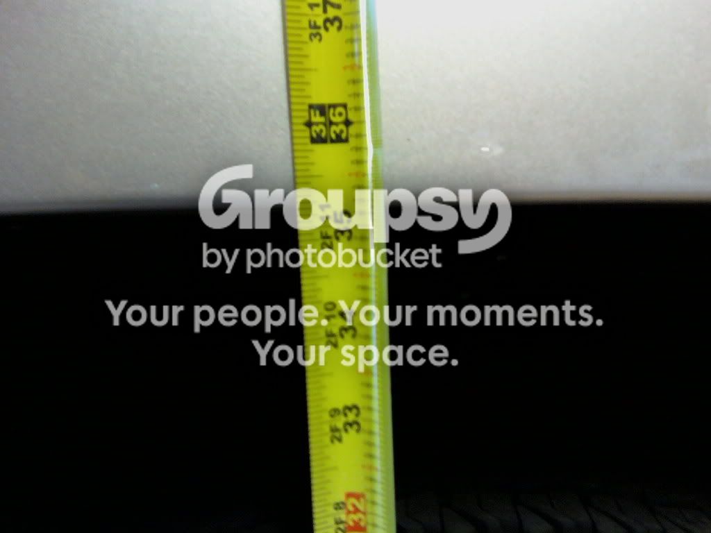

ok so i installed my 2in leveling spacers today and my end result is i have a near completely level 4runner my rear measurement is still 36in. and my new front measurement is just about 35 1/2. so what i thought was correct if you are using top out spacers the size of the spacer is the amount of lift you will achieve. i will have pics up in about 20 min. just wont have a full picture of the truck cause its dark out now ill post of those tomorrow.

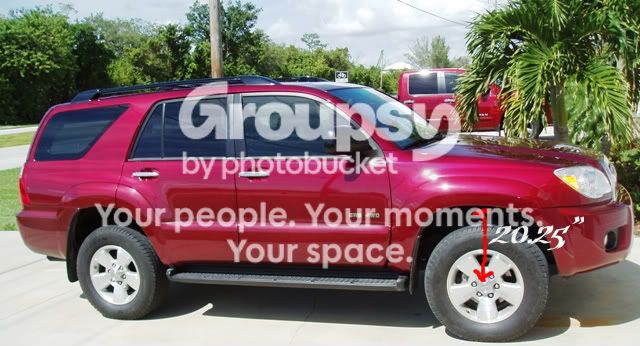

Looks great! How does it ride, handle etc? If you have time could you do one more measurement from the center of the wheel to the fender lip (on the front).
A measurement like this:
W4FJCspringsandspacers.jpg~original
This takes out and tire/rim size differences... Thanks.

yea cj i can do that for you and the ride is still the same no change.
