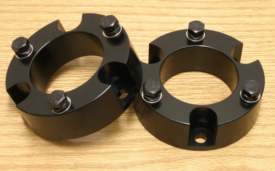

gigs lift look like a pre load spacer because it look as if it is sitting top of the spring and then the hat is bolted down on top of it, where mine just bolt directly to the hat. i have no problem agreeing with the fact that you will gain lift out of a preload spacer which makes all the sense in the world but to say your gonna get more lift out of a top mount spacer is just plain silly simply because it doesnt place any added tension to the suspension like a preload spacer would it just simply is bolt to the hat which pushes the the whole strut down the amount of inches places in. to simplify this for you it works like a wheel spacer would where the wheel spacer bolts to the hub and spacer the wheel out this is basicly doing the samething it bolts to the hat and spaces the strut down. i dont understand whats so hard about that i proved it through pics and everything i used a 2in top spacer and gain 2 in of lift you can see it in the measurements and in just the photo the truck sits damn near perfect.
http://cgi.ebay.com/ebaymotors/2005...ptZMotorsQ5fCarQ5fTruckQ5fPartsQ5fAccessories
this link is an example of how seller even describe these leveling kits if your buying a 2inch spacer you'll get 2in of lift. seriously guys im not tryin to say i dont understand and that your completely wrong cause your not your right about preload spacers but as for the style lift i have what your saying is wrong.
