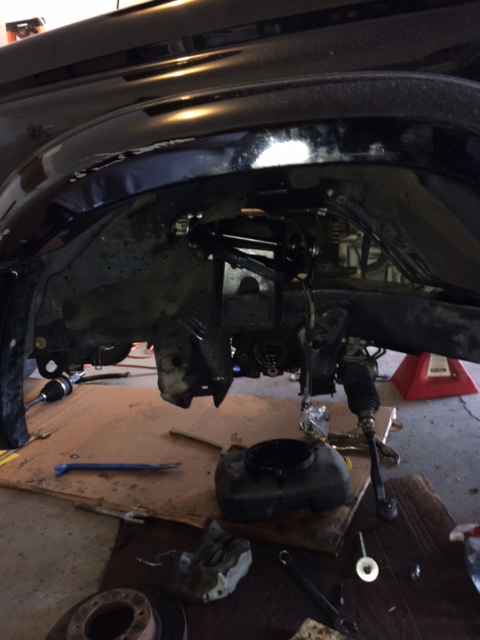

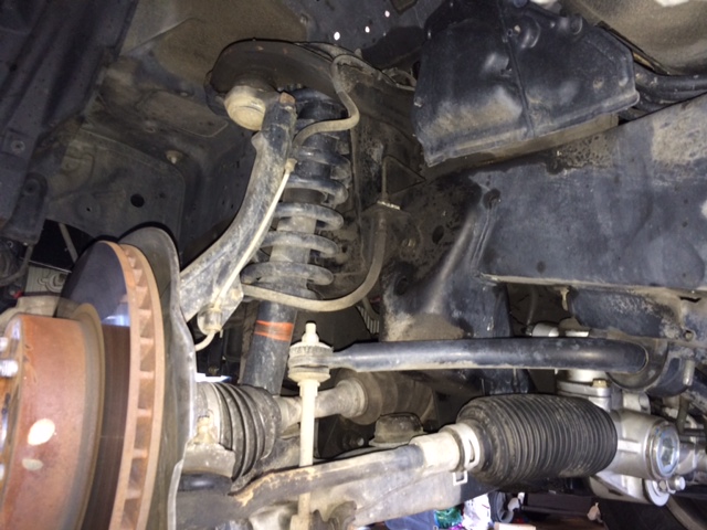

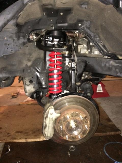

Just finished up refreshing my 01 Sport. List of everything done.
Steer rack bushings
inner tie rods with new boots (OEM)
outer tie rods (OEM)
front lower control arm bushings (OEM)
sway bar bushing
wheel bearings (OEM)
new cvs's (NAPA)
lower ball joints (OEM)
Light Racing Upper Control Arms (included new upper ball joints)
Toytec Boss Coilovers
Toytec Superflex Coils
Bilsteins Long Travel rear Shocks
Trail Ready Beadlocks with Red Stadium Rings
Goodyear 285/70/17 MT/R's
Going to get an alignment this afternoon. Can't wait to start driving it again.

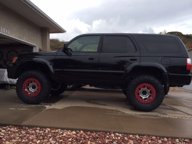

Not crazy about the rims but a clean black 3rd gen sport is a killer looking truck to me. The epitome of a 4Runner.
I agree that the wheels aren't for everyone. The red stadium rings add a big bling factor. I love them though and can't wait to see how low I can go on psi.
Very nice! I need to go through and refresh all of that on my 01 as well. Nice work. I actually dig the beadlocks in a purposeful functional sort of way. If you use them for what they are for, they will be well worth it I think. :D Very nice! Good job.
Cant wait to see some action shots of it. :)
I have to respectfully disagree. I personally like to see a ring of another color to separate the black tire from the black wheel. That's why I painted my fake beadlocks green. But to each their own.
I know. To each their own. I do think those wheels black with the red beadlocks would look good though.
Zero PSI, LOL. I can run 5-10psi all day on 16x7 rims with no bead lock. Those things wont need air.
