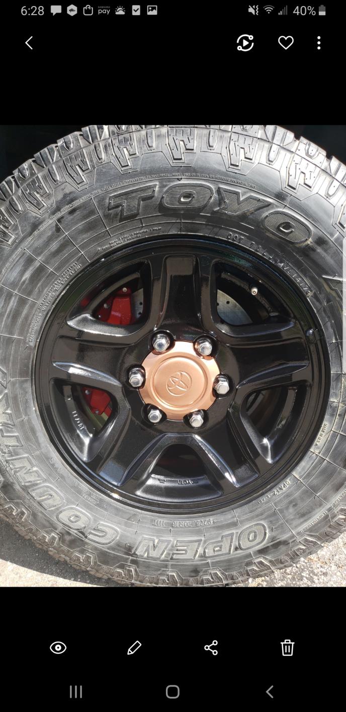

P.s. I also forgot about the tundra brake upgrade. I just did this this weekend and got the reman powerstop 13WL setup on rock auto. Without the core return after taxes and shipping it ran me 400 dollars even. I have the 5 star OEM rims on my 2000 and they have a ton of clearance. All I needed to do was bleed the brakes after which I wanted to do already cause who knows how old the previous fluid was. Huge increase in stopping power in my mind it was worth it because they're pretty looking and also my passenger side caliper was messed up. Tundra brake upgrade was just as much or even less than 4runner brake pads calipers and rotors from the research I did. The 13WL setup is a 231MM pad and the 13WE (?) Is 199MM (?) (Fairly certain that's correct) I wanted to go big or go home so I went with the WL.

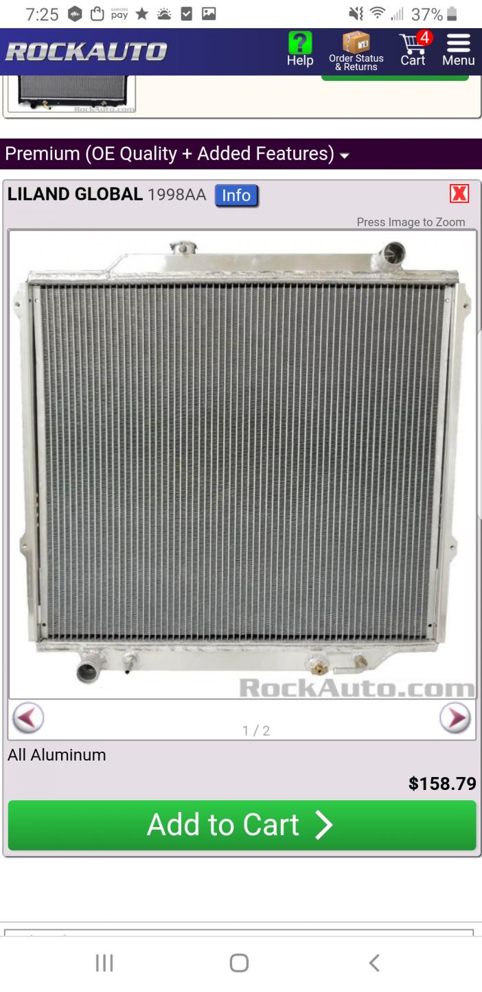

not sure what your budget is like but I'm buying this soon. My truck has 250k miles on it and as preventative maintenance I'm changing out the radiator. Not going OEM denso though as I dont want plastic. All aluminum for 160 bucks. The original ones are notorious for breaking with old age and mixing the trans fluid with coolant rendering the trans useless in most cases.
