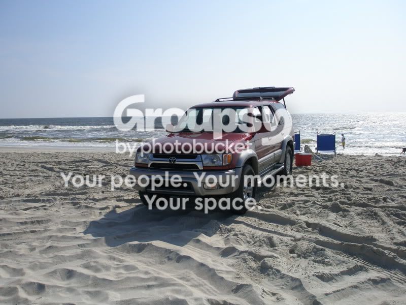

Here's a pic of the ride at Carolina Beach:

lookin good. im assuming your in NC or SC to be at carolina. My buddies and i camp out there for the majority of the summer. Do you have a season pass?
