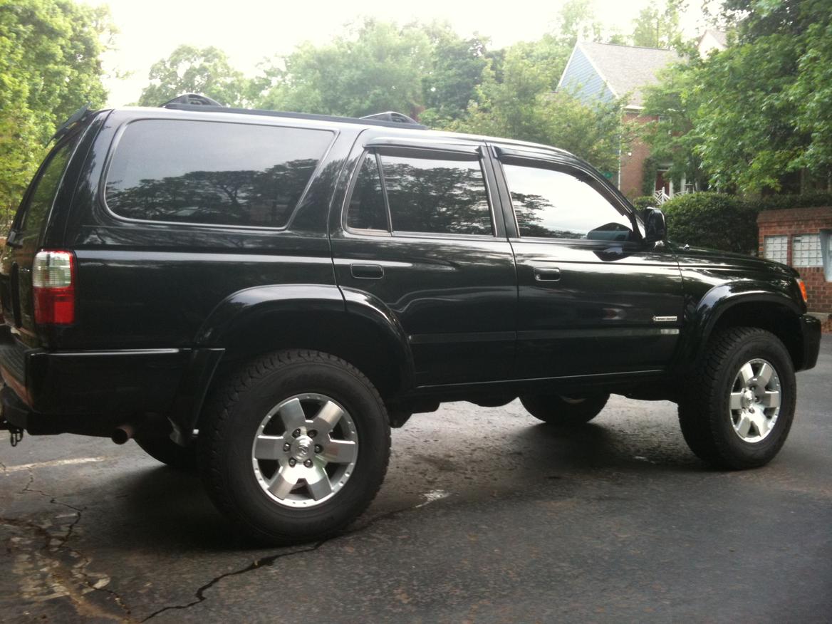

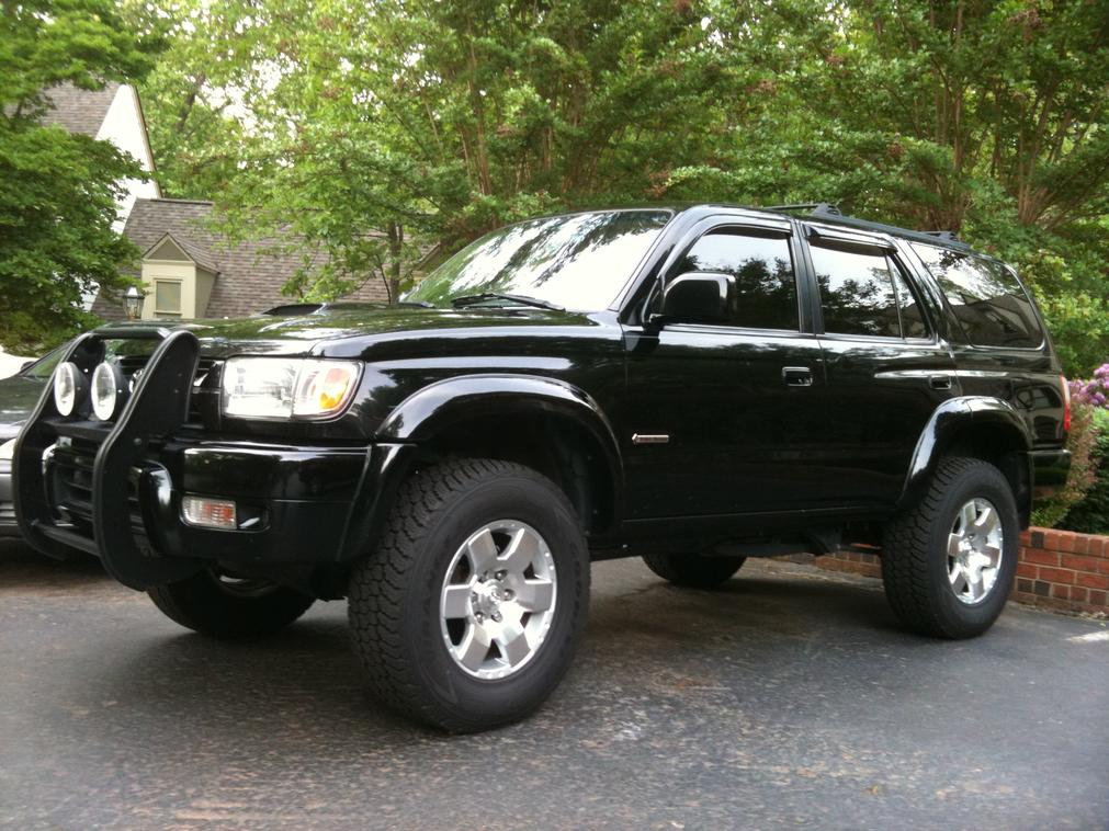

I have OME 883s in front and 891s in back. The 891s are a bit firmer a bit more lift and handle a large load better, worked great hauling this huge load for 1000s of miles.

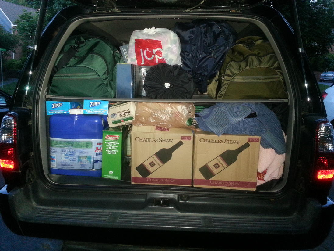

I just did a cross country trip with about 800# of crap in the back.
This is what it looked like with 800# in the back, first picture.
2nd and 3rd is normal, empty
and 4th shows the load that goes all the way touching front seats touching the roof and side to side.
