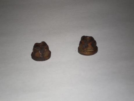

Deez Nuts
are in really bad shape, but before I changed my A/F sensor I had read that it was a good idea to order new nuts and you can see why. My check engine light came on and was throwing P0125 and P1135 before I changed the A/F sensor. I disconnected the battery and pulled the EFI fuse then I swapped out the sensor. That cleared the check engine light. This whole thread has everything you need to know if you are do up for the same thing and a search of the engine codes pulled up great advice too. Thanks everybody!
