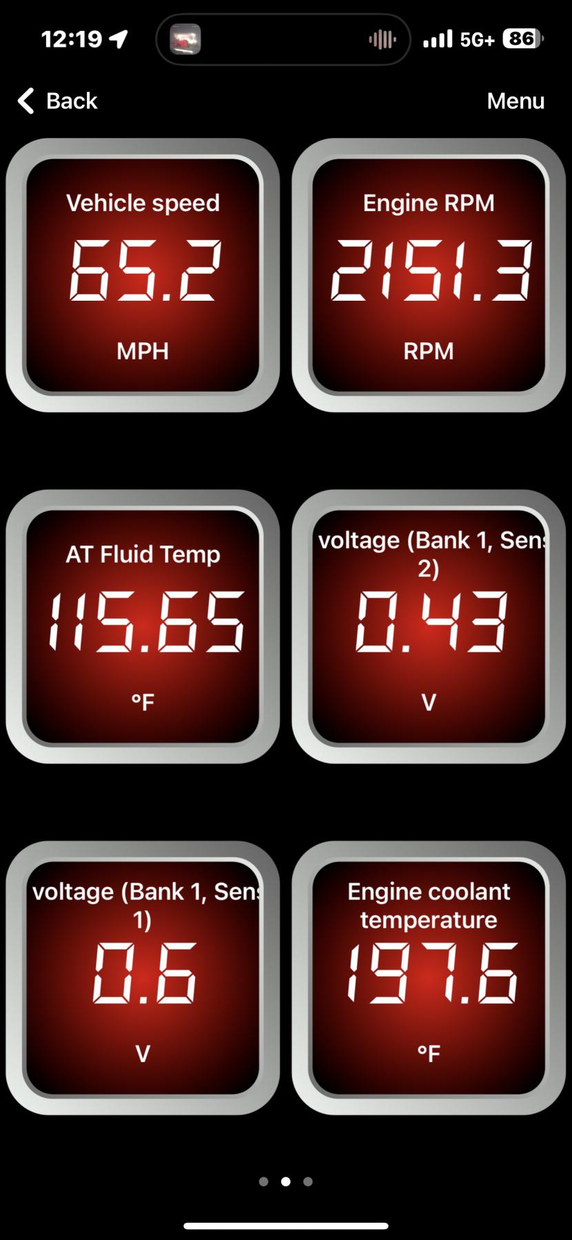

It is a 99 4x4 CA emissions, my CAT wont ready up and I think this is the issue.
The car has no codes or pending code. During smog it passed the sniffer and visual but failed for Readiness.
Funny thing is car idles and runs flawless.
So I think the 02 sensors got swapped by previous owner because my Sensor 1 is stead between .6 -.8 and bank 2 is hopping around like a afr guage based on throttle , honeslty this isnt make sense to me because it got swapped the narrow band sensor should vary alot more still.
Picture attached.
Picture attached.
Thanks Robb
Your front sensor is steady because you have an upstream “air fuel ratio sensor” and not the older style narrowband O2 sensor. The AFR sensor will not switch back and forth like an O2 sensor. Your downstream sensor is a narrowband O2 sensor. Sounds like it’s running normally. My guess is catalytic converter that’s not as efficient as the ECU requires.
