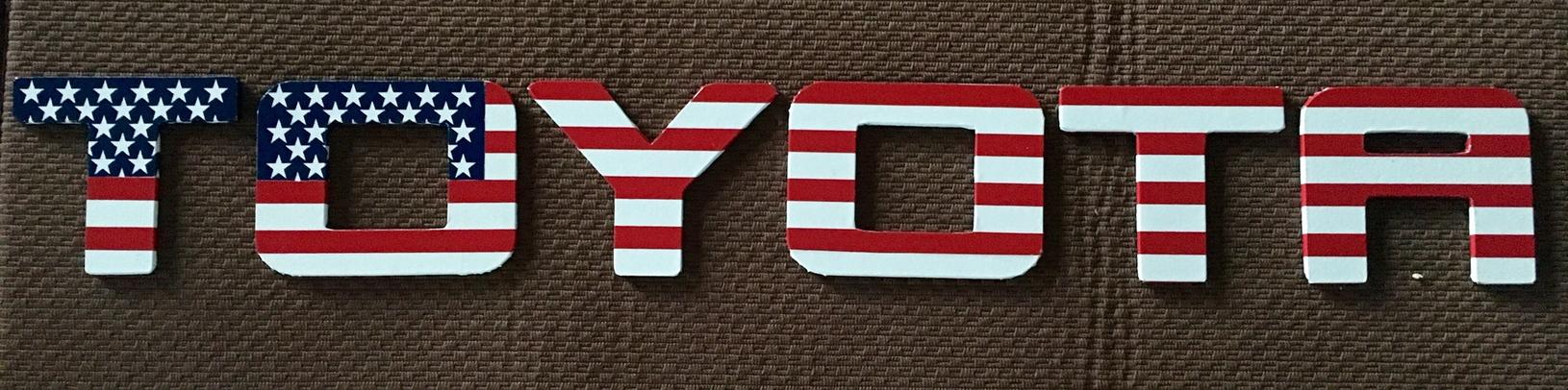

Emblem; USA Toyota Raptor Letters // purchased letters, I made it USA ...and yes, I get the irony
