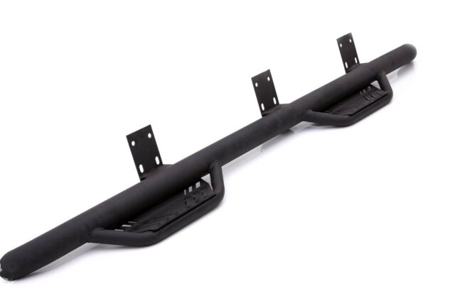

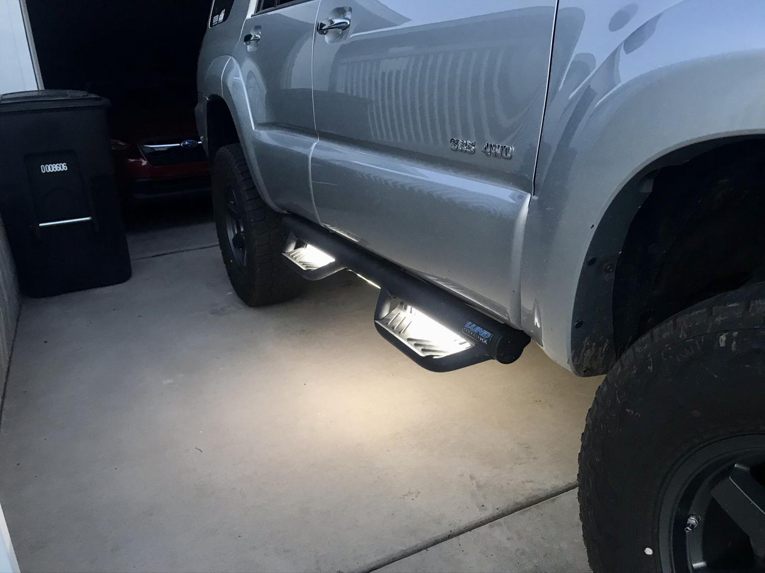

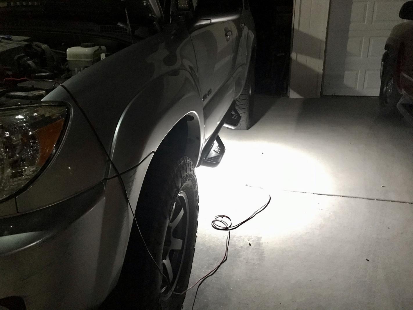

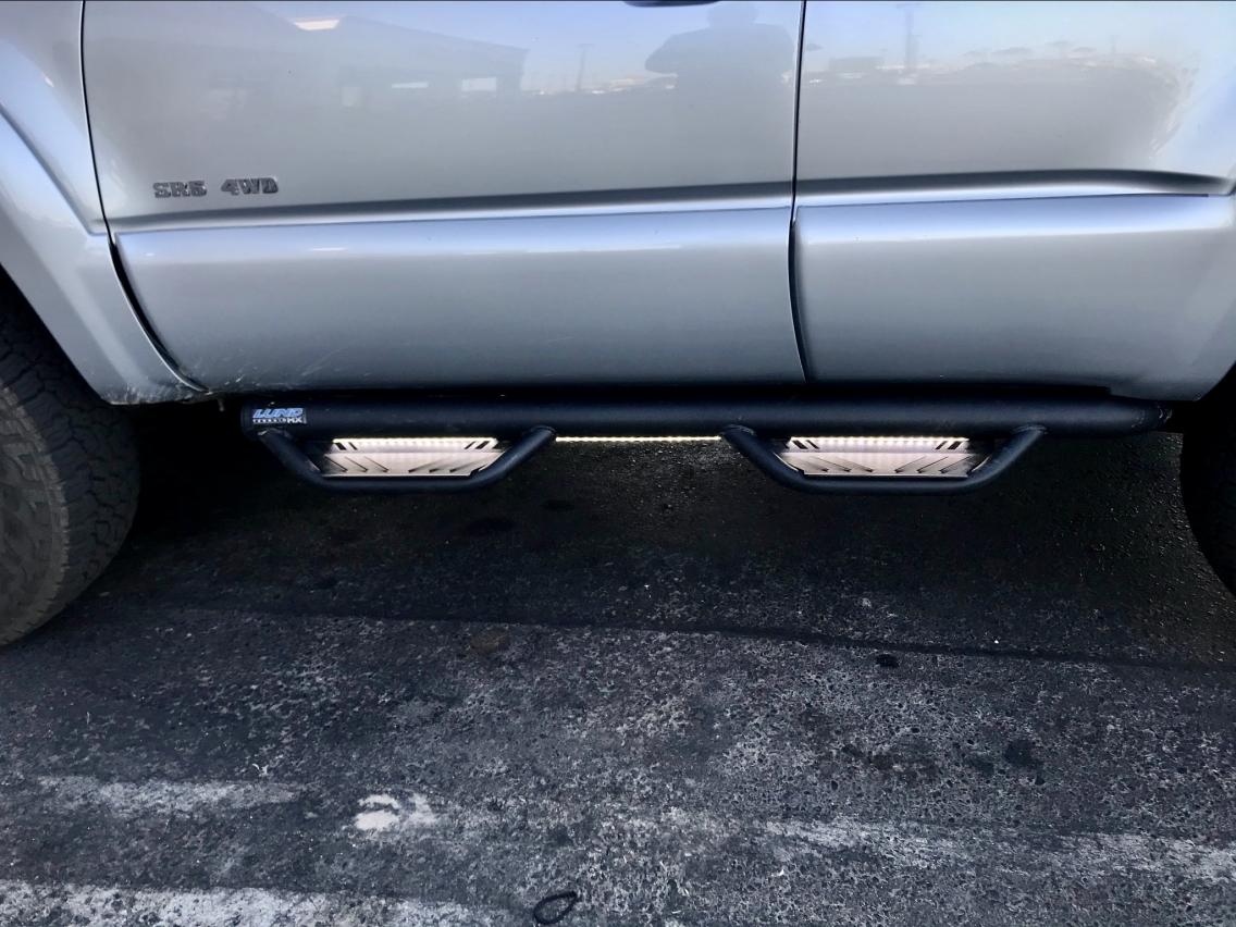

Lund HX side steps with Led light strips
Lund Terrain HX tube side steps-I really wanted sliders but by the time you add the powder coat cost to them, shipping, and the cost of someone to weld them up was way out of my budget for now. I’m happy with the way they turned out visually, especially with the led courtesy lights. They look sharp and get a lot of compliments.
I have one 12” strip on each step and one mounted to the tube underneath between the 2 steps.
I tied them into my interior lights so they go on/off with the doors. They work great for approach and puddle lights as well. When you unlock they turn on so there are no surprises walking up. When you open the door there are no surprises as to what you may step on or in at night. They are super bright! I used an interrupter switch to be able to turn them off as needed.
