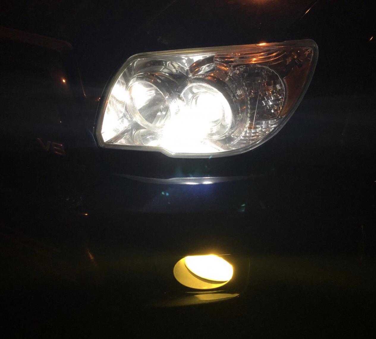

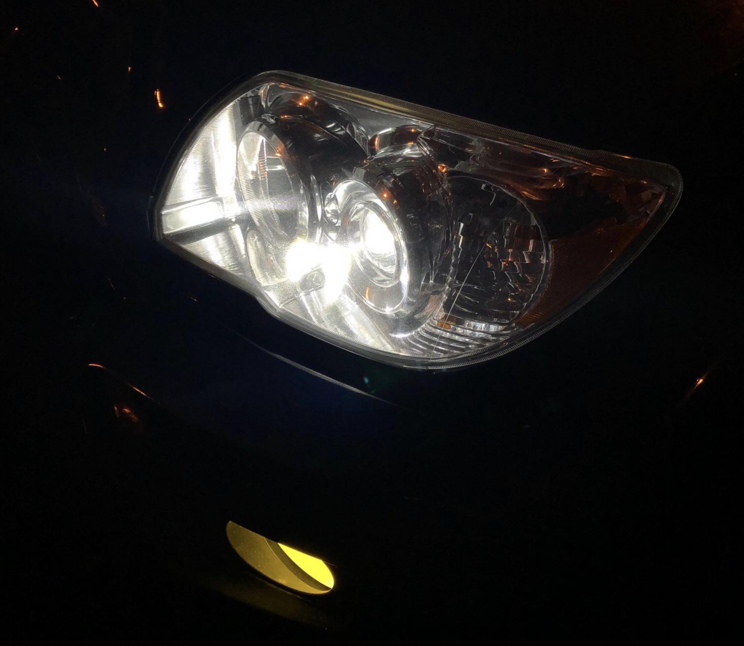

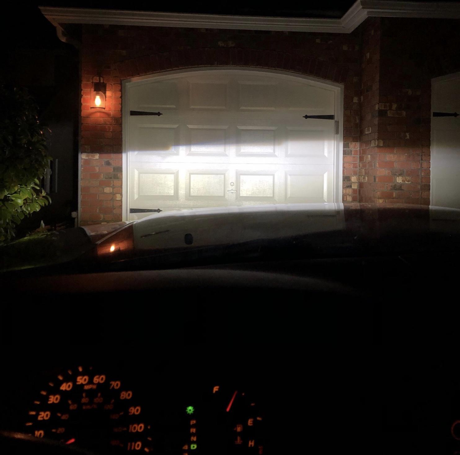

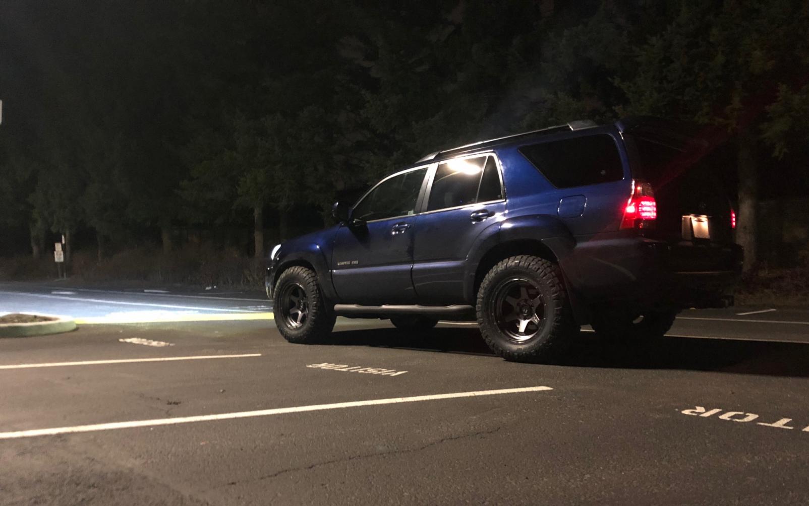

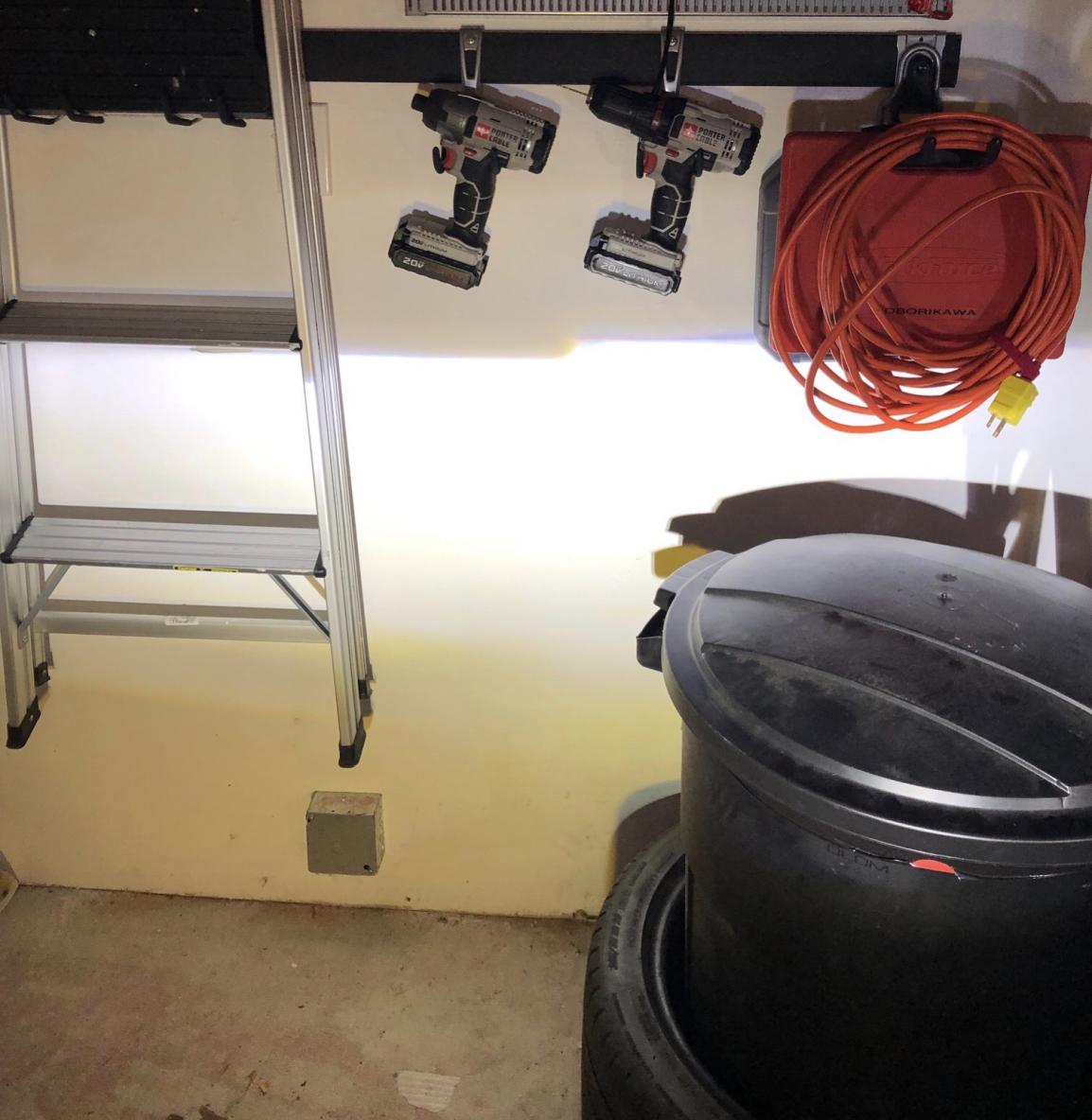

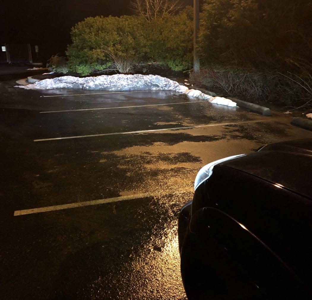

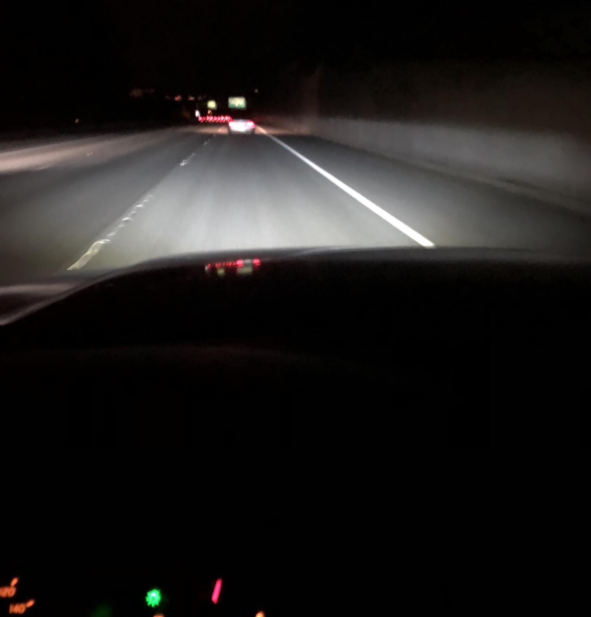

First of all, I am a huge retrofit fan. I did genuine morimoto 55w HID retrofits on my 02 sport edition. Also did 55w morimoto HIDs with upgraded projectors and lenses on my 14 limited edition. I now have an 08 V8 limited and picked the following LED bulbs up for shits and kicks... I am VERY surprised. See pics below. Of note the 25 foot garage shot is at a left slope and obviously uneven background. When I come across a straight wall will take a pic. It’s pretty obvious the cut off is fine. Huge improvement over stock. Light is uniform and wide. No hot spots or squirrel finders with 06+ projectors. Five minute install. 100% plug and play, (pull and rotate the plugs in the connector if it doesn’t fire up). Instantaneous max output and color with ignition. No waiting for these to warm up. Highly recommended for 06-09. Best bang for the buck at $29.99. As good as my prior HID set ups that cost hundreds more.
For the 03-05, you will need to swap the headlights out for 06-09 with projectors before proceeding with these bulbs. Too much scatter otherwise.

I'll have to try and get some pictures soon...I've had them in for just 4 days now but I am very impressed. I was worried that they would just throw useless light, but it seems like the projectors really help control it. I haven't been flashed by anyone while driving around.
It is nice to have road signs light up super far down the road even though the lights are controlled. The packaging was pretty solid and the bulbs themselves seemed of decent quality. For now, I will keep the original bulbs in the glovebox in case one starts acting up, but I don't foresee that happening.

There are no hot spots or squirrel finders. Cut off is clean with our 06+ projectors. Output is stunning.
