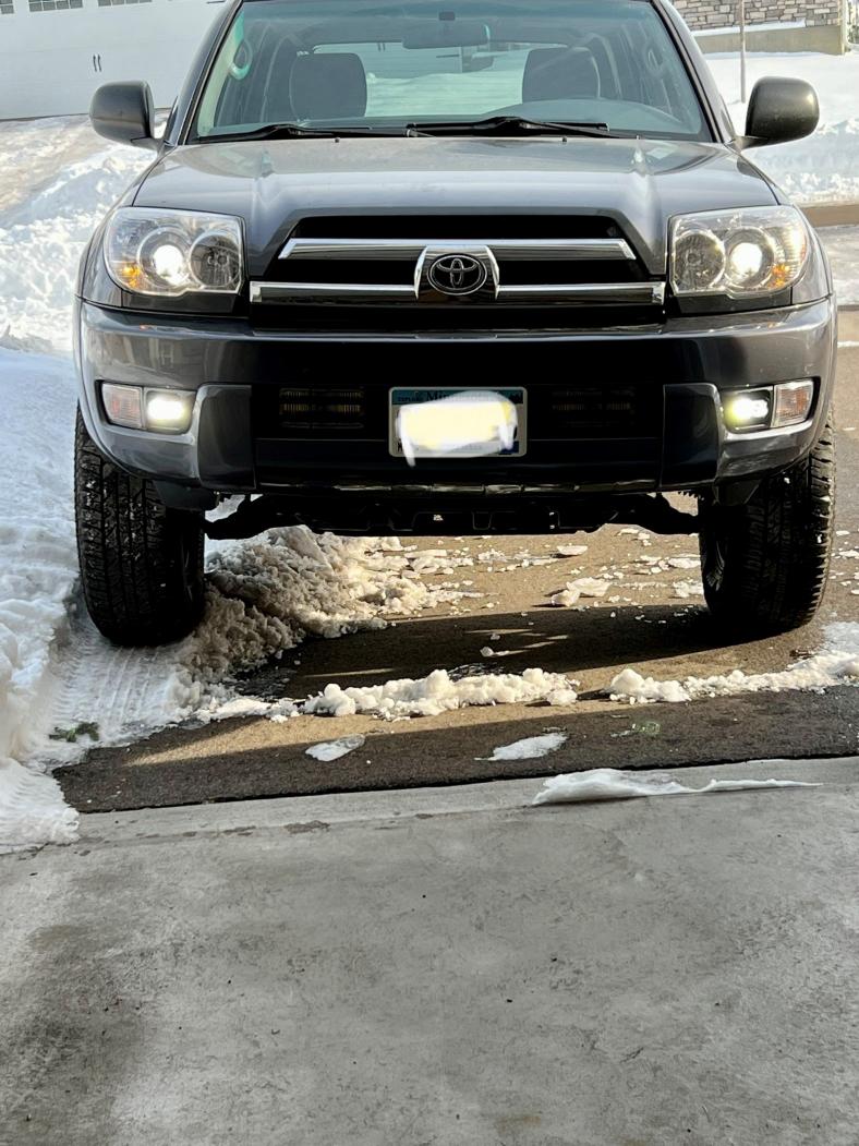

I really want to replace my fog lights with some led pod lights. It seems like its easier to do with a 06-09, but not so much a 03-05. My favorite iteration of this is sold by SolidShift concepts, but it seems like they're always out of stock and dont reply often. Would be cool if they sold the STL file and people could print the part themselves. ( 2003-2005 4Runner Fog Light LED Mounts (Pair) – Solidshift Concepts )
Has anyone else rigged something up that looks good with their stock bumper? Just trying to get some ideas/ see if anyone has made it look good. Im tempted to hollow out the stock housing and fit one in there.

After lots of back and forth with 3D printing and trying to make something work, I settled on stuffing a 3-inch Baja Designs Pod in the stripped housing. I was really excited to discover a 3-inch pod would fit perfectly inside the fog housing. My original plan was to stuff it in, 3D print a new bezel and secure the pod light from the hole in the back of the housing. Of course nothing ends up the way you plan, so I cut some bottom out and actually have the light mounted to the bumper itself. Overall, its not perfect, but hopefully inspires some other people. Pics below

I may have purchased their last set available. I tried the both the Rigid (updated version from the SolidShift directions), and the Diode Dynamics SS3, but they were slightly too large for the opening. I ended up using Diode Dynamics SS2 in a combo beam. Looks and works well I think.

Which is why I went with the SS2.
