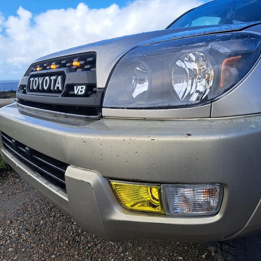

So I just did this install yesterday.
Before
After
Solidshift concepts 3d printed mount that I sanded and painted to match. Full transparency, I love how they look, but since you can't aim them the light output is much to low and im not a big fan.

Light output is way too low with zero room for adjustment unless I custom fab something up.

Does that pod stick out past the bumper?
Looking from the top, the turn signal corner sticks out about .5" and the fog corner sticks out about .75". The housing is slightly recessed so it does appear to stick out more but not much beyond the profile of the bumper cover.
