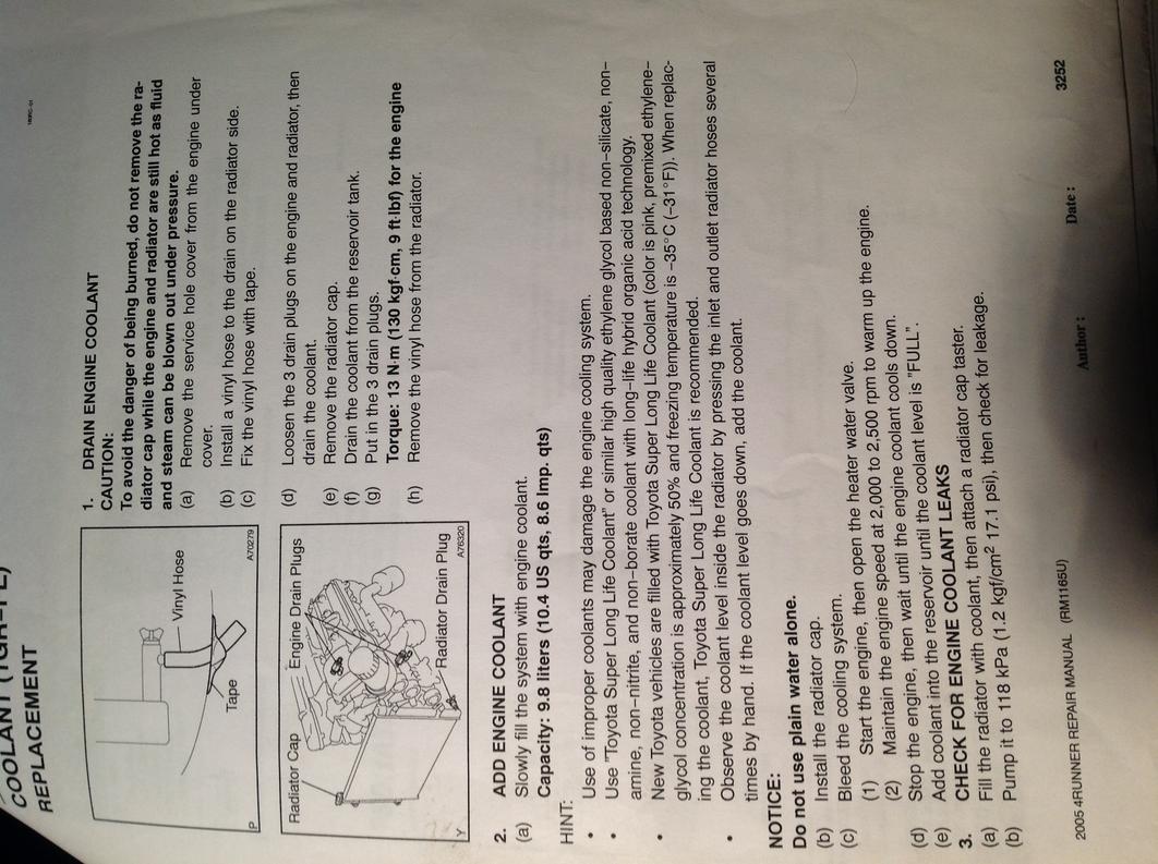

Coolant block drain is on drivers side just under exhaust headers. Hard to see but I found it easiest to see looking through left wheel well if remove pinned in splash guard aft of uca. I don't have a a pic but there is one somewhere in forum
Torque for engine drain plug is 9 ft-lbs as per 2005 manual
This is pic is from the 2005 V6 service manual.
It states there is 2 drain plugs. I have only every found the lower one not the top one as depicted in drawing
Thanks for posting that page. That's helpful.
That drawing shows two block drains, one on right and left side of the block. It does at first look like the right side drain is on top of the motor. It takes a little imagination to figure out where it is actually located. It should be the same height as the drivers side drain, and perhaps more rearward. Two drawings of left and right sides would have been better. What was the illustrator thinking? :-)
That page also shows the torque for the block drains (9 ft-lb.). I was looking for that value. Thanks again.
ahhh right gotcha...duh.
makes sense, cant drain form the top now can ya...
yup 2 drawings would have solved that issue.
tks
