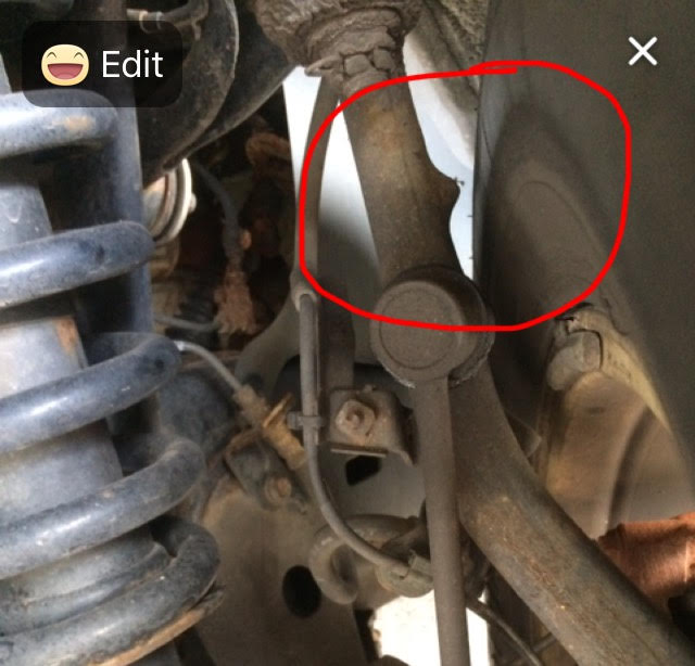

Just changed the oil this morning and noticed that there's been some serious rubbing on the inside of the front left tire against what I think is a knuckle. While parked, it is not touching the tire while facing straight, turned hard right, or hard left, but the rubbing definitely lines up with the tab that sticks out. I'm going to add a pic as I'm sure my description isn't making much sense. By the way, I have stock size tires P265/65 17, & stock rim.

Your tire and the knuckle move together so i dont think your tire is rubbing the knuckles. Have you been in a automatic car was, looks more like where the tire rubbed along the guiding track

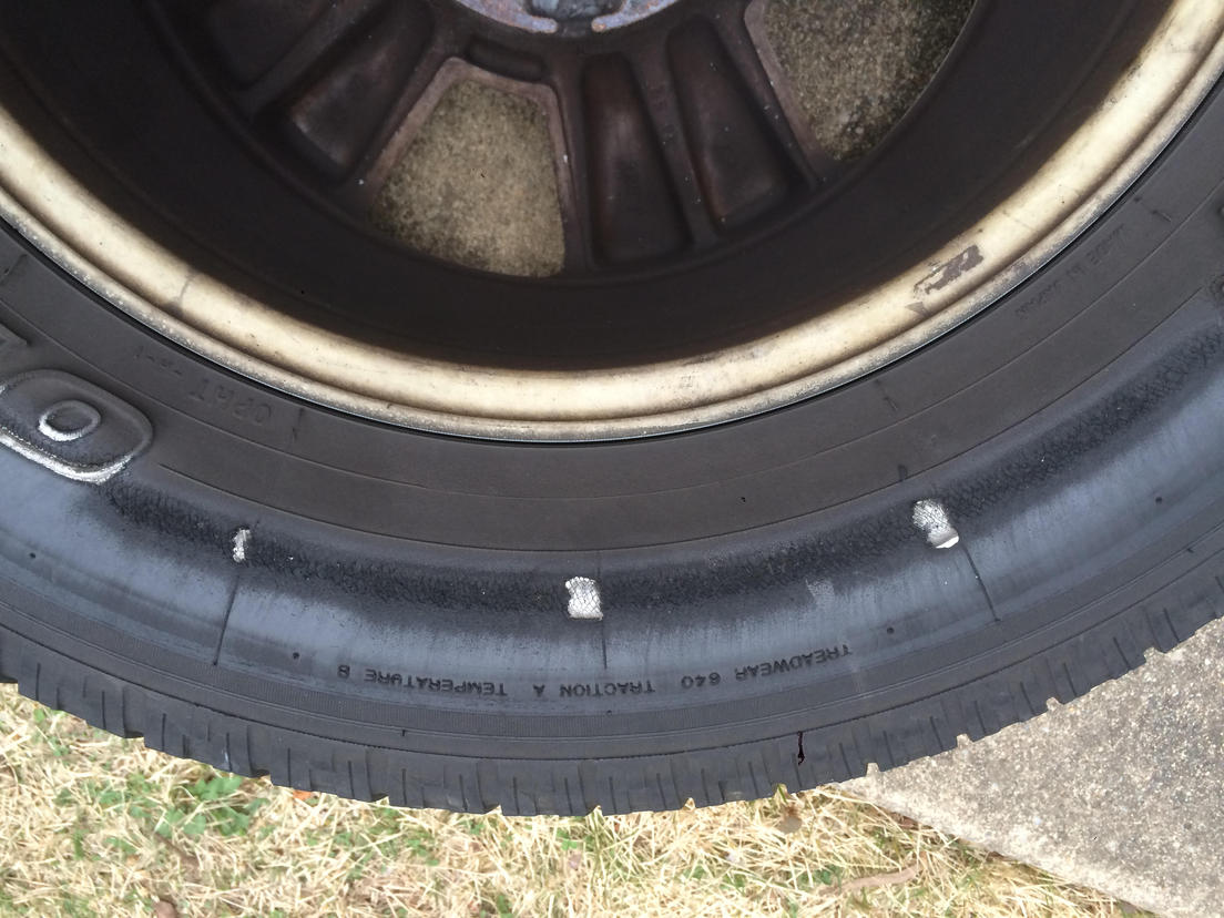

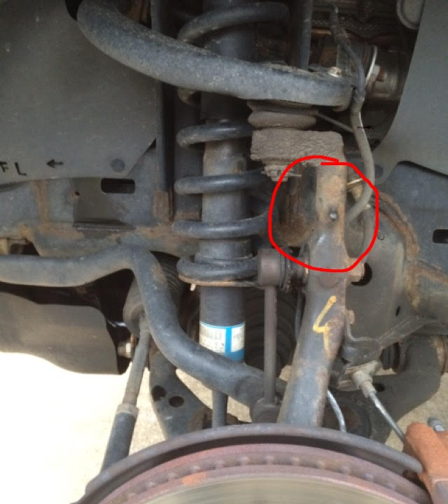

Not ruling anything out this point, however, tire pressure has never been an issue & I can't remember the last time it went through a car wash. I took the tire off & that tab part that sticks out is shiny clean & it lines up with the rub marks. A storm rolled in yesterday so I had to stop investigating. I'm going to put some chalk lines on the sidewall today and see if they get rubbed.

Is there any play in the wheel bearings? That would be the only thing that would allow the tire to rub, other than a bent steering knuckle. I do know that the tires were also close on my 4th gen with the OEM wheels but they never touched.
