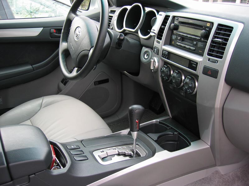

However I did wan to note that the radio I have looks like the one in the image attached except mine does not have a JBL logo in the upper right hand corner. Does this mean it is still the amplified system?
I listened to it with my iPod on the way home (with an old cassette adapter ) and while most songs sounded great (I think I heard a little thump from the sub in an amped system) I had a few newer songs with some distortion on them. Could this be traced back to using the adapter? I haven't had any problems using the AUX in on my old Alpine unit.

"except mine does not have a JBL logo in the upper right hand corner"
If no JBL on the HU then the radio has the normal internal amplifier (vice the external JBL amplifier) and no Bass speaker (sub woofer) in right rear.
If no JBL on the HU then the radio has the normal internal amplifier (vice the external JBL amplifier) and no Bass speaker in right rear.
Even if it looks IDENTICAL to the HU in the picture (minus the logo)?
If no, then there is some tremendous bass coming from those speakers. Are they amped to some extent?
