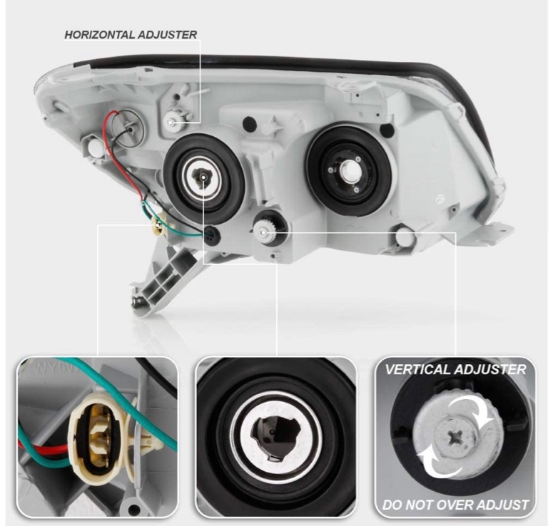

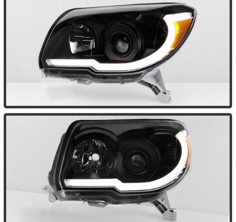

So I’m looking to get the 06 conversion and I have these headlights I’m looking to swap over and I’ve been reading the swap threads. My only question is since these are after market headlights am I just following the instructions for the swap with these aftermarket headlights?

if you get the chance I would love to see a before and after of the lights and their output. Did the 06 swap myself, but I might get rid of the lights I bought they keep getting moisture (and I want to do a proper LED retrofit in them)

With the DRL wouldn’t you want LEDS since you would be adding them to the headlights? Cause I’m pretty sure I read 05 and lower DRL are in the bumper and 06+ are in the headlights. So if you want both to work leds would be the way to go due to leds pulling way less amperage
I've been running these for about a year with no problem, although I caulked the top and side areas heavily before install to prevent any water issues. Using standard Toyota bulbs for the high and low beams, and a Lasfit LED for the driving/turn bulb with a resistor on each side. You may have to de-pin your two wire marker light plug and shove them (and a hot tap from you DRL) into a three wire connector for this light to work, or get 6 wire taps and some pigtails and hardwire it.
Light output is comparable to new OEM.
This Does Not Work. Already tried and Nothing but Issues with Running DRL's in Bumper and 06-09 Headlights together.with LED's
Thank you for your input everyone. I’ve actually decided to just keep the headlights installed right now. They are the black housing SPECD Headlights and I can’t really find a reason to justify spending the money on these! Very much want the 06+ look as well as the grill upgrade but I’m gonna save the money and do those mods later on.
