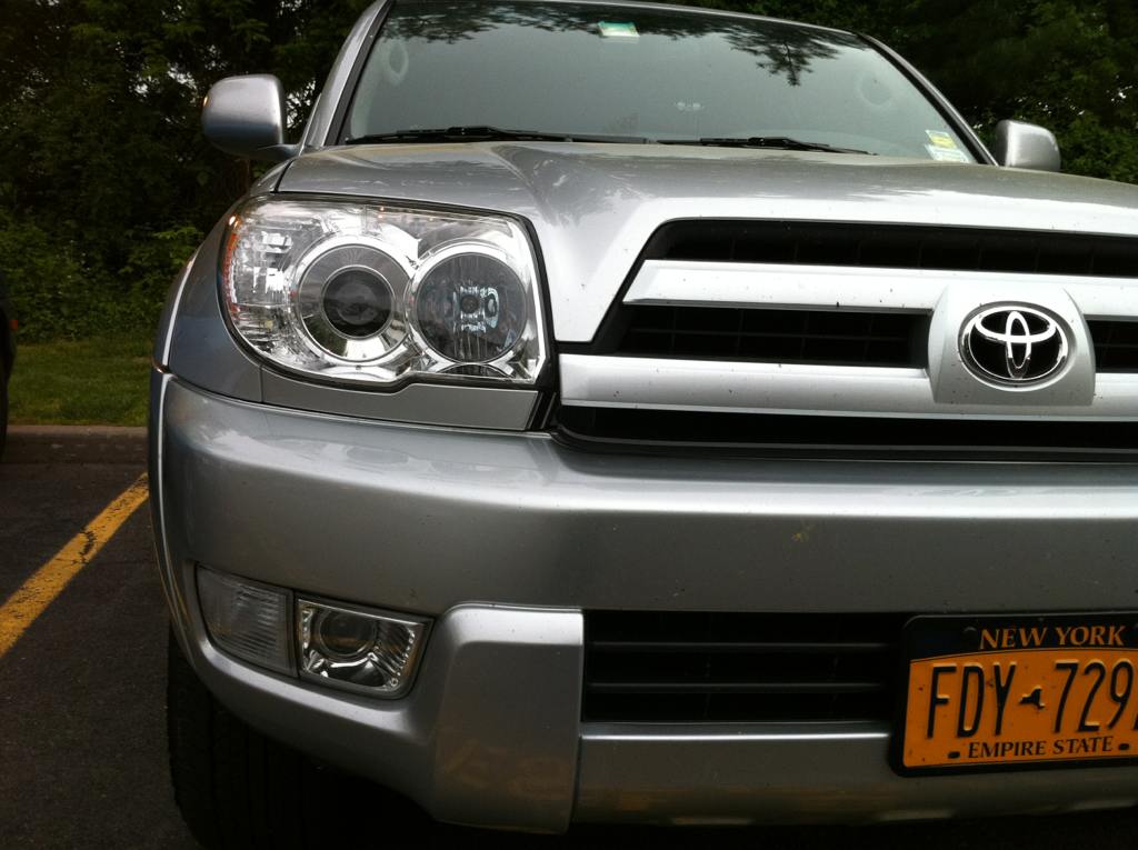

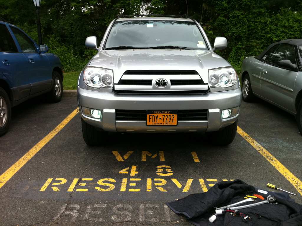

I did this mod. All I did was add the lights and trim piece. The gap in the hood is nothing noticeable IMO. I did 6000k hid for driving lights and fogs. This was the first mod I ever did to my truck and still a fav.

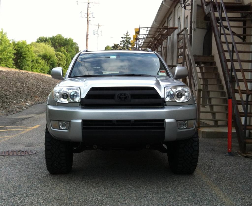

Current form

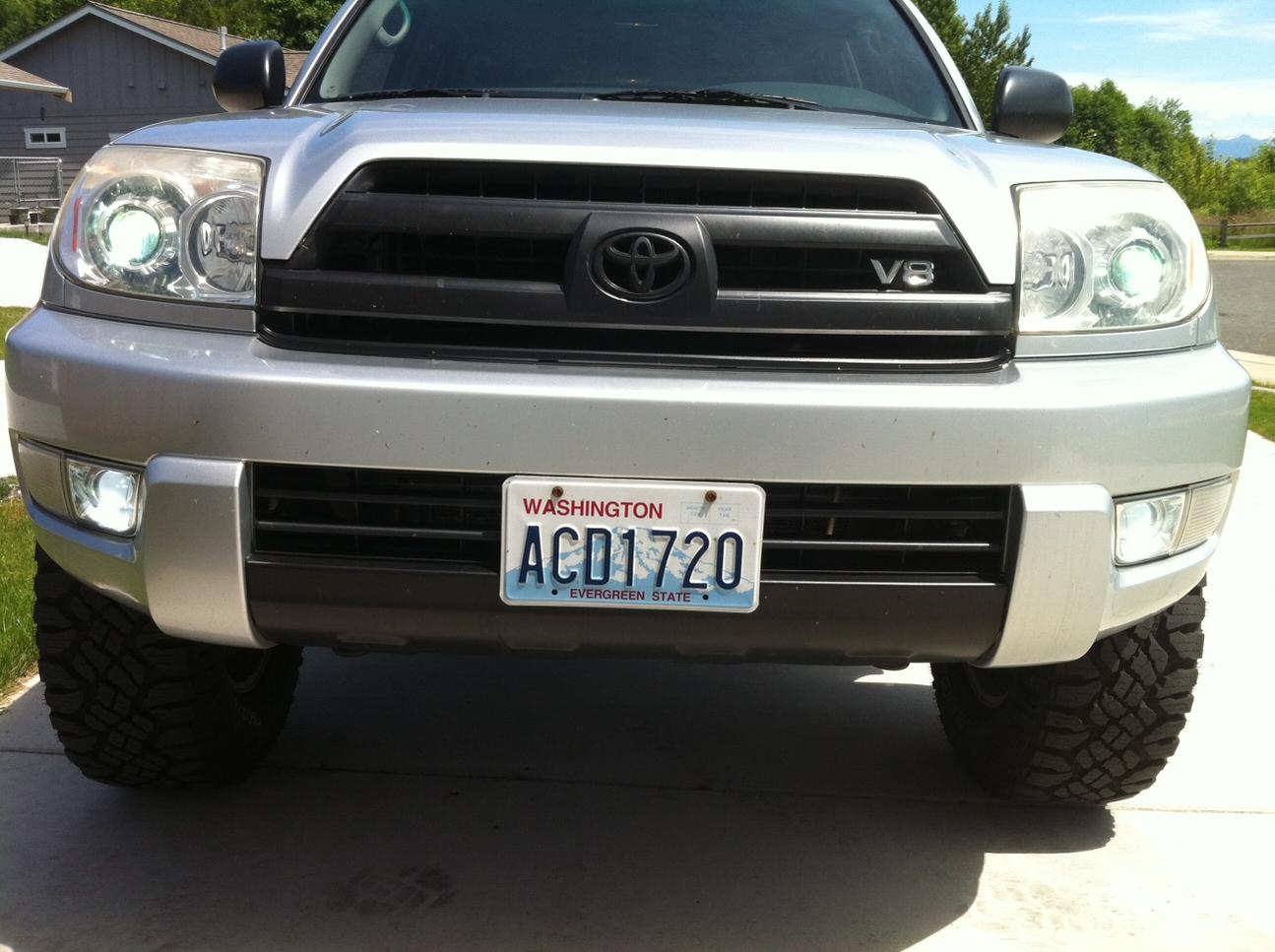

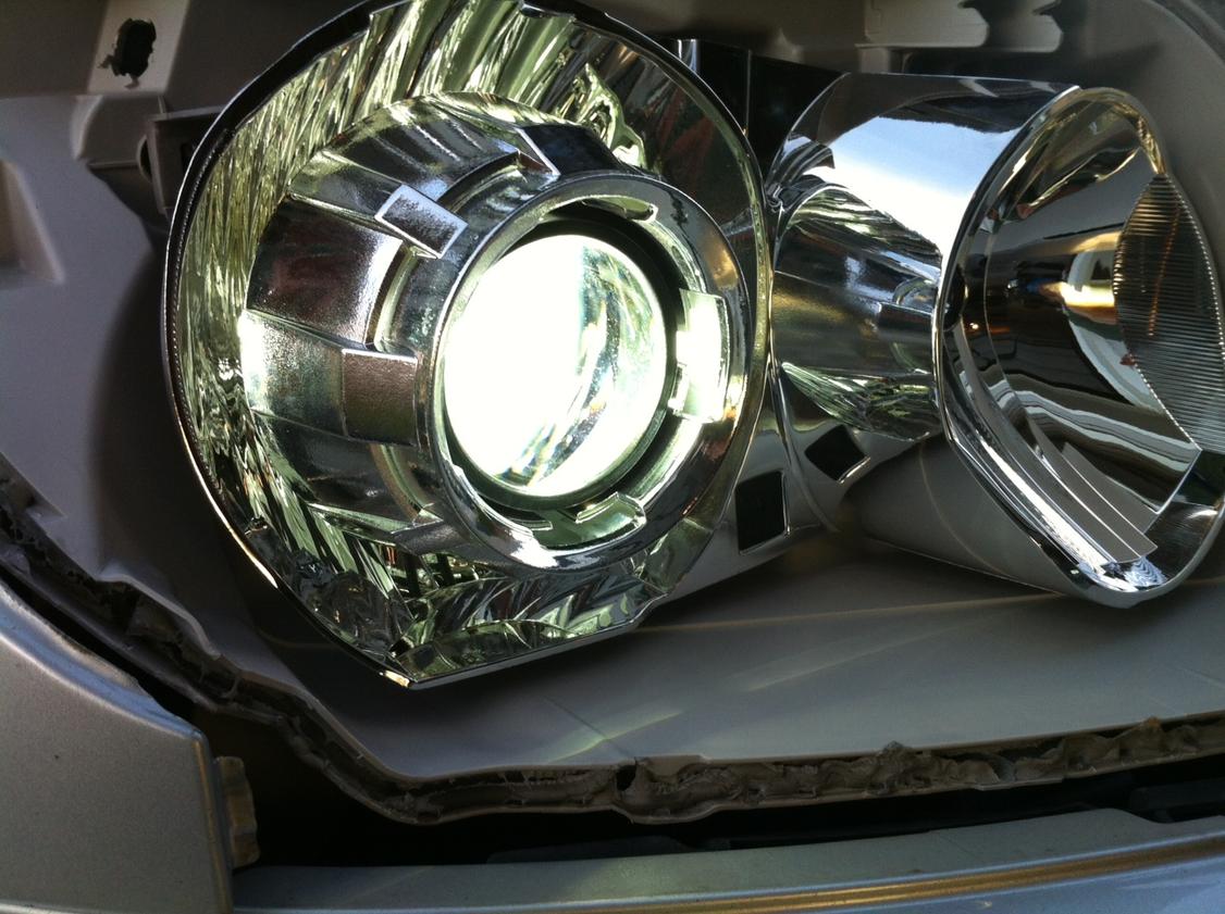

Just go to The Retrofit Source online: headlight upgrades for all applications and buy a retro-fit kit. I'm running the Mini Morimoto H1 kit and love it. I too was contemplating doing the '06+ headlight swap but I'm glad I did the retro. I now have bi-xenon headlights and no gap near the grill. Here's a pic before I blacked out the headlights and was doing a test. Total cost was around $280 for a full retro kit with projectors, shrouds, relay kit, ballasts, and HID bulbs. It's not hard to do at all, just takes a little time and patience.

one more pic
one more pic showing no gap in near the headlight and grill.

I'd say that is very noticeable. But then again, I'm very picky and don't settle for halfass. :rockthrow:
Porsche cayenne turbo yeah not a chance in hell I would leave a gap but 05 4runner meh lol. Besides once grill got blacked out its even less noticeable
Like i said on post 3, retrofit is about the same cost as to do this conversion, with retrofit, u get more light and better performance.
Bi-xenon meaning your original high-beams are empty/non-functioning?
i think he wired it up with the stock highs, so when the highs are on, he have both stock highs and the projector highs working together, the projector he using have both low and high function built in. there is a silenoid that gets power from the stock highs to trigger the flap in the projector. on my retro, its only low beams. this is the affect i get when i hit bumps and the cars in front of me see this color flicker effect. its like what you would see on a benz and bmw and range rovers. or other cars thats equip with a nice projector.
