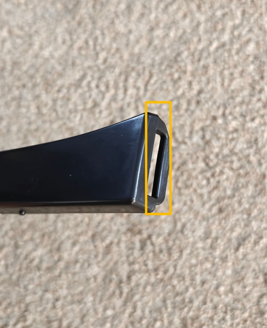

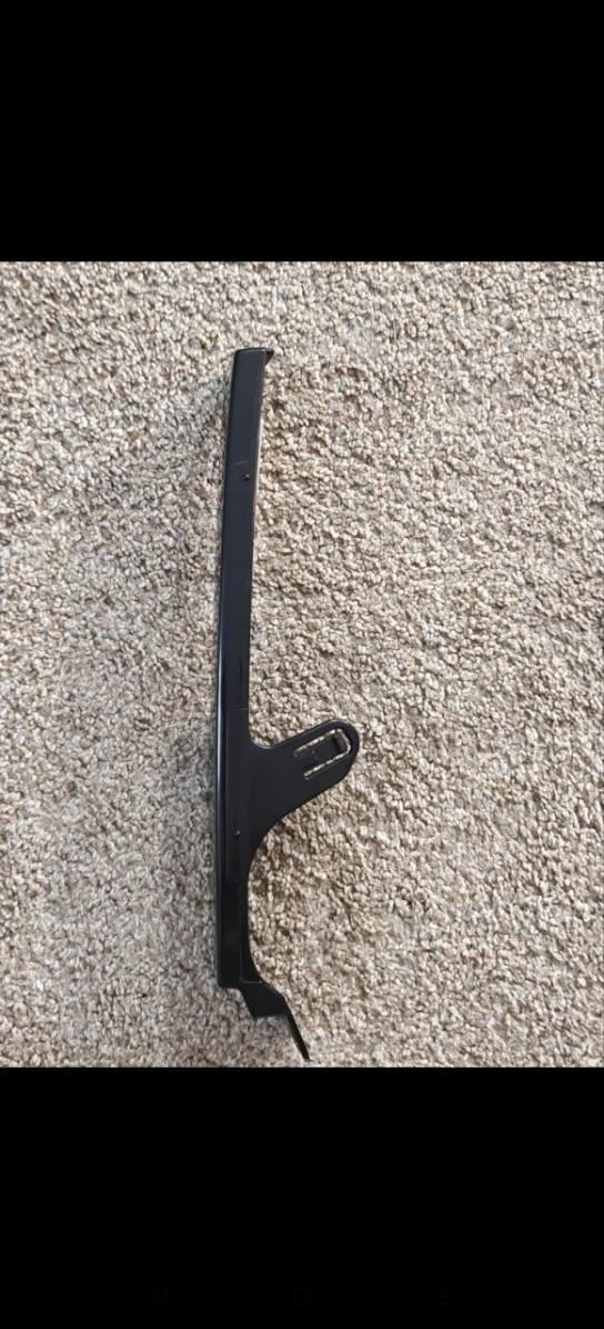

So, the headlight assy on my 05 runner is shot ,and i intend to use the opportunity to upgrade to 06+ headlight assy, however the filler tab am seeing is missing this end piece that helps hold it snugly in place,
Anybody knows where i can buy the small plastic end piece, or a workaround to hold it securely in place without the endpiece?

thanks, but guess my post wasnt clear. there is a small plastic tab that sits in the slot {highlighted in yellow} in the picture i posted. its that small plastic tab am looking for. the trim piece i bought off amazon didnt come with it, and the units on ebay dont include it either.....
That "endpiece" isn't a separate part on 06+ models, the part in your pictures is just one piece. It's the same part as the 1st link in LOSTR4's post.
I get what they mean 100%. There is a small clip that goes into that trim piece. If you don't have it, you're screwed. I am missing one on one side from the old lights and trim piece when I upgraded to 06+ headlights. The trim piece doesn't come with them and neither do the headlights. Mayyyybe OEM?

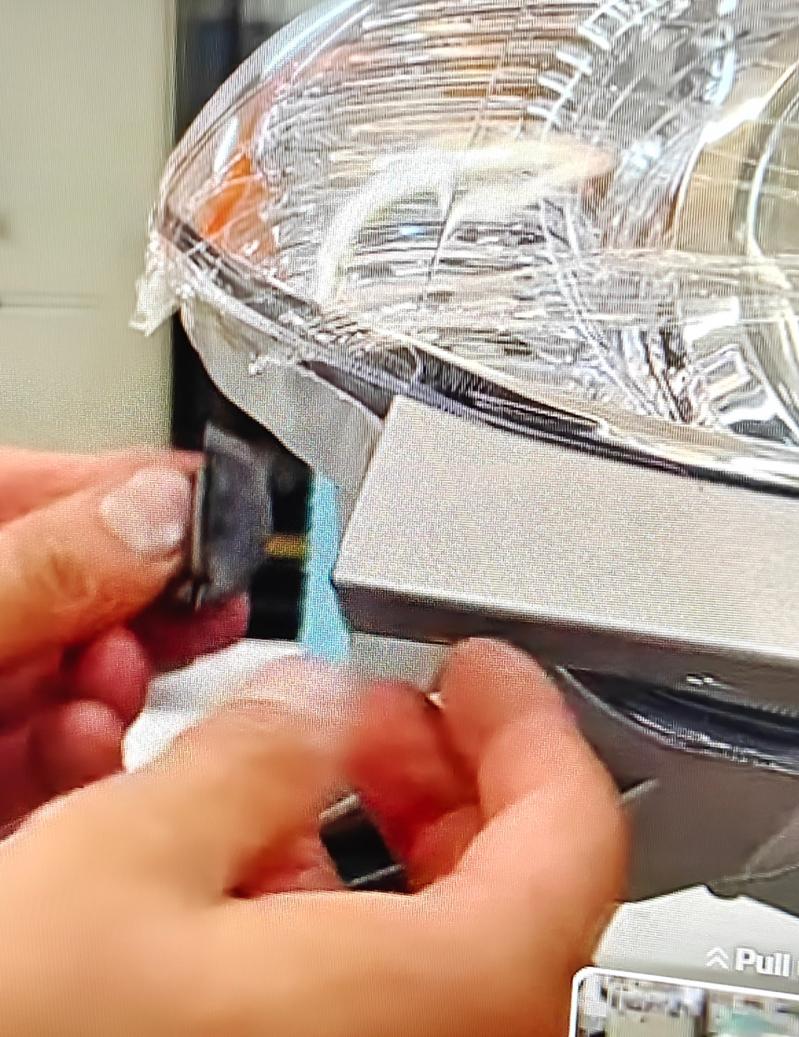

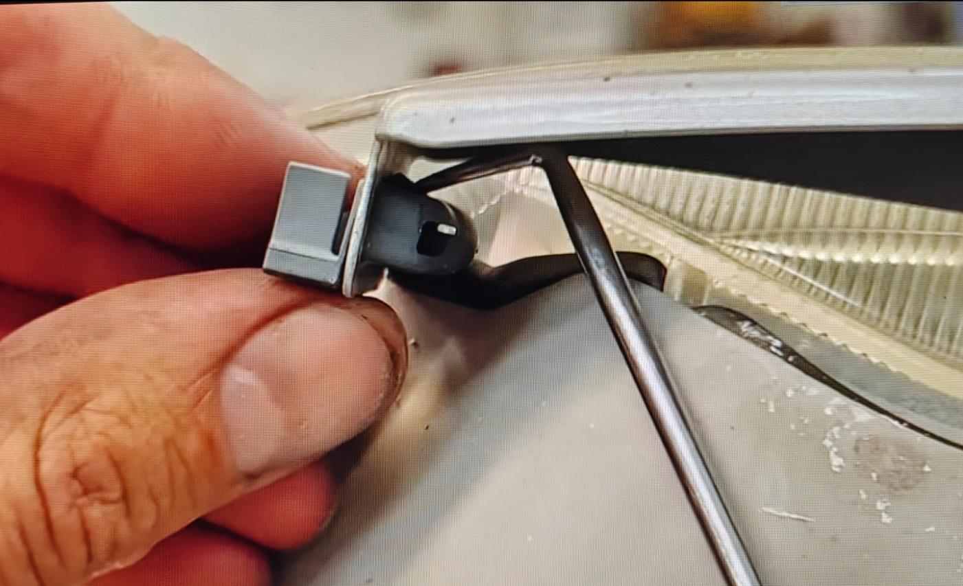

Here is the part, with part numbers. I did the 06-09 headlight conversion on my 05 4R and bought the headlights from Toyota and needed this piece too. You’re welcome.
53935-35020 Protector. I tried to upload the pic of invoice but I get an upload failure. I believe the part is interchangeable (passenger, driver side).

Was able to get screenshots from youtube as well.
Was able to tracck it down on youtube ..a whooping 12 bucks apiece , a pretty penny for such a small piece
