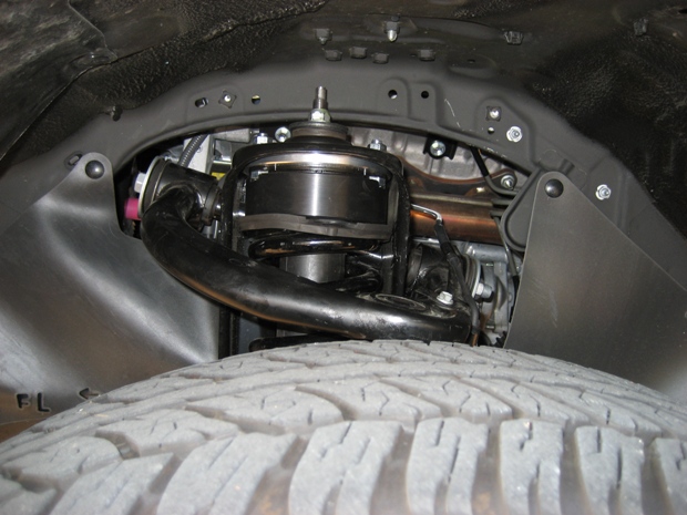

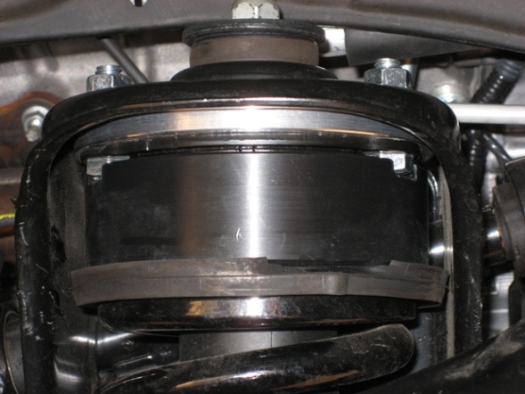

I finally have my 4runner lifted. Now, it need bigger tires. Please checkout the close shot of the spacer picture. Is that correct? I saw other members have a different spacer than mine.
BTW, it is Cornfed 3" spacer lift. I don't know the "cut" to keep the bolt in place are from the factory or the installer cut them.

Hey twin, nice lift! I don't know why your front is not made up of billet alluminum. maybe you should contact Jason Burtman of Burtman industries or David of Cornfed suspension for some answers. btw what color are your rear spacers? mine are white plastic polymer. all in all nice looking T4r!
I contacted Jason and David. They are sending the alluminum ones to me. It was a mistake by Cornfed (David). The service by Jason and David are great.
