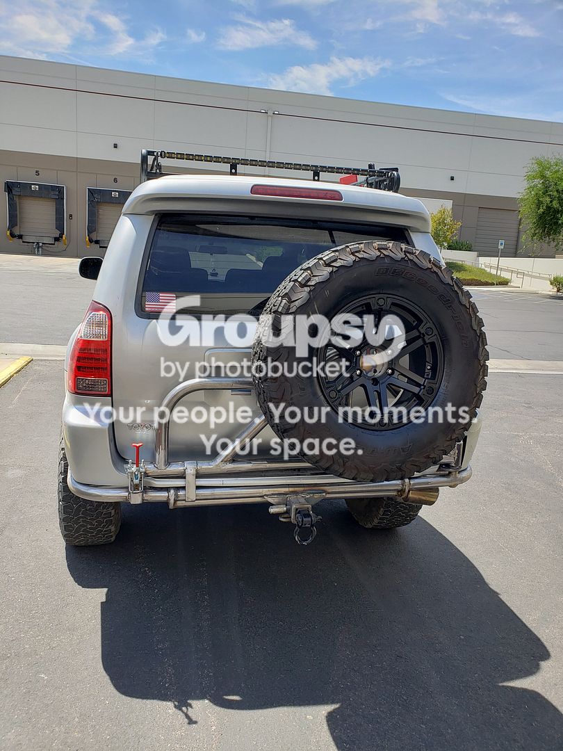

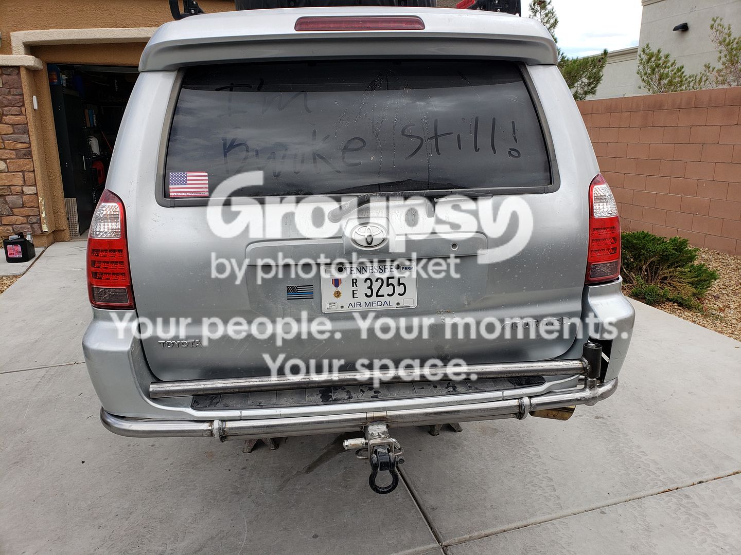

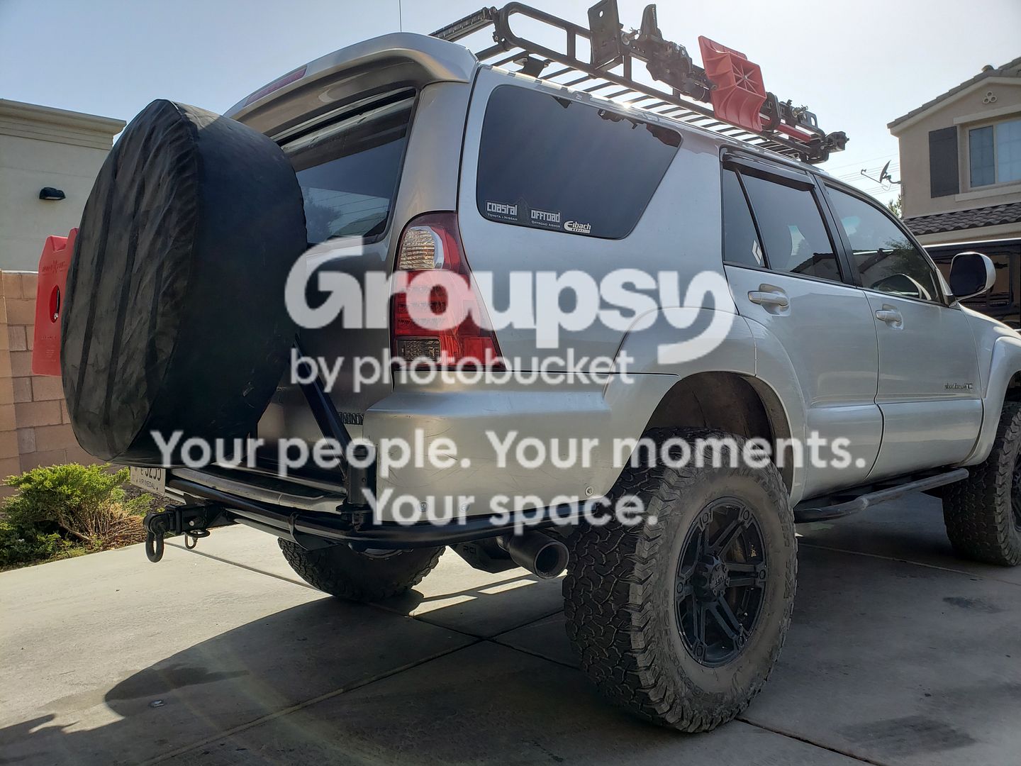

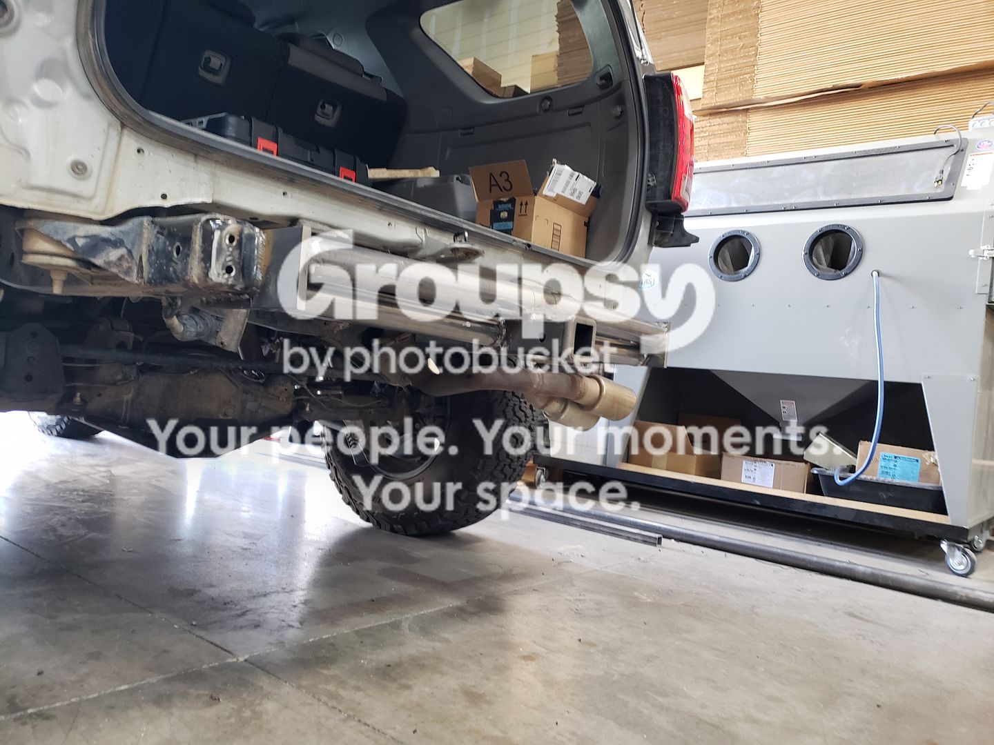

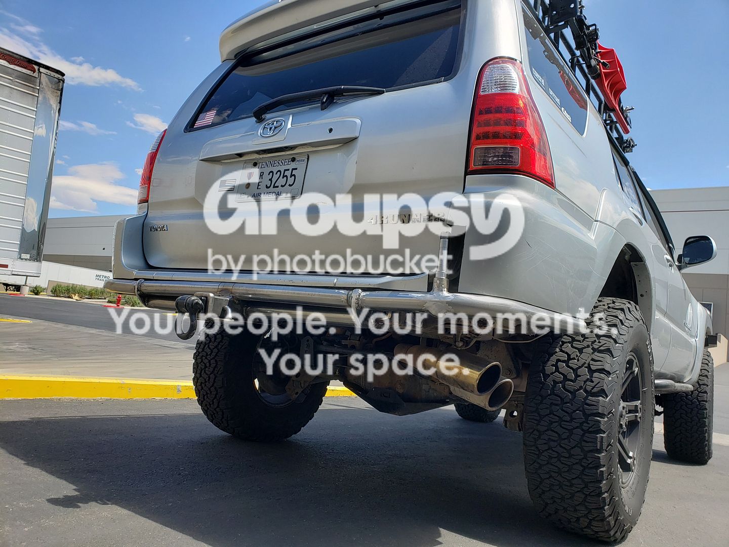

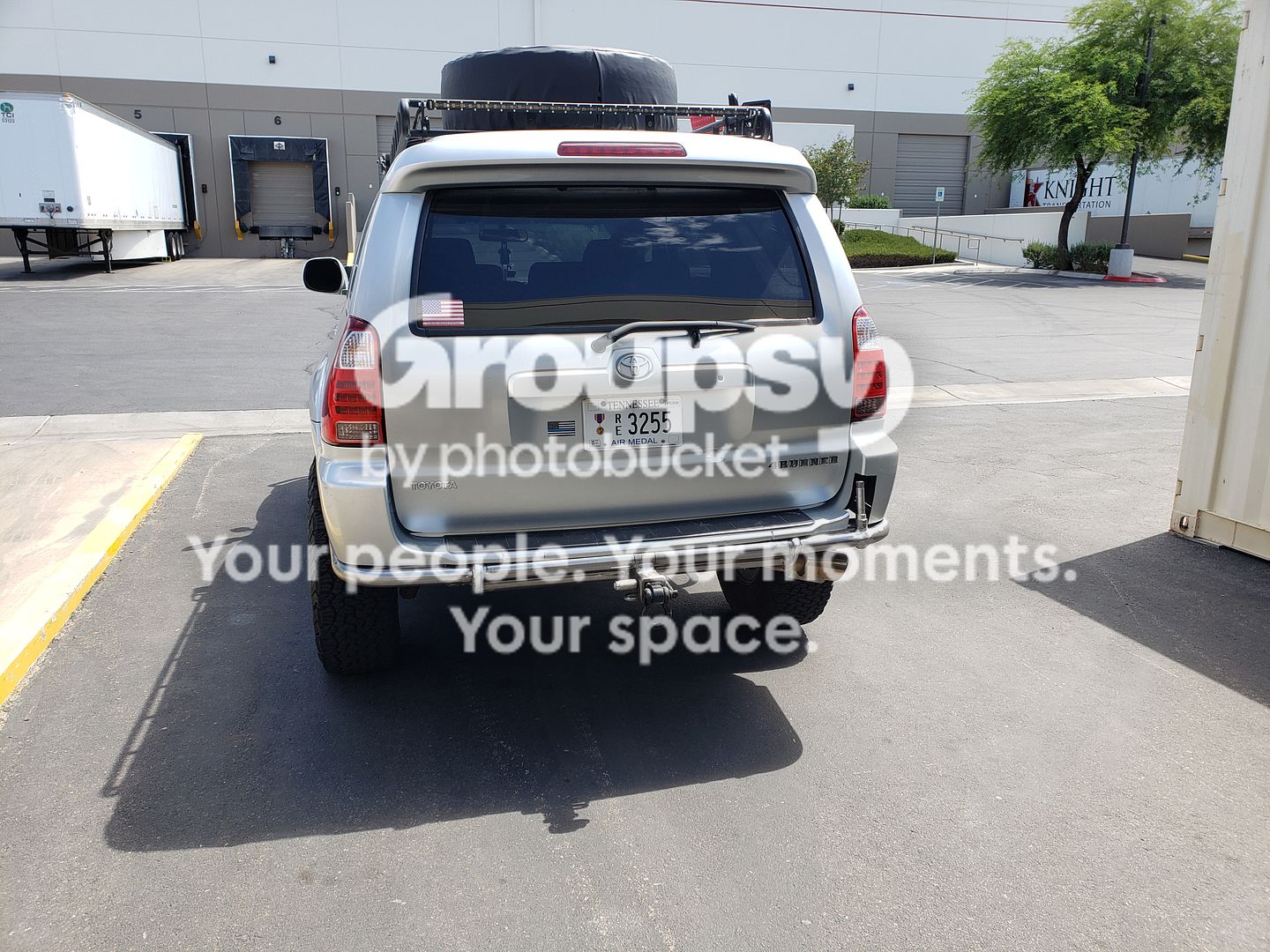

I'm really excited to see how this wraps up. I was thinking something along this line to keep the body lines tighter. I don't like how squated all the plate bumpers are on the back of the 4th/5th gens. They're so low and looks like it'll get held up on everything. This looks so high and tight!

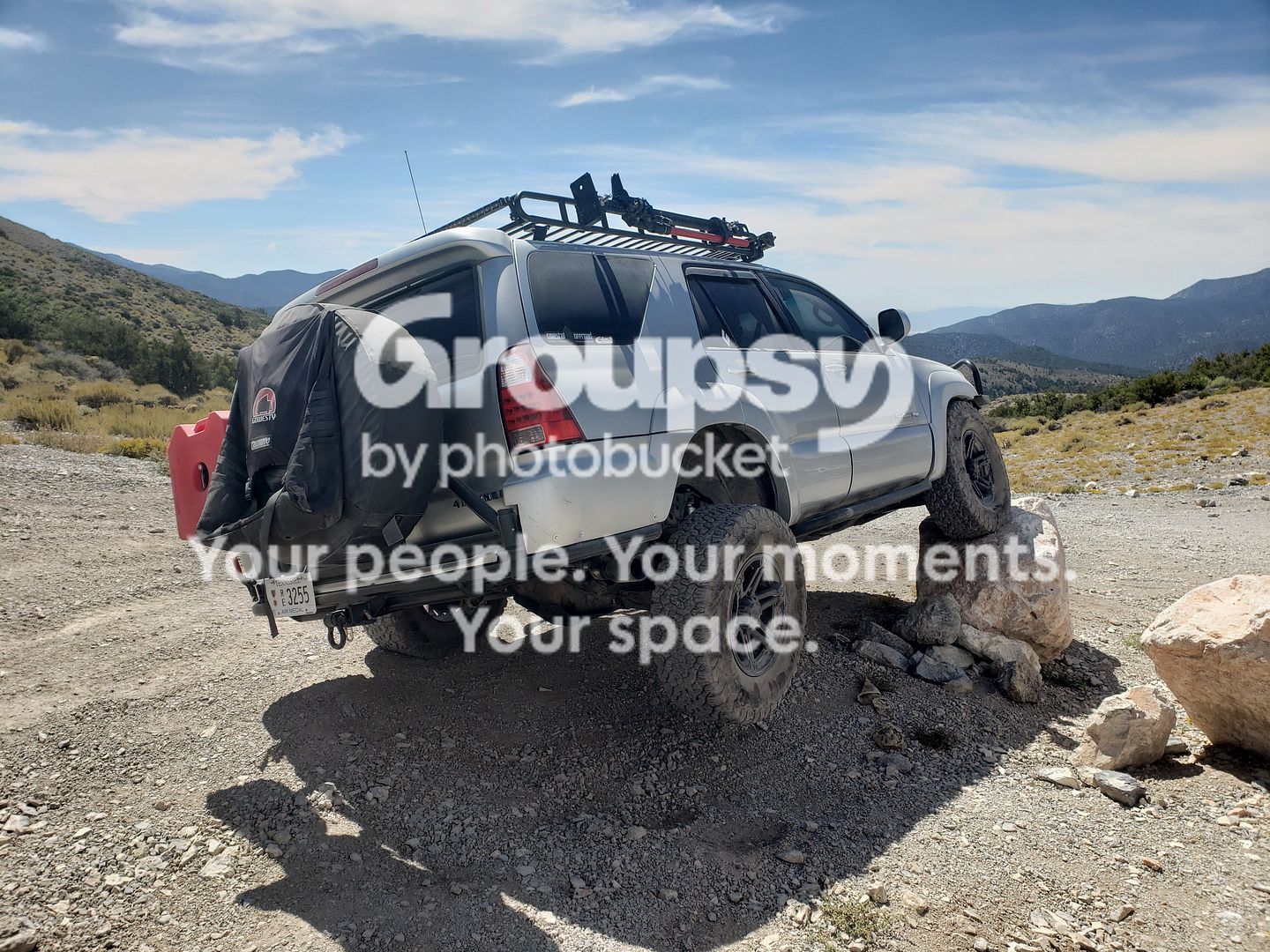

Picture update

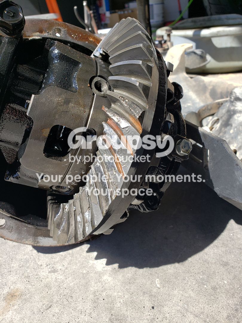

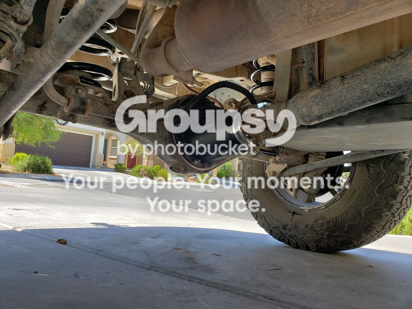

Rear 3.88s and LSD are installed. Freshened up bearings and seals.

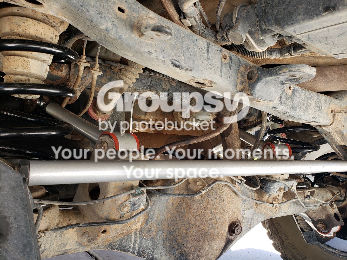

OME 2896 rear springs provided some more lift

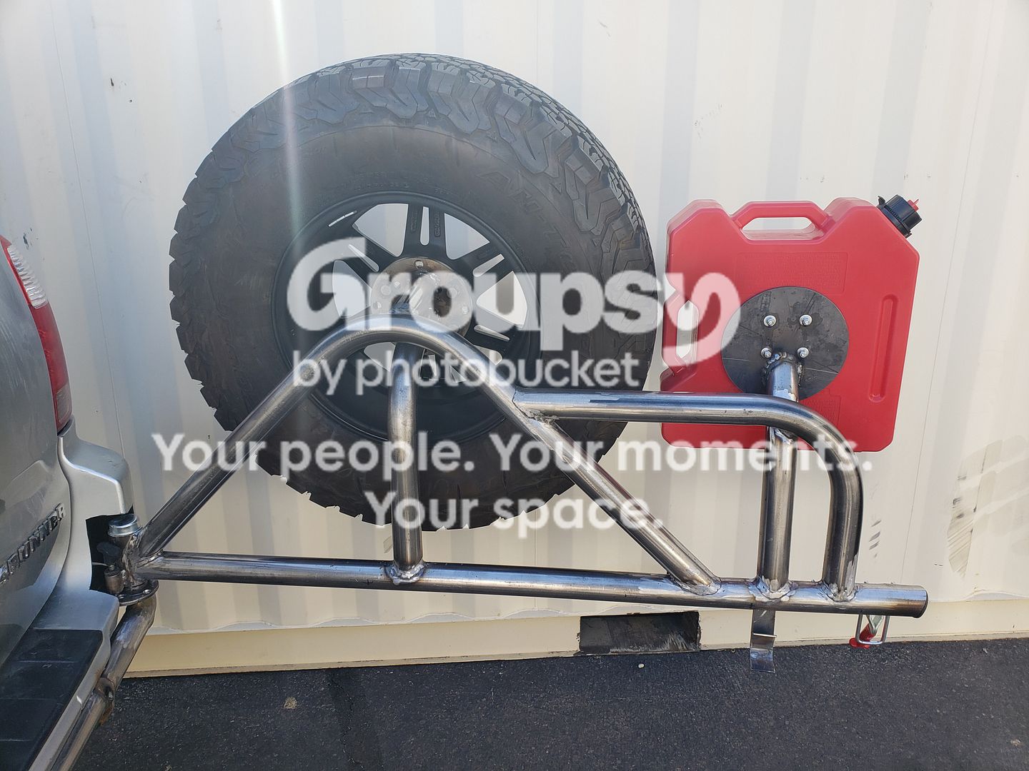

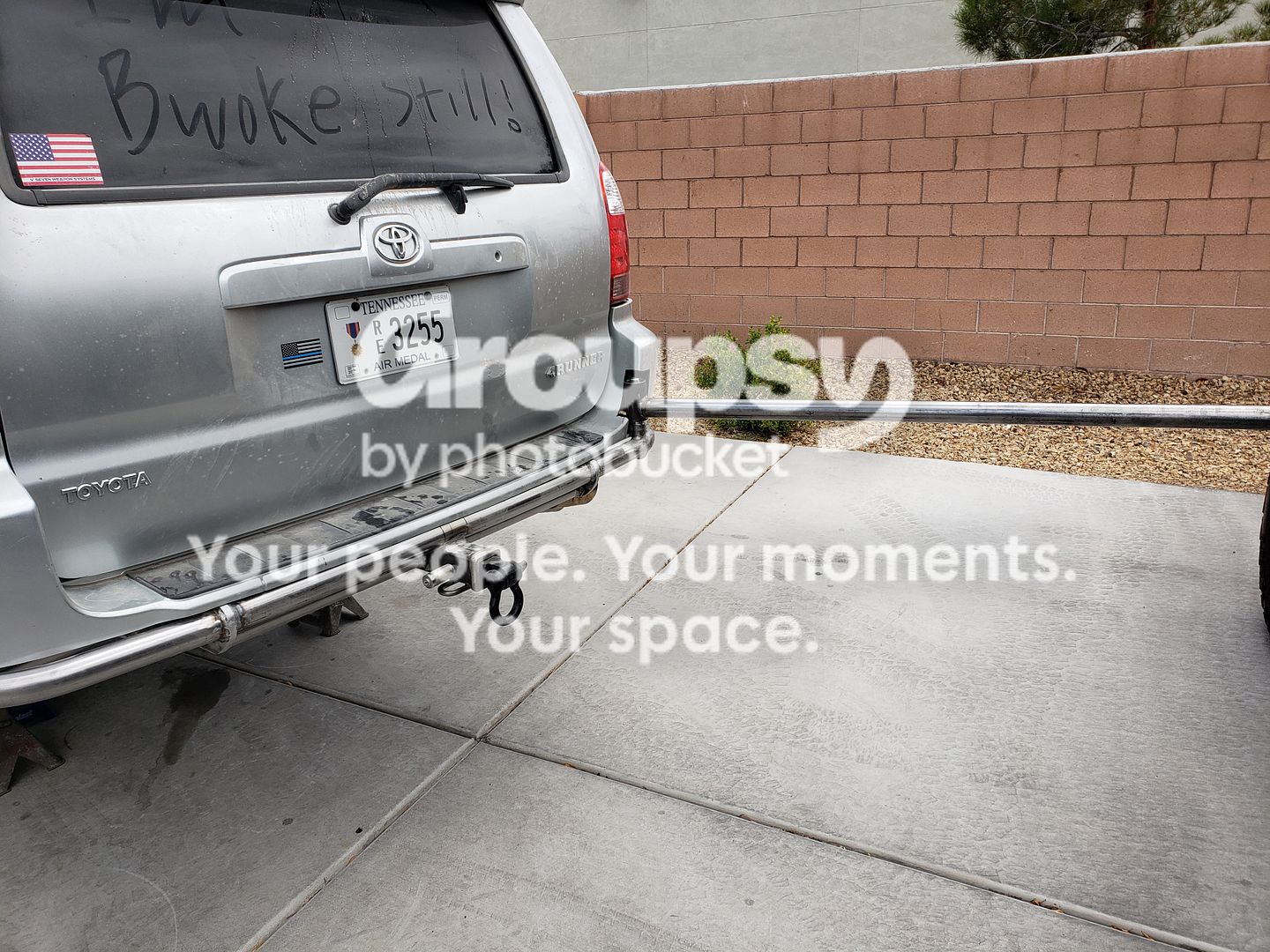

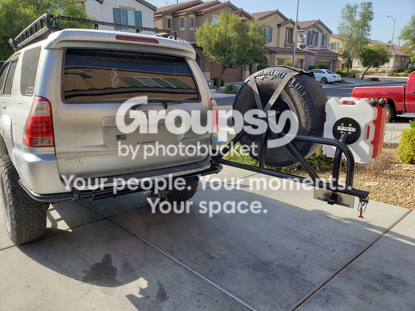

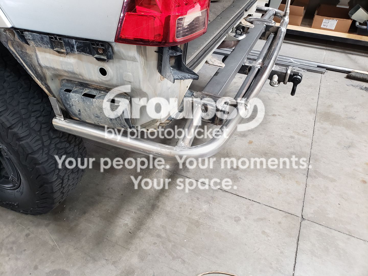

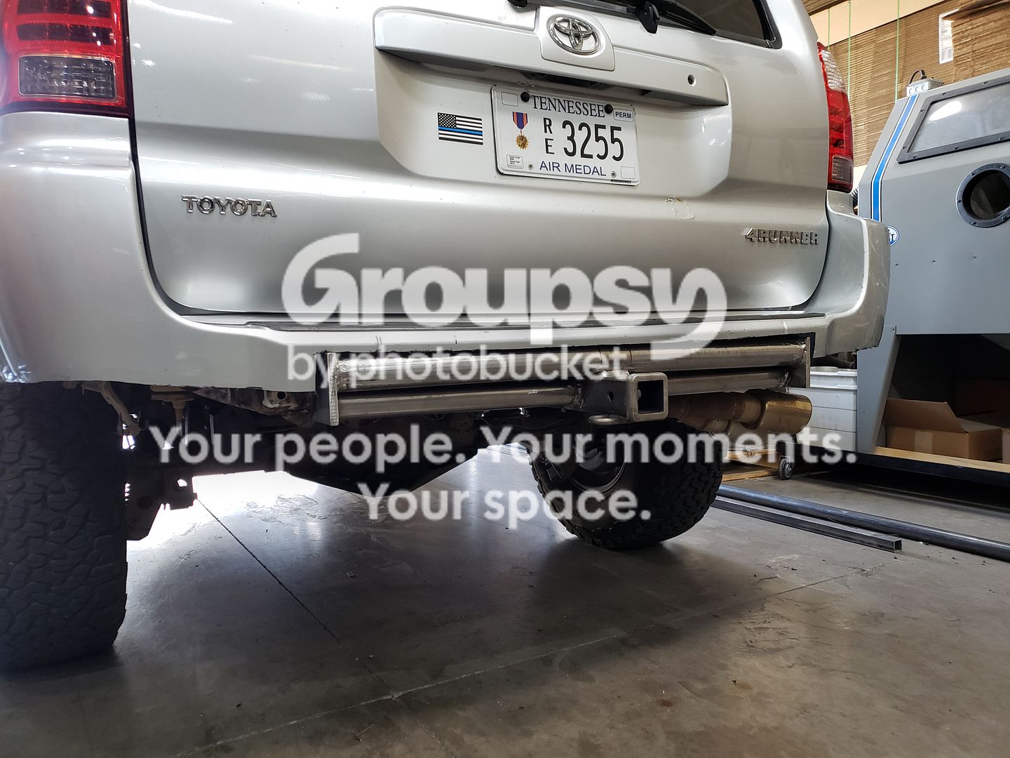

Mock up of rear swing out bar
4.88s not 3.88s are installed.

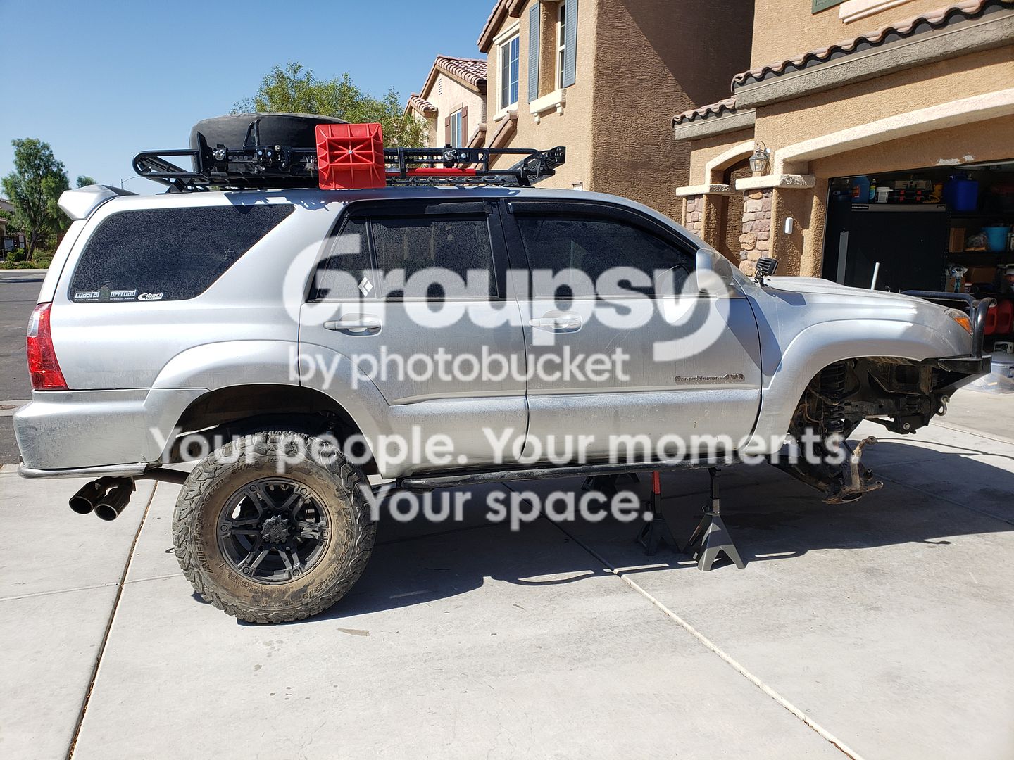

Just got the whole thing back together and did initial break in.

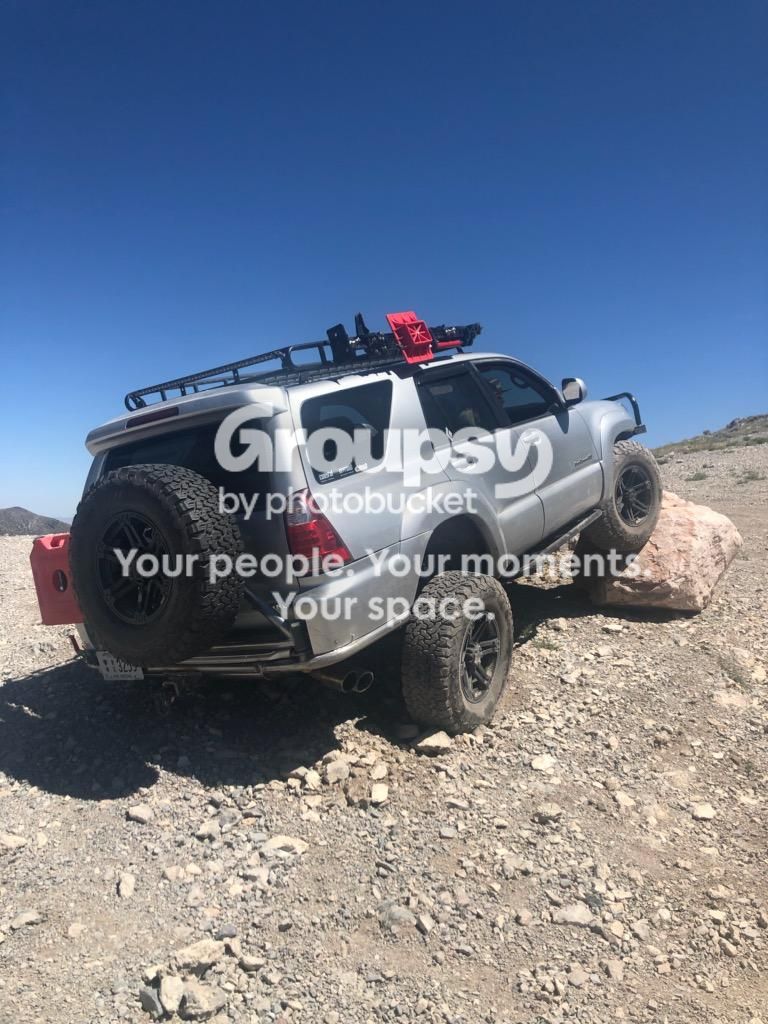

I'm planning to build a similar rear bumper to yours. Seeing yours being built in stages helped put a lot of things into perspective and help me decide on my design. Thanks! Your rig is coming nicely :thumb3:
Thanks. Definitely some things I could of done different. But I'm happy with it. It does what its suppose to
sorry if i didnt see above but what kind of a rear bumper is that? I have 285 70 17 tires on my 4runner and want to carry a spare.
