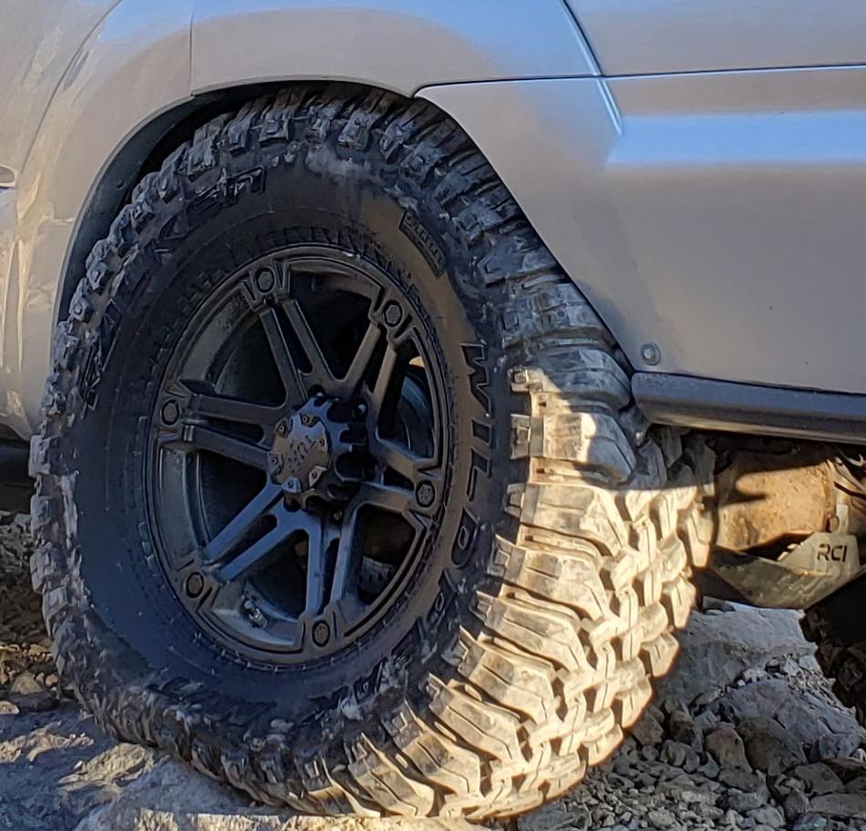

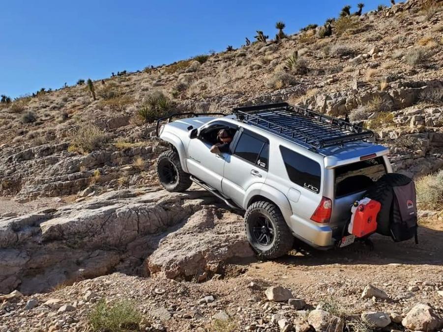

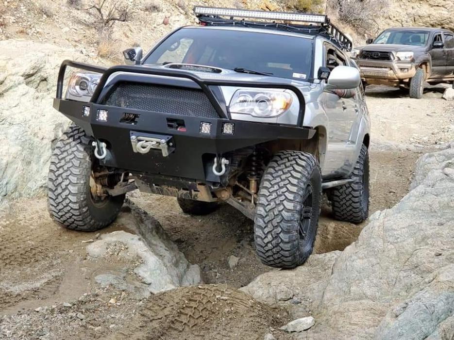

35's! No body lift needed.. I don't really rub either.

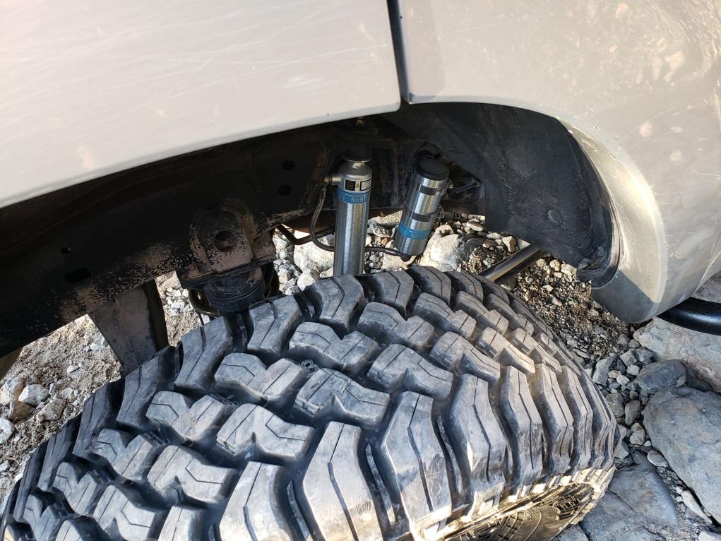

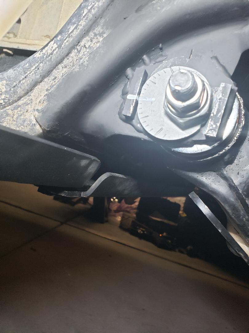

I installed wheelers front preload spacers in front shocks. Added daystar 1.5 lift spacers in back. Wheelers offroad superbumps F/R. Adjusted my front UCA to move wheels forward. Adjusted rear links to move axle back a bit. Put Falken Wildpeak MT's, 35x12.50x17

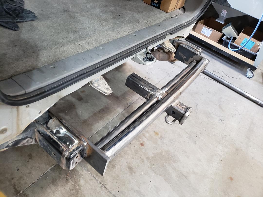

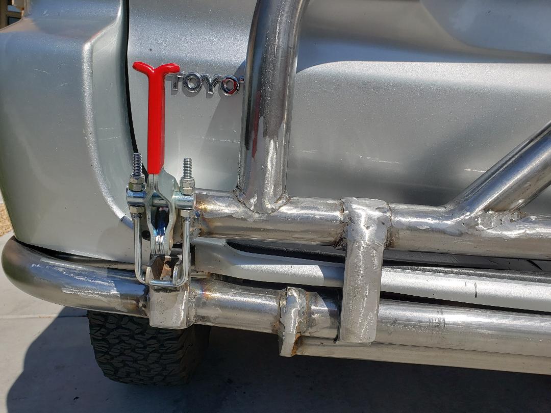

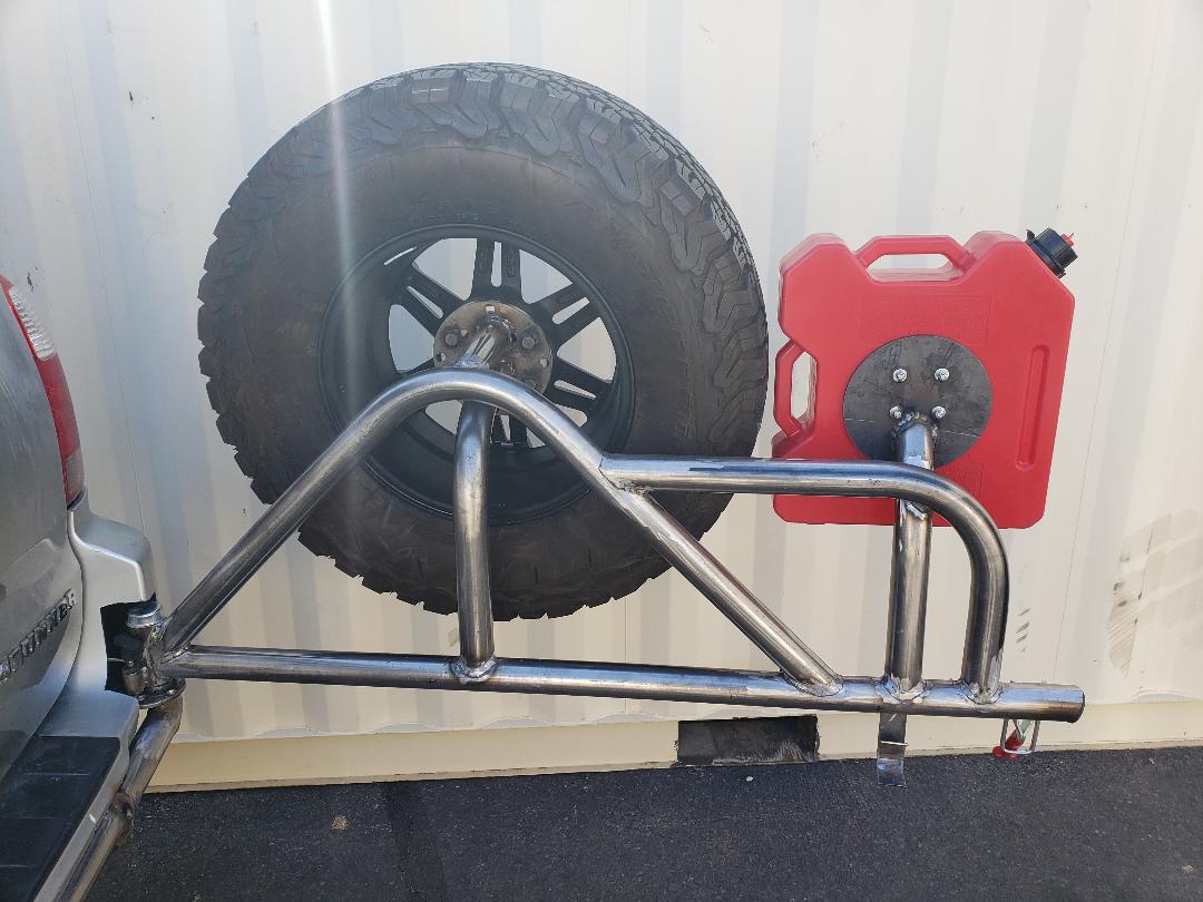

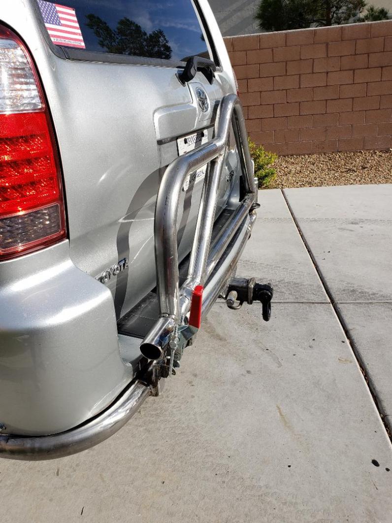

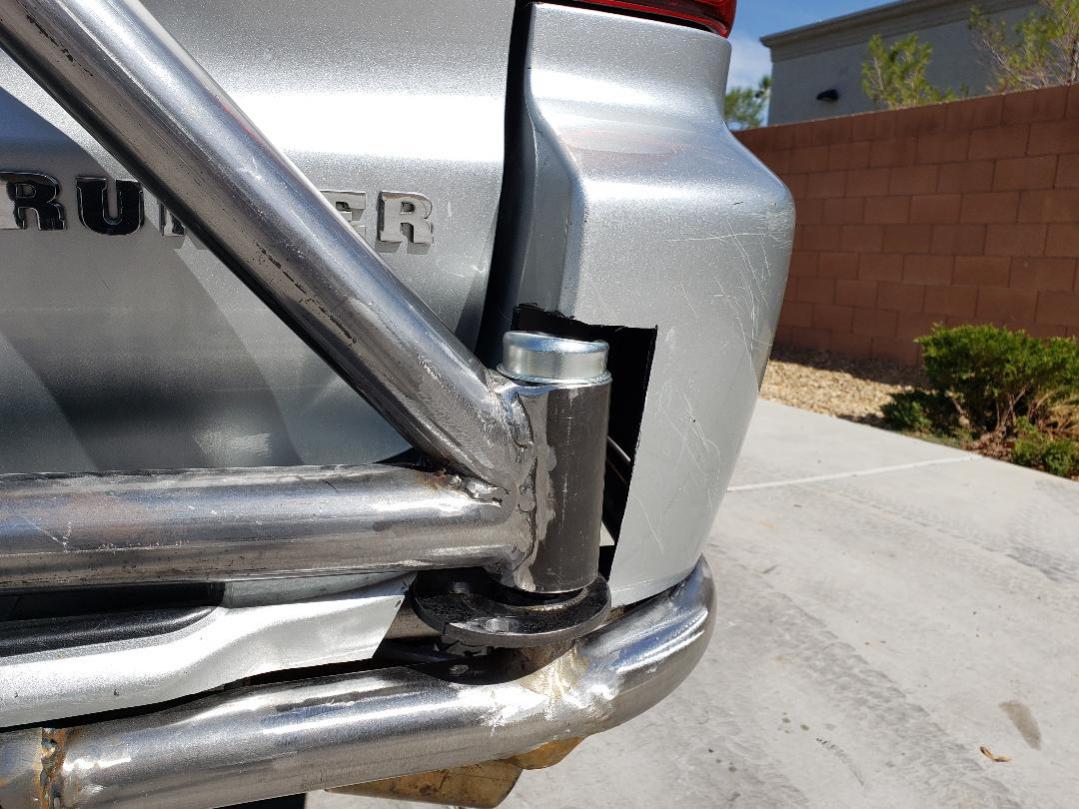

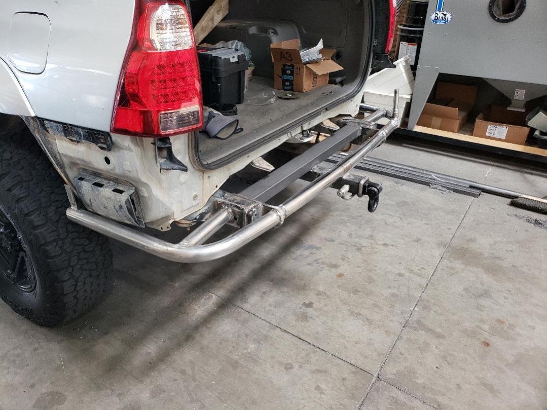

Trying to see what you did for the rear bumper. I have Costal bumpers, front and rear, on my 99 Tacoma and am probably going the same route with the 4Runner.
35s w/ no Body lift

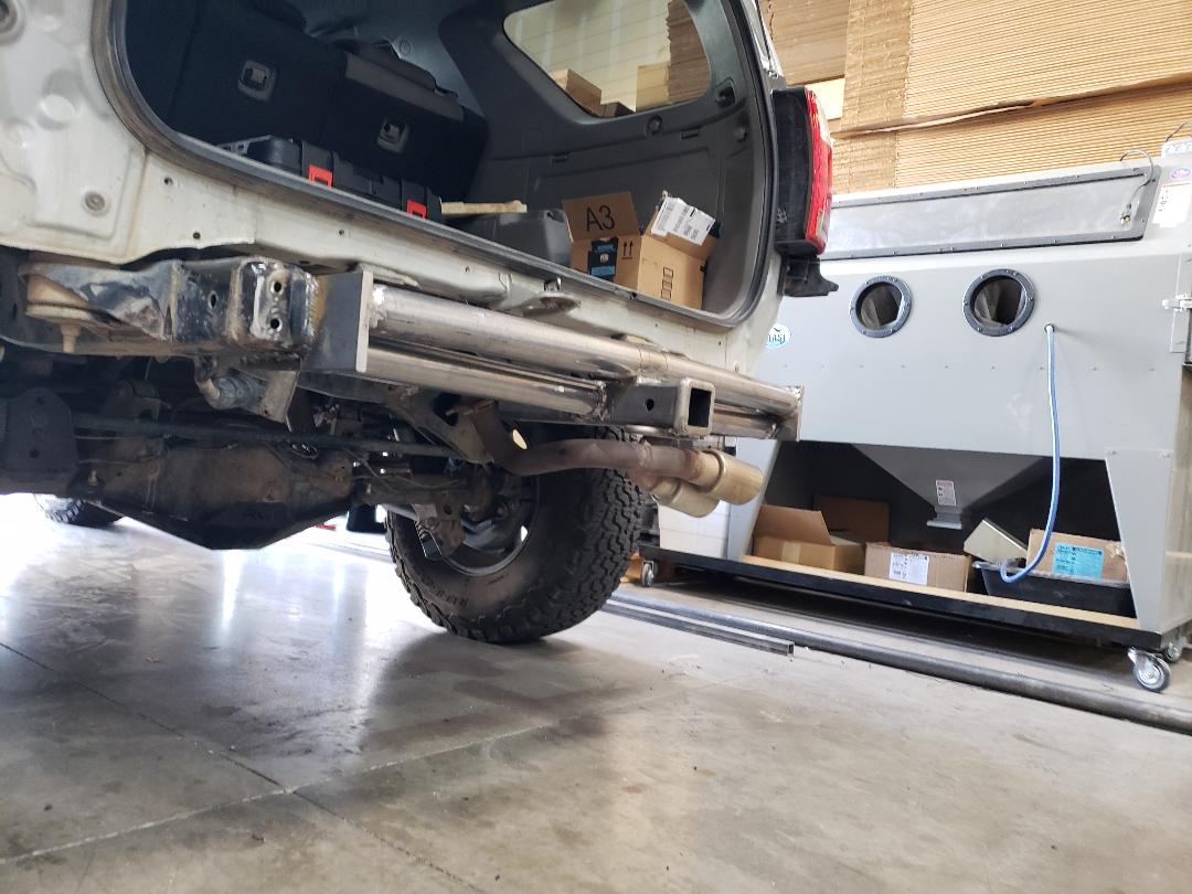

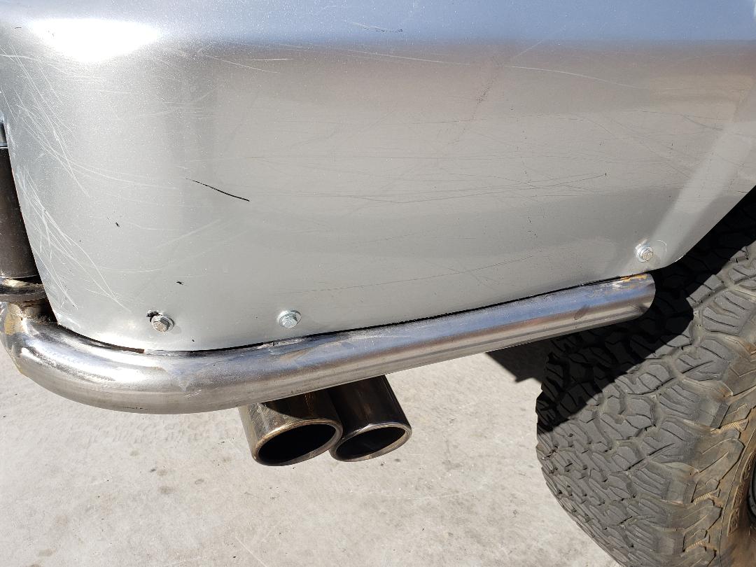

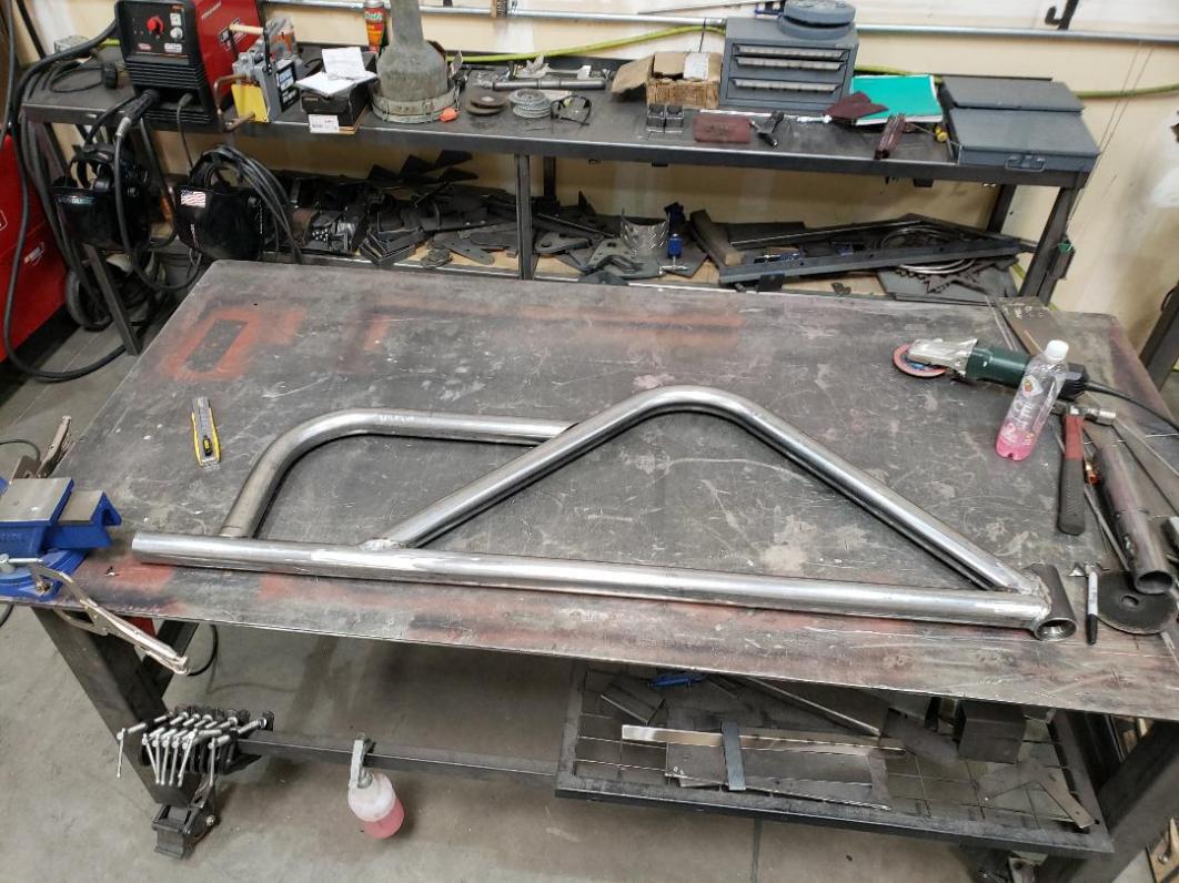

fab shots on rear bumper

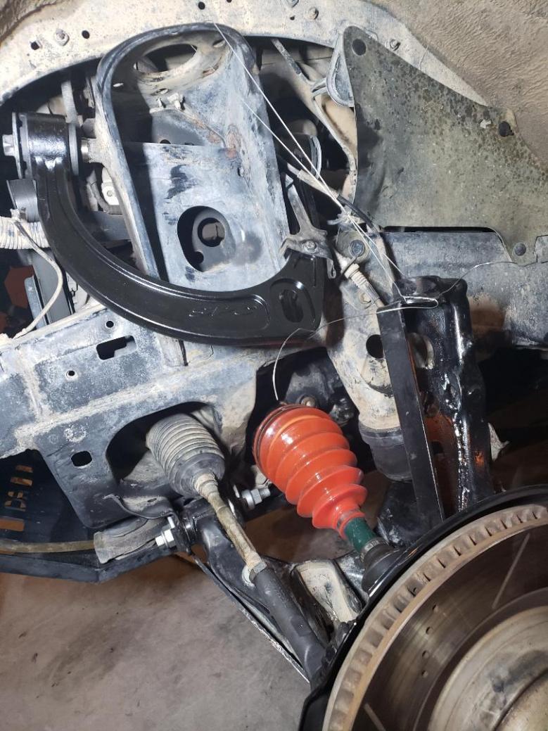

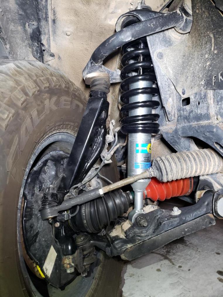

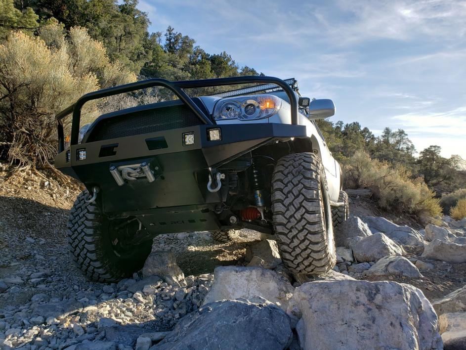

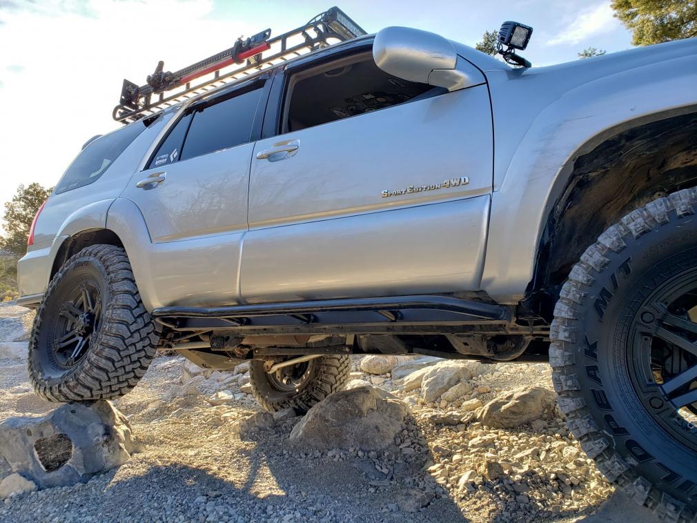

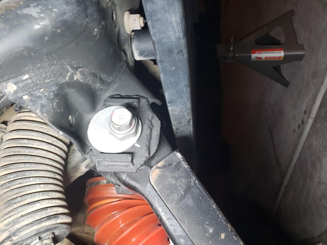

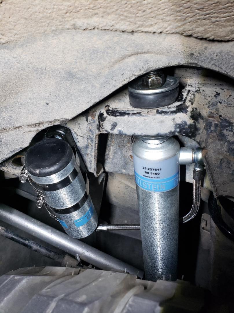

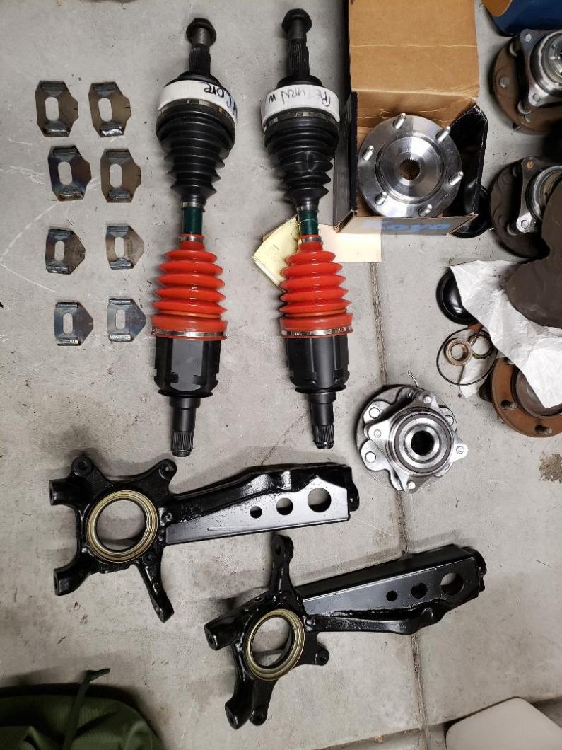

Parts going:
- Bilstein 6112 w/ 650Lbs springs (installed)
- Bilstein 5160 rear shocks (installed)
- Icon rear 3.0 overland springs (installed)
- Fresh factory LCA cam bolts (installed)
- Whiteline LCA bushings (installed)
- Total chaos spindle gussets (installed)
- Poly Performance Cam tabs (installed)
- CVJ cv axles (installed)
- Koyo front wheel bearing/ hub assy (installed)
- SPC new style UCA (installed)
Bunch of parts went on

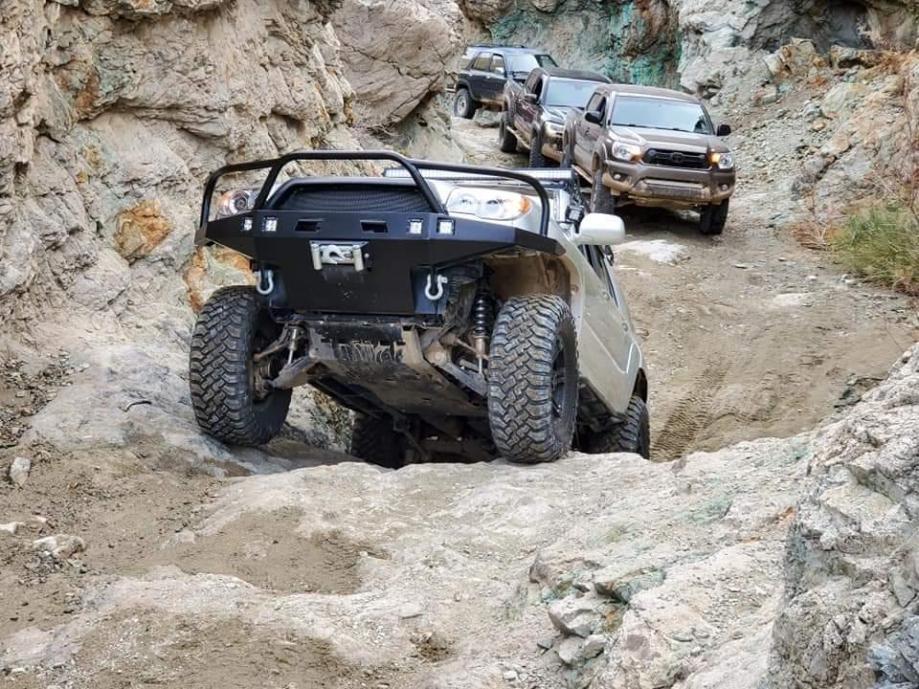

Some recent shots

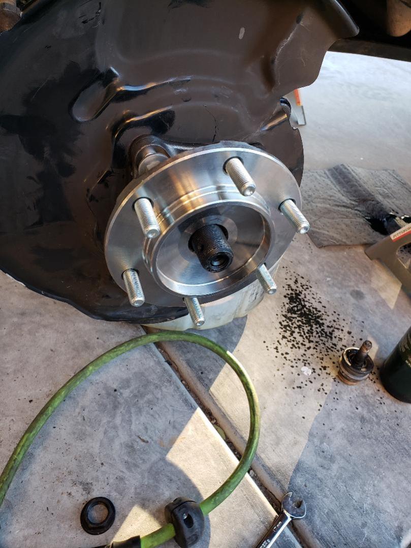

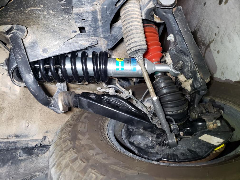

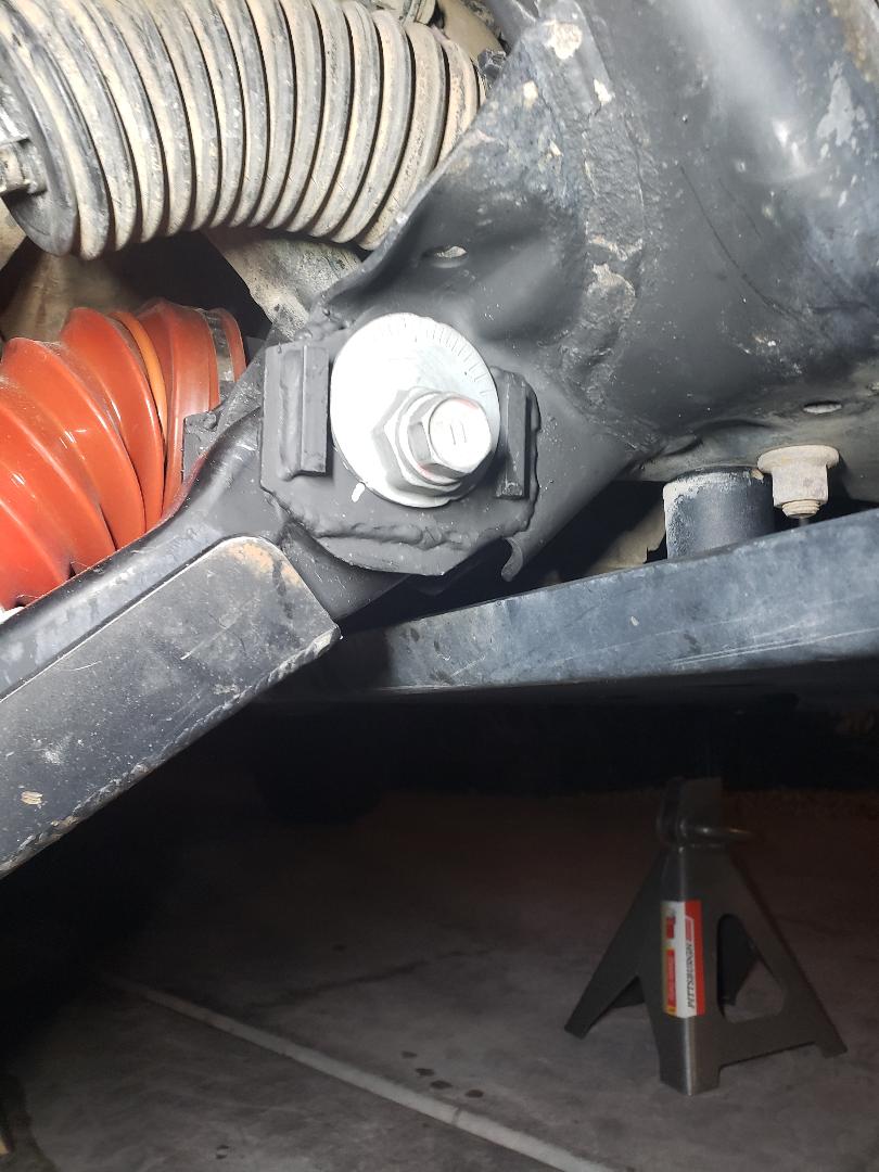

Parts going:
- New CV seals
- New rear pinion seal
- Rad rubber fender liners
- New greaseable LBJ
- New greaseable Tie rods
- Changed Diffs and trans fluid
- Changed oil and coolant
