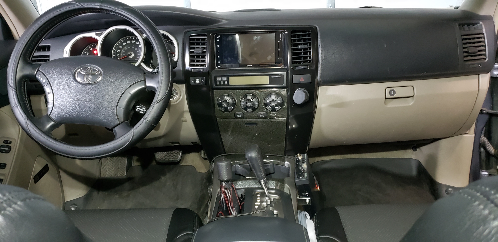

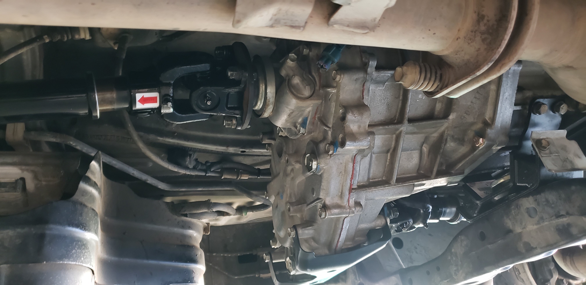

That's because it actually is. Probably less work than swapping the trans and tcase for used shit you don't know the history of and have no guarantees the replacement tcase will work or last very long. Manual FJ tcase has no electronics that will fail.
The tcase is a direct bolt in, just need to cut a hole for the shifter, modify or have the shifter modified so it comes out where the ashtray/cig lighter is, measure for the driveshafts lengths and have a shop make or modify them for you and that's it. You do not have to change out the front differential (a certain shop in CA might tell you otherwise but they are full of shit) or really do anything else.
I've got over 4k miles on my swap now with zero issues, both on and off road.

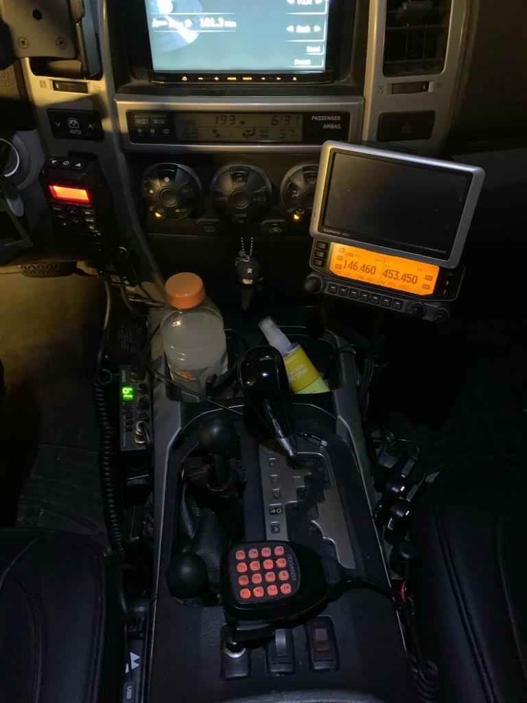

You also can go the FJ t case route but add twin sticks which give you more advantage off road cause you have 2low as well.
