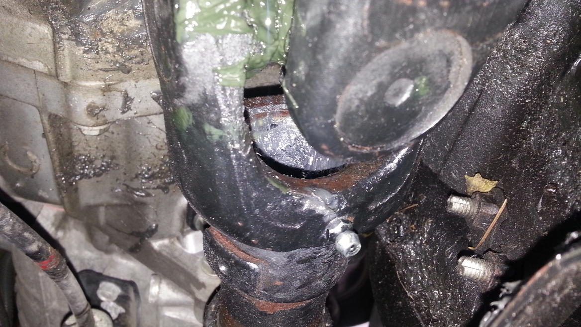

Hey guys, so I've been greasing my zerks for about a year now every since I found this thread. However I went to give them a few squirts today and noticed the grease wasn't going in right on the front slip yoke. After looking at it closer it appears the seal on the end of the slip yoke is gone. All I can think is that it must have blown off under pressure. Is that what it looks like to you guys? It certainly isn't able to hold grease in there so I can't keep it lubed at all like this...
