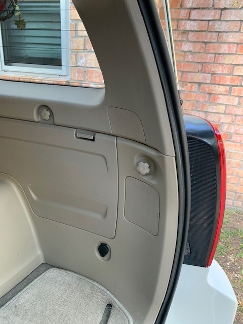

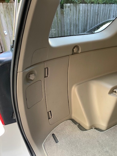

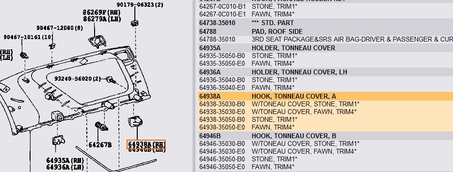

Hello, I recently purchased a 08 SR5 that did not come with the rear retractable cover but it also does not have the hooks near the rear door. I've searched several threads/posts but did not see the actual part numbers for the rear hooks.
The parts guy at the dealer had no idea what I was referring too even with the photos, so I thought I would ask here. I searched google as well but cannot make out on their diagrams the actual part number I need. My interior is tan. Any assistance for a part number is appreciated. The first 2 photos are of my 4Runner and the 3rd is what I found on google that I believe is the one needed.
Thanks in advance.

I have been searching some of the diagrams but couldn't find anything specifically. I did come across this old thread about them though
cargo cover brackets????

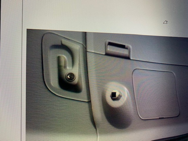

I went out and pulled mine off my 05 SR5 to see if it was stamped on them anywhere, and it was!
Looks like the LH is 64946-35030 and the RH is 64938-35030. The pictures should be linked to imgur too if you would like to see bigger.
For anyone that stumbles on here in the future, the best way to safely remove the caps was with a small pick in the little pry tab.
It amazes me just how bad some parts departments are. This took me less than 60 seconds to find.
The numbers provided by y=mx are correct, but there's a color code too
64946-35030-E0
64938-35030-E0

For future part finding, where did you go to find the part numbers?
I searched Google, saw a similar diagram but could not figure out which was the correct part. I am clearly not good at reading the diagrams. I also did not see this specific diagram showing the color code options.
After receiving the part numbers from y=mx+b, I called two dealers here in Houston and gave them the part number, my VIN # and my interior color code number FA42. Both dealers told me the part number only showed B0 and along with it it showed the several colors (stone, Fawn, Taupe, etc..). I asked how I will I know I am getting the correct color and neither could answer.
Giving up on the dealer, I decided to order from a the McGeorge Toyota site which offered a good price for both. I used the part number and only the number with B0 popped up and it read, color stone. My interior looks more like a fawn/taupe. I then received an email from McGeorge Toyota that the part for my 4Runner in the color I need(tan) is no longer available. Oh well, time to find a salvage yard. If anyone from Houston knows a good Toyota Salvage yard, let me know
