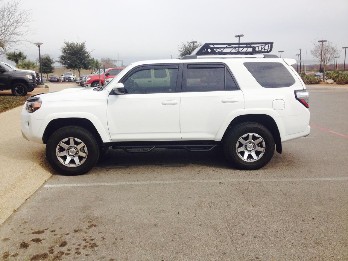

Bilsteins set at 1.75" front and no rear lift. Body was leveled, frame had a slight reverse rake.
