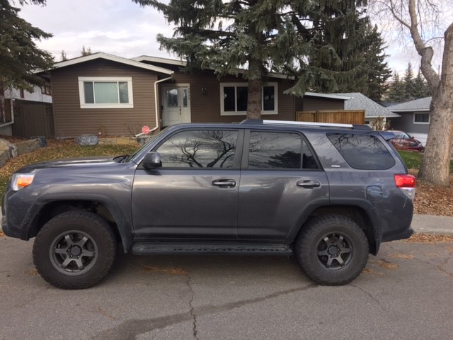

I have just front Bilsteins, set at the third notch 1.75" I think?. The body is perfectly level, meaning the space the top of the fender and top of the tire is exactly the same from front to back. Running board has a "slight" reverse rake. Apart front the look, the ride is 100 times better. The truck doesn't dive forward when braking. Another improvement is turns and cover-leafs getting on/off highways. The front of the truck stays almost perfectly level, as opposed to swaying and diving to the outside of the turn. Even things like speedbumps and rough roads in general (New York potholes in the winter) were drastically improved as well.
I had 5100's on my 2012 4runner SR5. I liked them. I just did the shocks, no springs. I had the front on either the second or third perch. Gave it a nice level look.
I never really noticed much nose dive on it, but the breaks on that truck were supper soft, so you had to really stomp on it.
