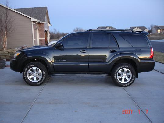

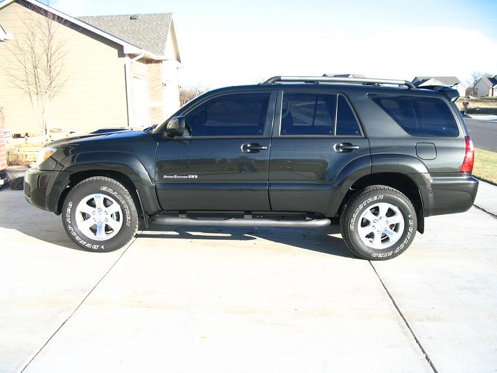

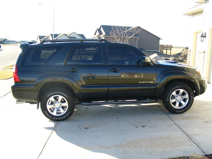

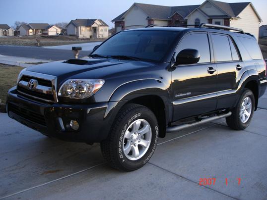

I purchased a set of 1/2" spacers from Jason Burtman and have installed them on the front only. 1/2" spacers actually lift the vehicle 1". It's difficult to explain how it works but there are multiple threads on here that can explain better then I. Ultimately, I was wanting to level out my T4R, similar to how the generation 3's come stock. I took some measurements before having the spacers installed and then again after it got back from the shop.
The biggest difference is that adding the spacers gave me about 1 1/4" more ground clearence under the front bumper. I measured the drivers side and passenger side wheel well, from the rubber to the fender, and gained nearly 1" exactly on each side. Before installing the spacers, I measured the tube steps on each side and noted that there was about a 1" difference from front to back. The front obviously being lower. After installing the spacers, the gap from front to back on each side went down to just under 1/2".
Driving the vehicle feels almost exactly the same. You can tell that it's a little bit taller when you get into it and it also seems bigger when you drive it.
Ultimately, I love the way it looks! It's amazing how a 1" lift in the front can make it look so much better. The nose still points down slightly so I wonder if adding a 1 1/2" lift would have made it exactly level. That would have meant 3/4" spacers. Either way, I like it now and would highly recommend it to anybody wanting to slightly enhance their stock 4Runner. Jason Burtmans product and service was excellent just like everyone had told me it would be.
Feel free to let me know if anyone has any questions and I'll try and get back to you as soon as I can.

WOW and that is with 1/2" spacers. Sounds like 1" would be to much if your not doing anything to the back or maybe not to much but would be totally level , I prefer what you did.
I think it looks perfect !! Did you get an alignment ?
Do you think you will have to adjust headlights ?
Now as soon as those bigger tire go on .....:D by the way the size you need is 265/70/17 ..... lol
How much for the install ?
Yeah, I love the way it looks. The photos don't really do it justice. It's amazing how much cockier it looks now. It's like having a new vehicle all over again.
Yeah, I did get an allignment and it cost about $50. The place I had install my spacers charged me a flat $150. So, I ended up paying just over $200 after taxes.
As far as the head lights, nobody is flashing me yet so I don't think I'm going to bother adjusting them. I would like to get some new tires though and that size is what I'm aiming for. It will probalby be awhile now since I just found out that I'll be paying in this year for taxes. That sucks!
